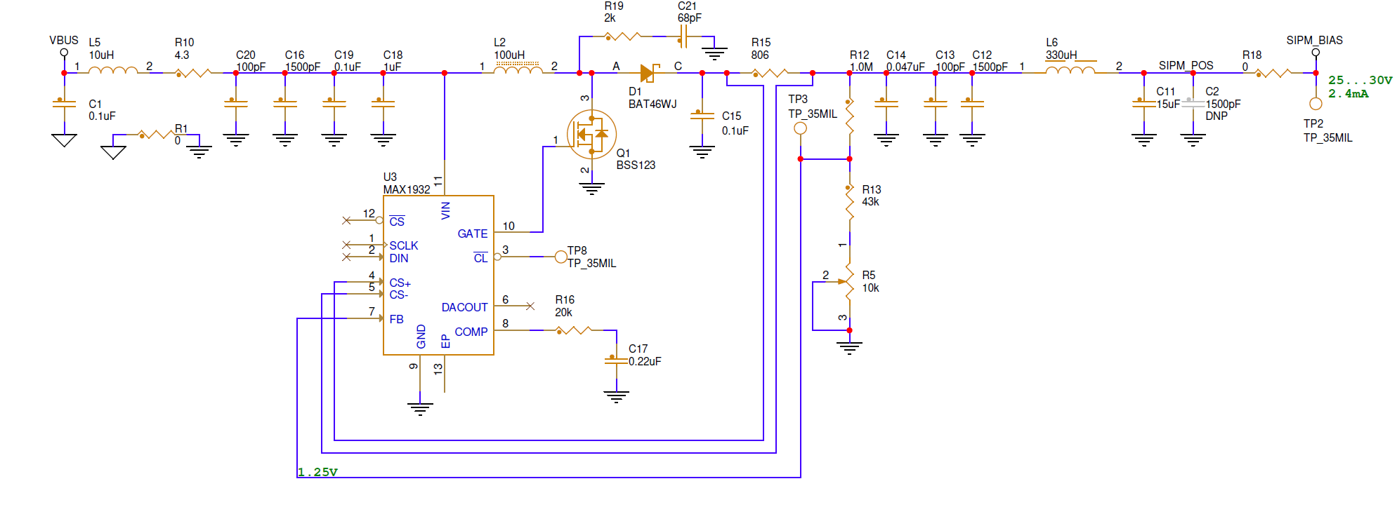

Bias Supply
The MCA provides the SiPM bias voltage onboard — 25–30V, a few mA, DAC-controlled over SPI via a MAX1932 in boost/discontinuous mode. This is what makes the system portable; no external supply needed.

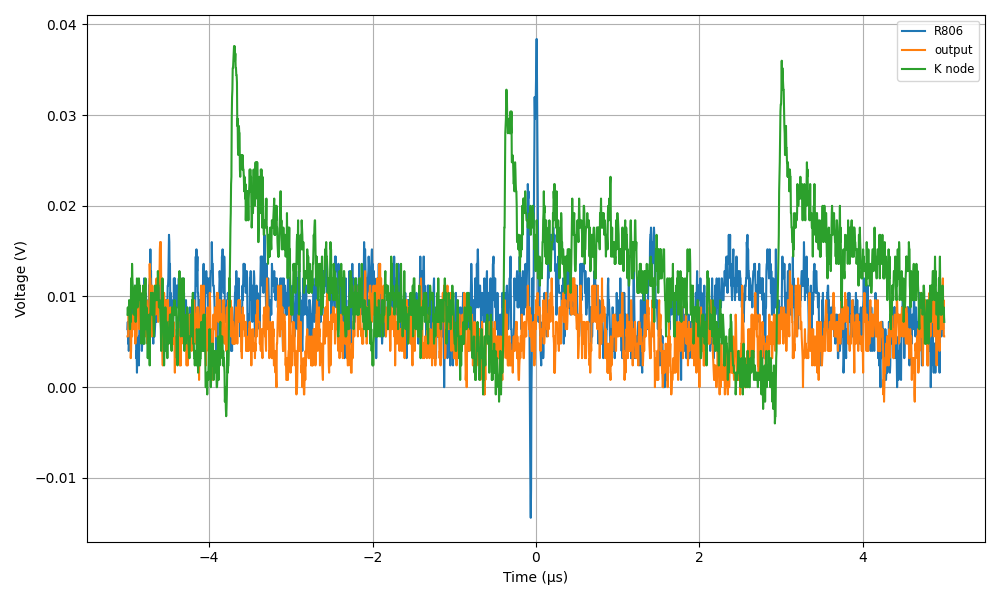

SiPM power supply output noise stages

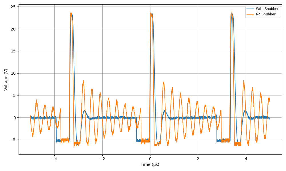

Ringing at switching node, with and without snubber

  • 1 × MAX1932 Power Management ICs / Switching Regulators and Controllers

    The GadgetSci MCA provides a clean, adjustable bias voltage for the SiPM optical sensor in the radiation detector. The detector works by converting gamma rays into visible light using a scintillator crystal — the SiPM then detects that light and converts it to an electrical pulse. Having the bias rail onboard the MCA is what makes the system portable; no external HV supply needed. The MAX1932 is purpose-built for this: boost topology, discontinuous mode, internal DAC sets output voltage over SPI. Feedback resistors configured to sweep the full 25–30V range in software.

    • Follow the application note filter. There is measurable noise on the output without the recommended extra filtering stage. Add it. Don't skip it assuming your layout is clean enough. In the pic below: Cathode node (green), Current limiter R806 node (before filter - blue) and after the filter (orange).
    • Snubber is not optional. The switch node rings without one. 2kΩ + 68pF RC from switch node to GND — design it in from the start.

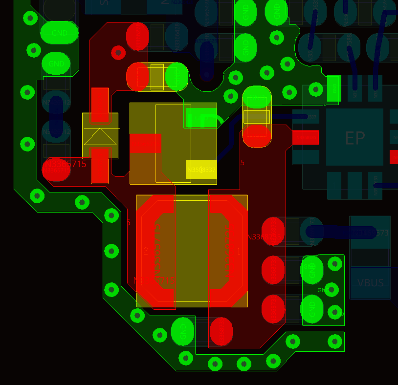

    • The package will fight you. QFN-12, 0.8mm pitch. Hand-soldering is possible but unpleasant. First prototype didn't start — most likely a solder joint on the exposed pad or feedback network pins. Reflow or hot air strongly recommended. Flux, fine tip, continuity-check every pin before powering up.

    • last but not least, in your PCB design, keep the switching loop tight. The path from input capacitor to switch to inductor to diode back to input cap should enclose minimum area. Standard switching supply layout rule but critical here — a sloppy loop radiates noise directly into the sensitive analog front end. In my case, the FET placement is not ideal — the gate drive trace ends up inside the switching loop. Fortunately it didn't affect performance in practice, but it's something to improve in a future revision.
