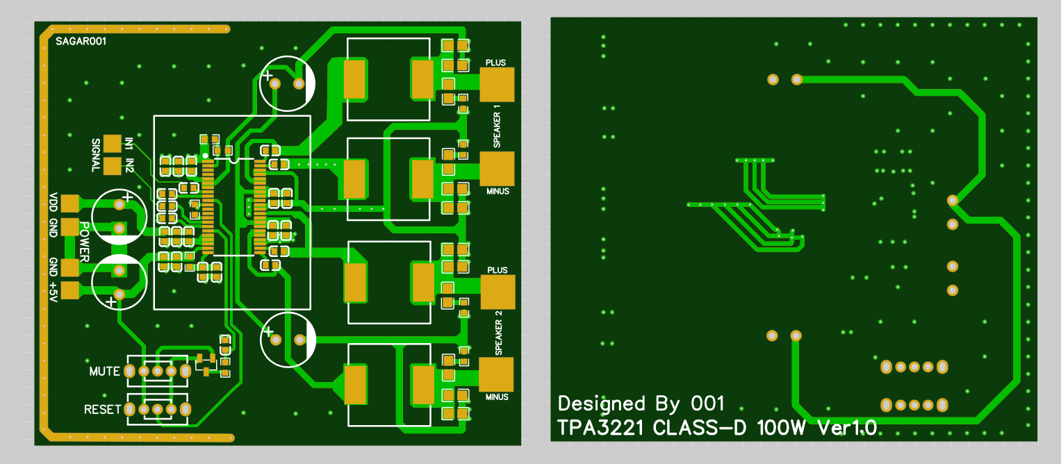

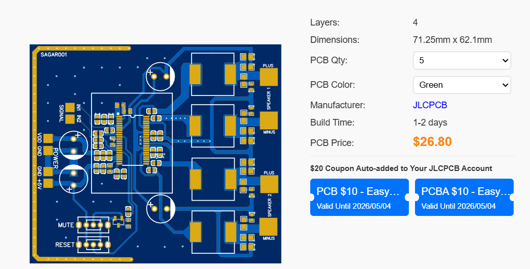

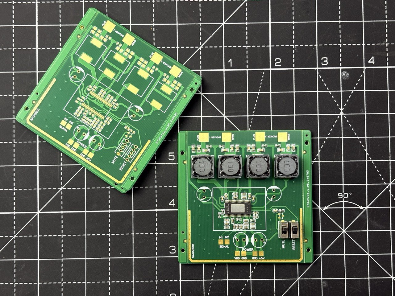

PCB Design:

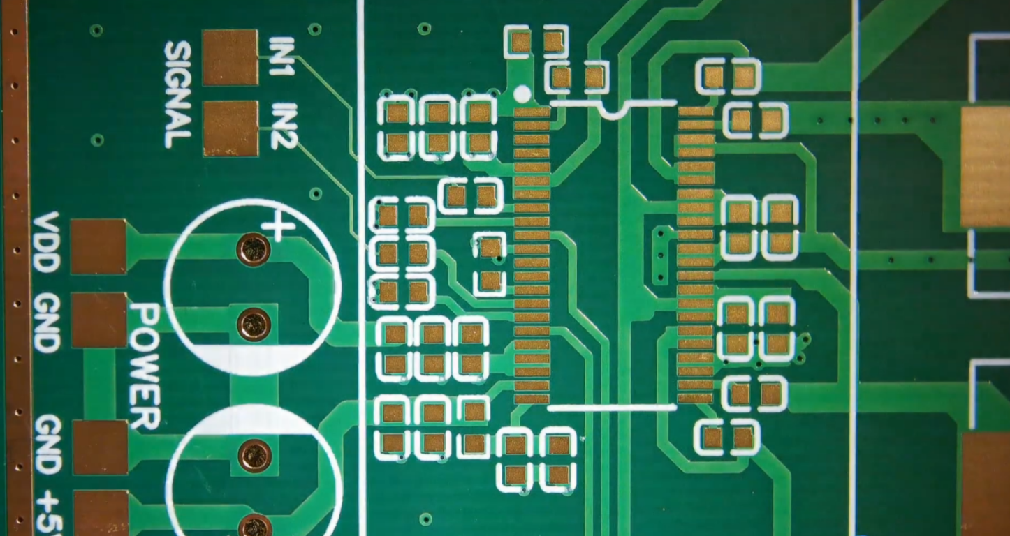

This is a 4-layer board designed in EasyEDA. The dimensions came out to 71.25mm x 62.1mm which is compact for a 100W stereo amplifier. I have used the top and bottom layer for signal and internal layer as references. Layer 2 for ground plane and layer 3 for power plane. Then pour the copper fills on the top and bottom to reduce any crosstalk. I used the services from JLCPCB in order to build this board, and I am amazed by the assembly services the board came to me is perfect and ready to use, You can try JLCPCB for your projects.
The TPA3221 sits at the center of the board. On the left side the audio input connectors (IN1, IN2 signal header) and power connectors (VDD, GND, +5V) are placed. Right side is for speaker output connectors (Speaker 1 and Speaker 2, each with PLUS/MINUS pads). In the bottom left MUTE and RESET pin headers with a switch is placed for manual control. The two 470uF electrolytic caps are placed one near the power input and one near the output stage. This distributes the bulk capacitance where it is needed most. Download all the design files from here.

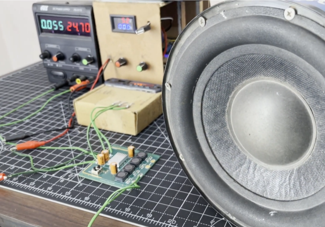

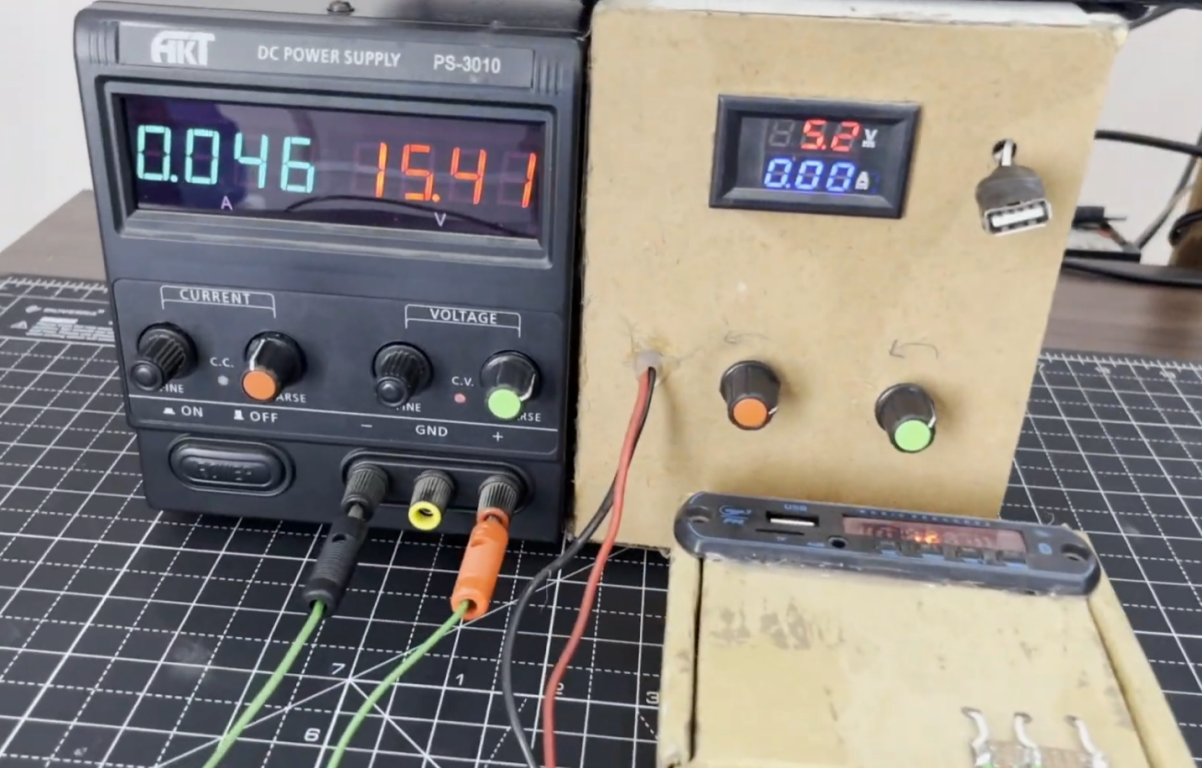

I powered the board with a 24V bench supply and an external 5V for the logic rail with another power supply to monitor the current in both. After the initial reset sequence (pull RESET low, then high) and unmuting via the CMUTE header, the amplifier came alive. For the full audio test you can refer to the video attached here.
I have tried music playback, frequency sweep, bass response, and real listening impressions with actual speakers. Audio quality is one of those things that does not translate well to text. You need to hear it. What I can say here at moderate listening levels, the amplifier is dead silent. No hiss, no hum, no audible switching noise. The closed-loop feedback does its job and the sound is noticeably cleaner than open-loop Class-D designs I have tried before.
