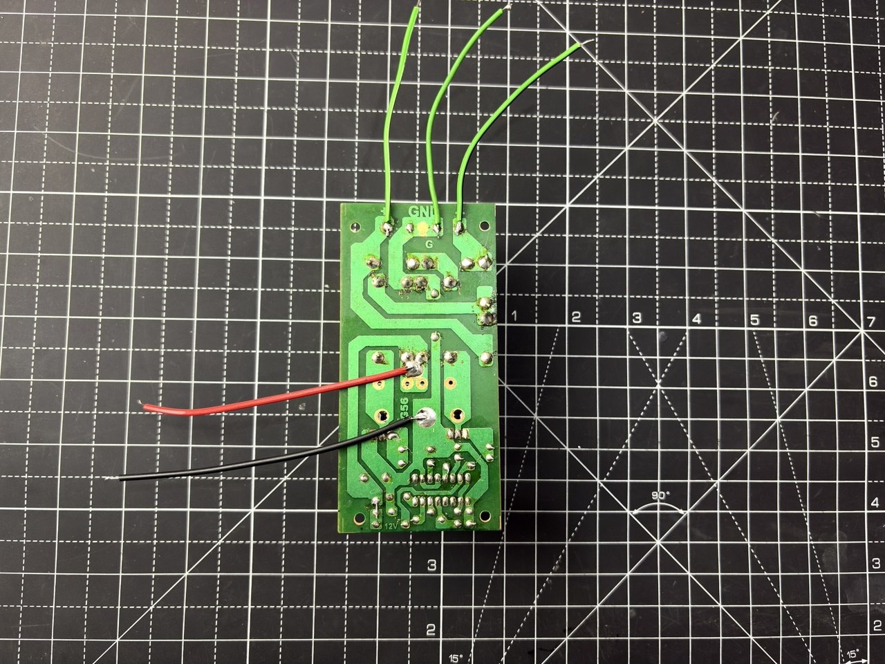

This is a compact PCB module designed for converting a single 12V DC input into a dual-rail +/-24V DC output. The target application is audio amplifiers and car audio systems. The board uses a push-pull converter topology built around the KA3525A SMPS controller IC and two IRFZ44N N-channel power MOSFETs. There's a centre-tapped transformer wound on a core mounted directly to the PCB, rectifier diodes on the secondary side, and electrolytic filter caps for the DC output.

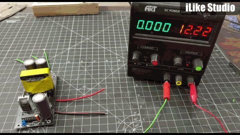

My Experience:

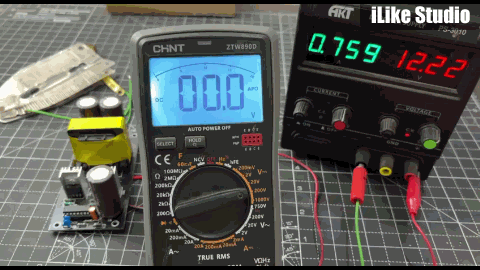

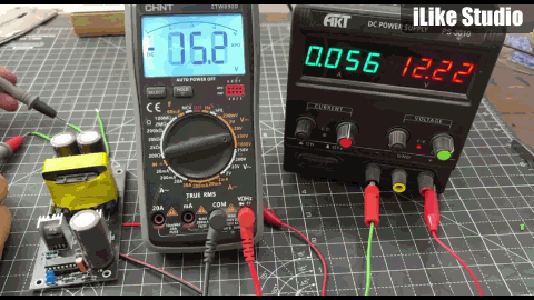

I got this module to pair with an audio amplifier that needed dual +/-24V rails but I only had a 12V bench supply handy. It delivered on its core promise stable +/-24V rails from 12V input, powering the amplifier, I have checked it using a multimeter. As the output capacitor charges it shows a significantly high voltage around 25V. But I have also tested it under some load for which the results are given here.
Under No Load:
Build quality is what you'd expect from a generic module. The PCB is decent, solder joints are acceptable, and the IRFZ44N MOSFETs are genuine. The transformer is the biggest component on the board and it's wound reasonably well. What you need to find is just a good component vendor in case you are building something like this on your own.
Under Load:
Outro:
