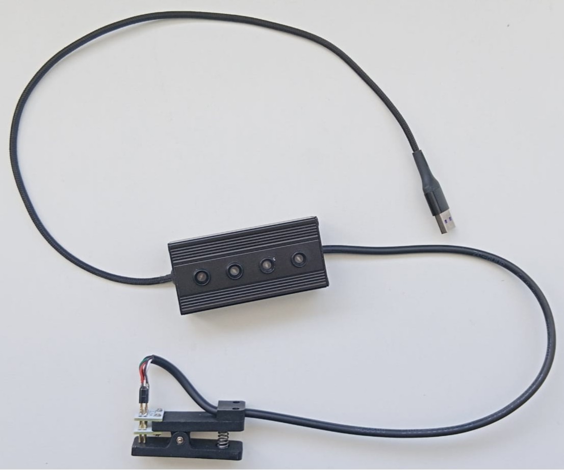

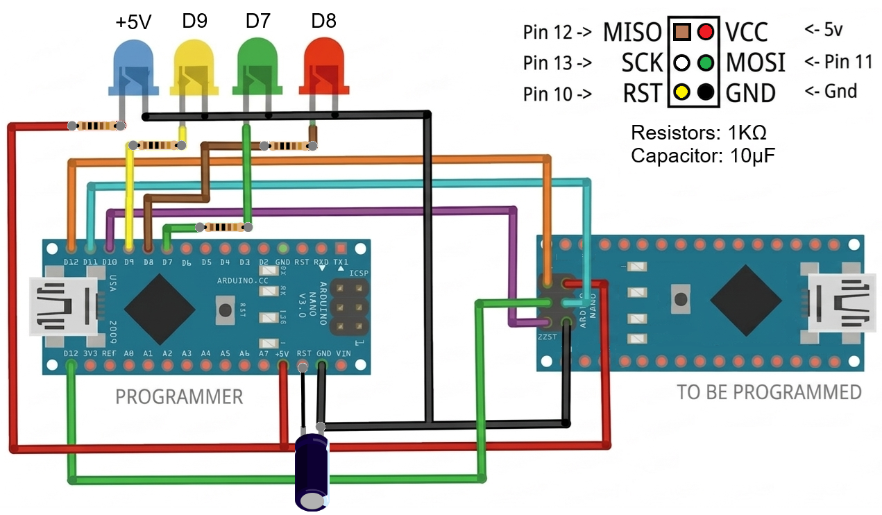

The hardware is straightforward and that's exactly the point. At its heart sits an Arduino Nano running the ArduinoISP sketch, with a reset-prevention capacitor soldered between its RESET and GND pins so the IDE stops fighting itself mid-upload. Four LEDs give you live status: blue for power, yellow for the programmer heartbeat, green for success, and red for the kind of news you were hoping to avoid.

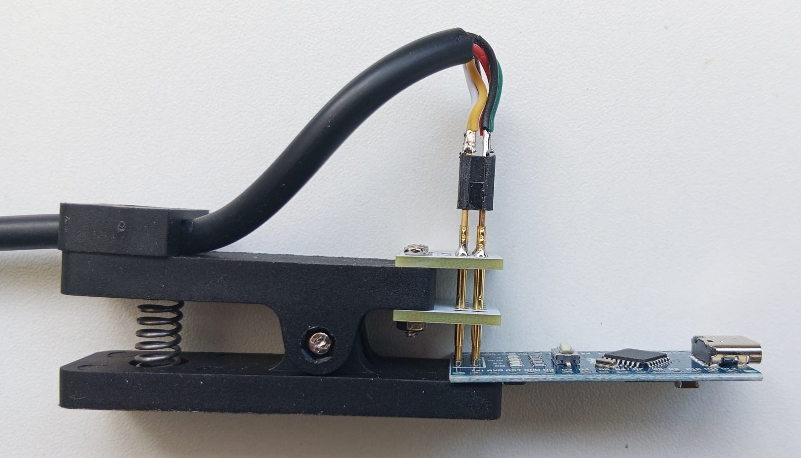

The clever bit is the connection to the target. A 2.45mm pogo pin clamp drops straight onto the unpopulated ISP pads of any Arduino — no soldering required on the target side. But here's the part that earns the chef's kiss: the clamp has a standard female connector sitting on top of it, so if the target does have pin headers fitted, you just slide that connector onto them instead. One tool, both situations, no adapter hunting.
