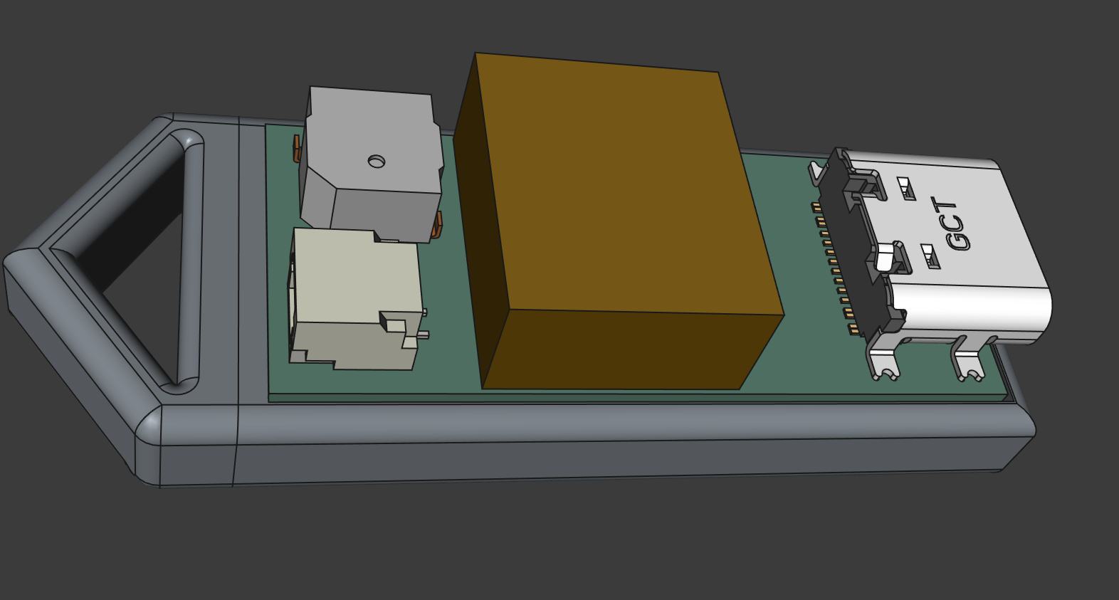

3D Printed Enclosure:
The Payload is so light/small that it can be placed into the chute area and attached to the nose cone with a lanyard. I printed out a minimalistic enclosure that protects components from damage and offers a way to attach the lanyard.
The golden block on top is the 501010 LiPo battery. I will just use heatshrink or electrical tape to secure the PCB and battery to the enclosure. There are vent holes on the bottom side to allow the barometer to sense pressure and show the charging LED. The barometer sensors are sensitive to light interference, so this should eliminate that as well.

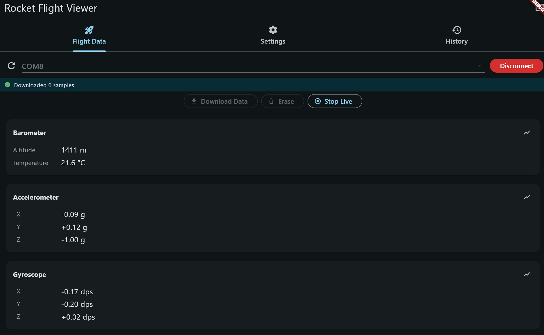

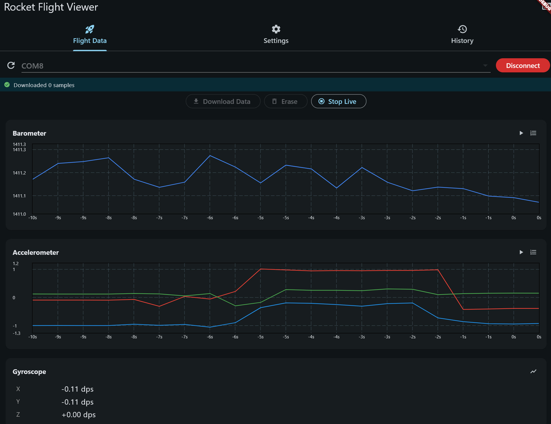

Claude is working on the application. I'm pretty much clueless regarding the coding required to make an application that potentially spans several operating systems. The App should function in the three major OS's (Win/Mac/Linux), and Android (allowing a phone to download/view data and reset the Payload for the next flight while still in the field.) Apple's iOS is a bit problematic because it requires Bluetooth for an interface. So far [2026-07-06], there is a stand-alone app for Windoze, Linux, and Android that are producing viable results. It is fairly simple, with three tabs to choose from. You can download these apps from my Github repository.
Flight Data Tab:
- Connect/Disconnect the COM port.

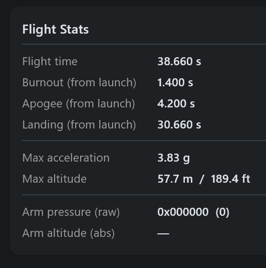

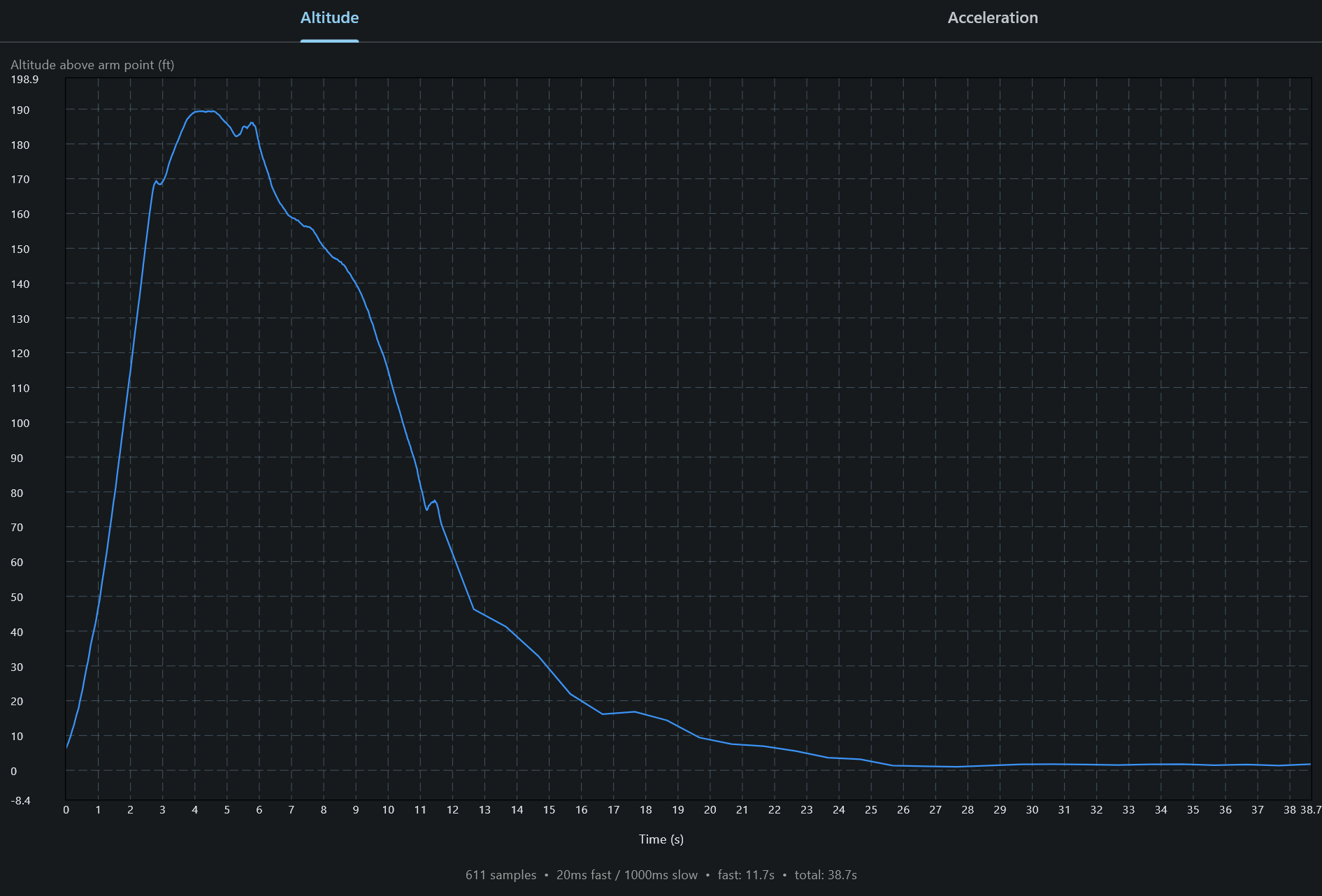

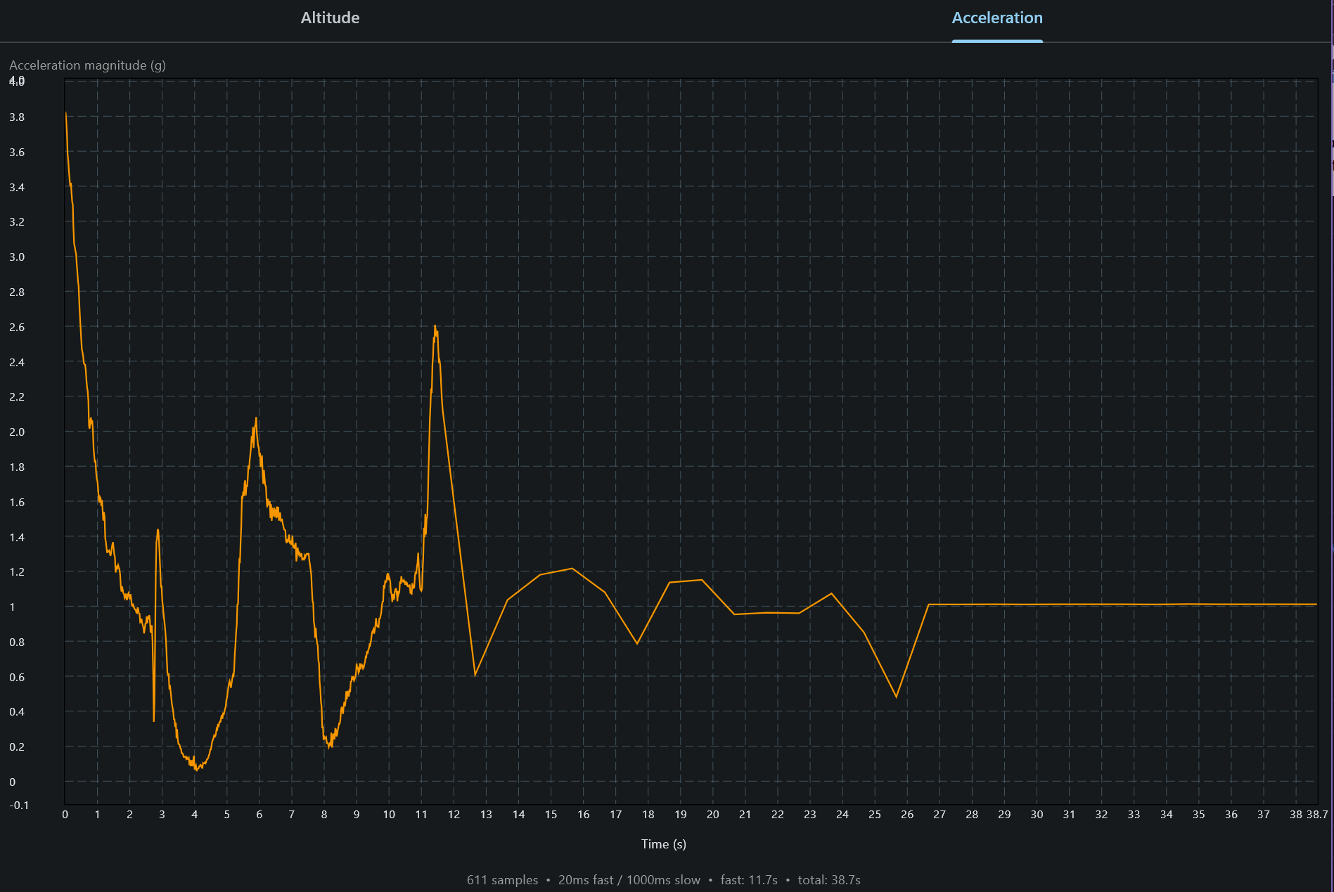

- Download all of the data stored in EEPROM and display altitude in m/ft or Acceleration. Flight Statistics are then derived from the downloaded data and presented below the plot. The plotted area can be zoomed to show more detail over a smaller section.
- Downloaded data can be saved to a CSV file as a historical record or for further analysis by other tools.
- Live data from the sensors can be displayed either as numbers or plotted in a 10 second scrolling window. Scrolling can pause/resume.
- Erase EEPROM data stored on the Payload to prepare for another flight.

[as of 2026-05-07] I have two prototypes (STANDARD) up and working. Using a quad-copter or hand toss to simulate flight. Settled on g-force to trigger launch detection, using altitude for apogee detection and landing. Application is bare bones, but useful for: downloading data, erasing data, displays flight parameters, changing settings, and saving/uploading flight histories to/from files. Application just needs a bit of polish.

[2026-07-15] Another successful flight. Found and fixed a bug that was causing missing data immediately after launch detection. The firmware and application are working well now. Haven't uploaded the latest app version (2.0.1) to Github repo yet.
