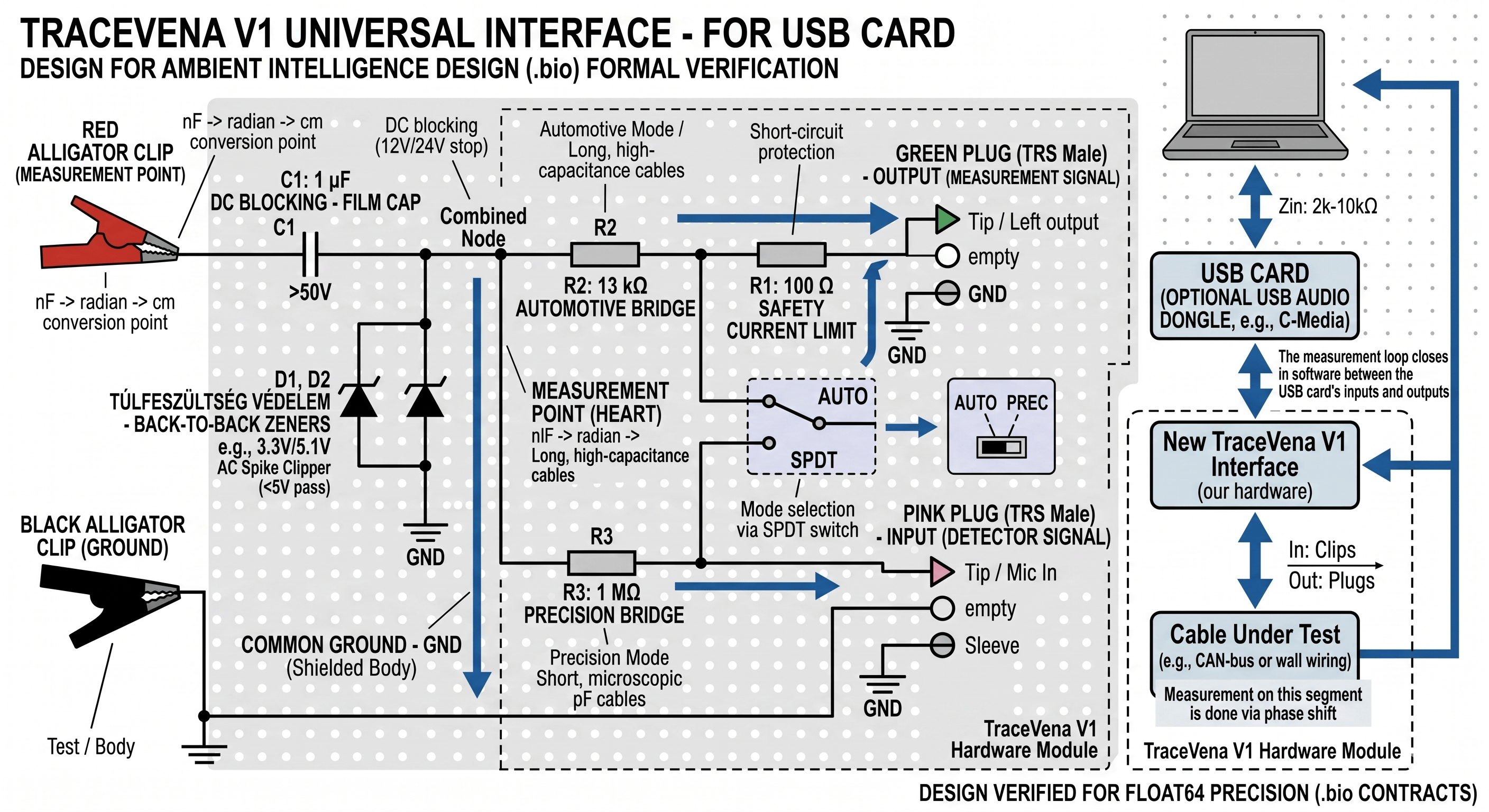

To safely connect a PC to a 12V harness, we built the TraceVena V1 perfboard interface. It uses an SPDT switch for range selection (13 kΩ for long cables, 1 MΩ for short wires) and a hardware firewall (1 µF film capacitor and 3.3V Zener diodes) to block DC voltage and AC spikes. Our software processes the raw audio via a Goertzel algorithm and Float64 precision, converting phase shift into cm-accurate distance.

3. Hardware Architecture (The Frugal Interface)
You cannot plug a car's 12V or 24V electrical system directly into your laptop’s microphone jack. To make this work safely, we designed a minimalist, $5 analog interface (currently built on a perfboard) that acts as a hardware firewall and measurement bridge.
Key Components of the Interface:
  • The Measurement Bridge (SPDT Switch): We use a toggle switch to change the measurement range. The "AUTO" mode uses a 13 kΩ resistor (R2) for long, high-capacitance automotive cables. The "PREC" mode uses a 1 MΩ resistor (R3) for short, micro-pF precision wires.
  • The DC Blocker: A 1 µF Film Capacitor (C1) sits right at the input. We specifically use film (not ceramic) because its capacitance remains perfectly stable regardless of the voltage. It blocks 12V/24V DC from frying the system, allowing only the AC measuring signal to pass.
  • The Overvoltage Protection: Two 3.3V Zener Diodes (D1, D2) are placed back-to-back to instantly clip any high-voltage AC spikes before they reach the soundcard.

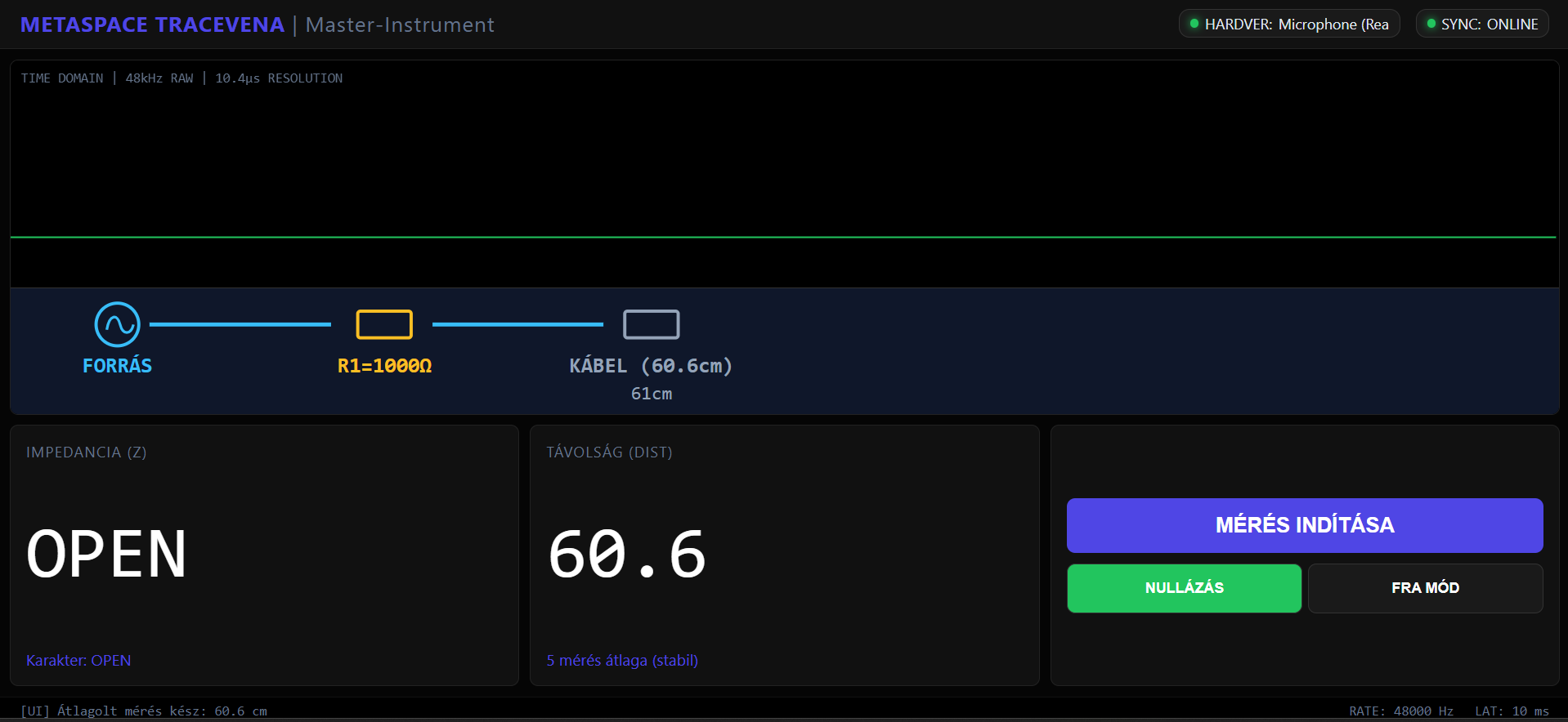

    Real-World Validation: It Works!
    We empirically calibrated the V8 engine using a 60 cm precision cable, and the results are incredibly promising:
    • OPEN (Wire Break): The system reliably measures the phase shift caused by parasitic capacitance, resolving the 60 cm cable with 1 cm resolution.
    • SHORT (Short Circuit): When the signal collapses completely (Magnitude drops below the noise floor), the deterministic logic refuses to guess. Instead of outputting random numbers, it correctly identifies the state as a SHORT and flags it as unlocalizable.

    The core http://localhost:8080 engine is stable. The next step is macroscopic field testing: taking the hardware out to the garage and testing it on actual 3 to 6-meter automotive wire harnesses to measure larger phase jumps (0.3 - 1.5 rad).

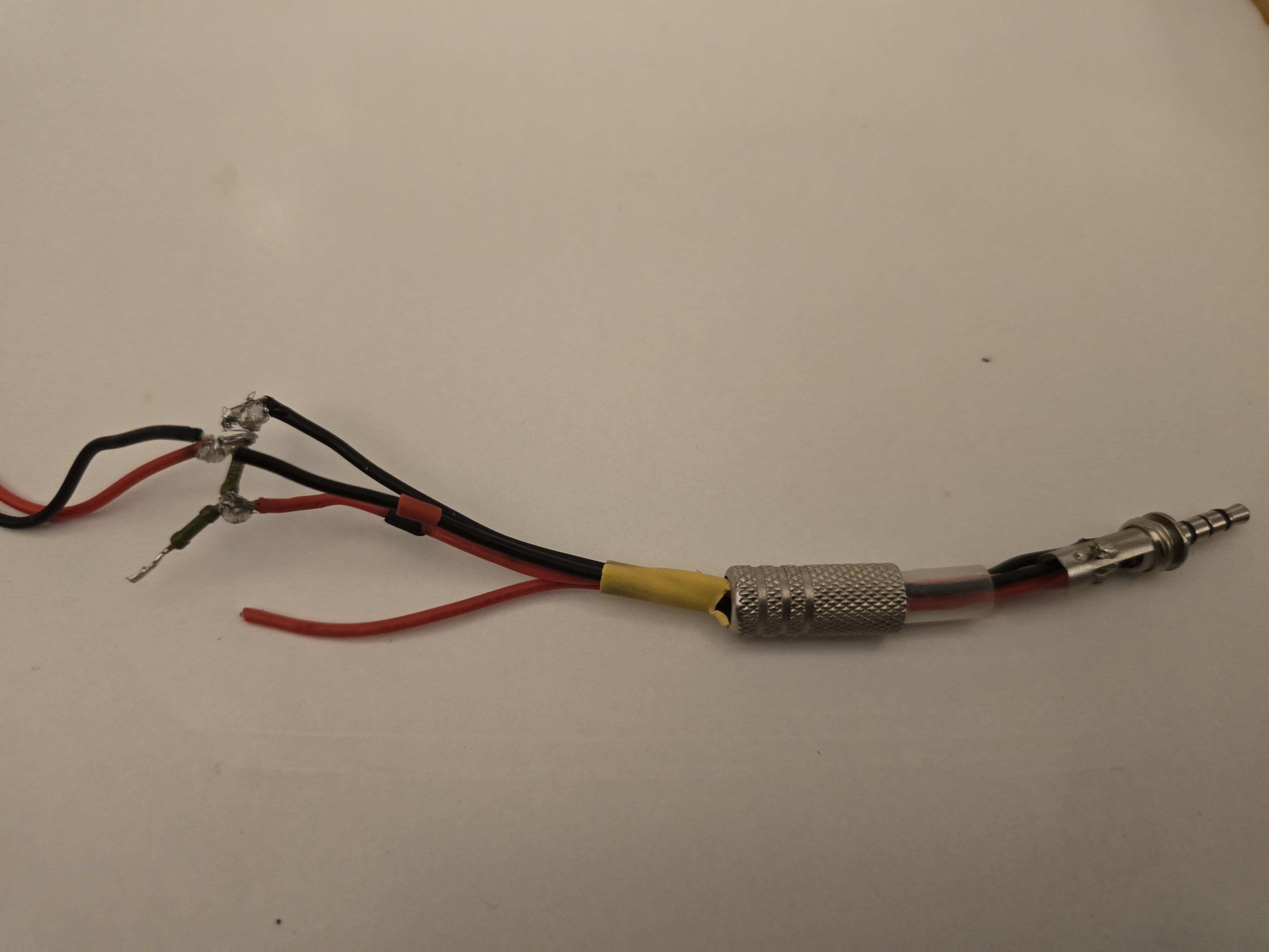

    Up until now, the TraceVena MetaSpace software engine (with all its Float64 precision and Z3 deterministic proofs) has been running on what can only be described as a "janky" hardware setup.
    To prove the core concept of audio-driven TDR and phase-shift measurement, I didn't have a fancy board. I literally used a raw TRRS jack, twisted a bare 13 kΩ resistor onto the wires, and plugged it straight into my soundcard. No hardware firewall, no Zener diodes, no mode switching. Just pure, unprotected proof-of-concept spaghetti wiring.
    It worked beautifully to validate the math and the Goertzel algorithm extraction, but let's be honest: taking an unprotected TRRS jack and clamping it onto a live automotive wiring harness is basically begging for a blown laptop motherboard.
    Building the First "Real" Interface Now that the software logic is solid, it's time to build the hardware that matches the schematic I posted in the project details. Today, I'm firing up the soldering iron to assemble the TraceVena V1 Universal Interface on a proper perfboard.
    The goals for this build session:
    1. Adding the Switch: Installing the SPDT toggle so I can physically switch between the Automotive Mode (13 kΩ) and the Precision Mode (1 MΩ).
    2. Building the Firewall: This is the most crucial part. I'm soldering the 1 µF film capacitor (for DC blocking) and the back-to-back 3.3V Zener diodes. This is the "armor" that will let me safely probe 12V/24V systems without frying the C-Media audio chip.
    3. Proper Connectors: Moving away from the twisted TRRS nightmare to clean, dedicated input/output TRS male plugs and proper alligator clips.
    I'll post photos of the soldered perfboard once it's done. If the hardware firewall calibrates correctly in the software (setting our parasitic 0.00 cm baseline), we are ready for actual garage field tests.

László SZŐKE wrote 04/29/2026 at 20:46 point
Hi everyone! Thanks for checking out TraceVena.
I’m currently moving from my 'janky' TRRS prototype to the V1 perfboard. The biggest challenge I’m facing is the 1 MΩ measurement bridge; pushing a sine wave through that much resistance puts the return signal right at the quantization noise floor of a standard C-Media ADC.
I’m using a massive 16,384-sample integration window and a Z3-based fail-safe to prove the phase shift, but I’d love to hear your technical critique on the analog front-end. Specifically, do you think the 1 µF film cap and back-to-back Zeners will introduce too much parasitic drift for cm-accurate TDR, or is my software-based baseline calibration enough to compensate?
Looking forward to your thoughts and 'destructive' criticism!
