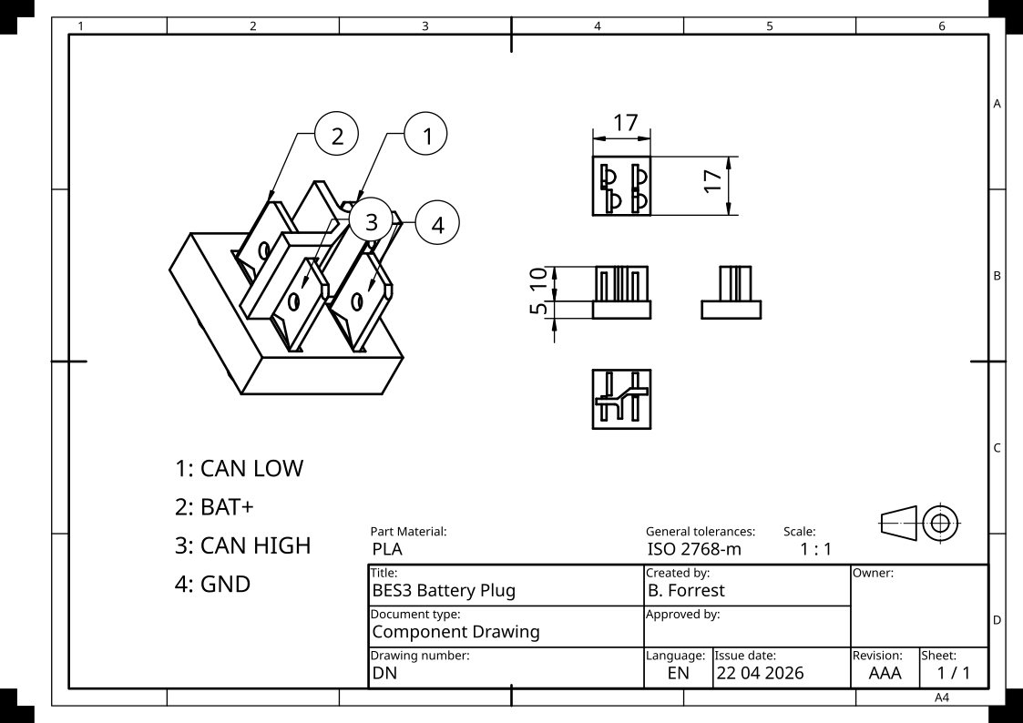

    By using a jerry-rigged 3D-printed connector for the battery port and an Adafruit Feather M4 "CAN Express" loaded
    with the latest Supercan Firmware, the jank was kept negligible.
    Plug Technical Drawing
    Technical drawing of the Plug with Pinout

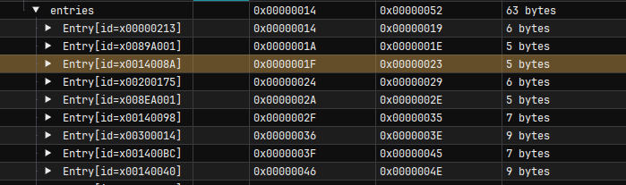

    Almost all data is streamed as tag-value pairs,
    with a header consisting of what I assume is a message authentication code (MAC) and a freshness counter to stop replay attacks reusing a packet.
    Tags I refer to as Entry IDs, and their values may or may not be structures themselves, which I further discriminate into fields by index.
    By looking at individual packets, it is evident that each Entry ID starts with a zero byte, followed by a low-entropy byte and then two high-entropy ones.
    To keep decoding simple for now, I disregard any meaning from this and use the whole four bytes as a unique number to assign entries.
    Enty IDs
    Entries after applying a pattern on a CAN-FD message in ImHex

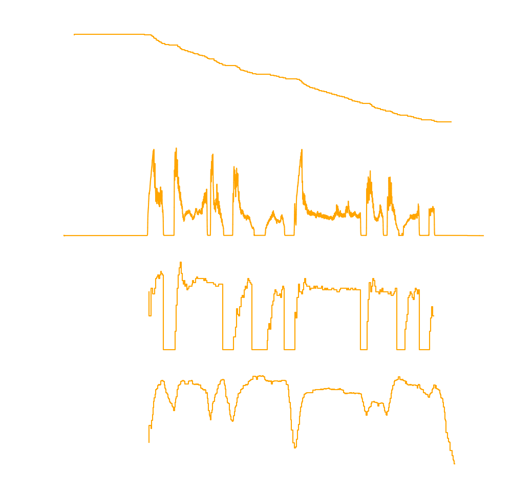

    Using that information obtained by passively snooping around, I got a decode working in Python a few days in.
    Behold, usable data!
    Decoder Plot
    The caveat to successfully decoding messages is correctly identifying the length of entries before the one of interest.
    This resulted in quite a few "sink" entries in my definitions file which are just there and contribute nothing yet.
