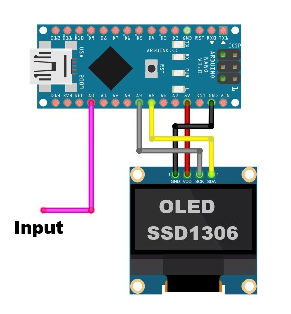

 Then I decided to make a small Arduino assembly with an OLED display, and to install the complete device in a suitable housing. For even more precise information, in a more advanced version of this device we can set up two input circuits with different input coils and capacitors for day and night signal propagation, or for a certain band.

   In my special case, instead of a voltmeter, I use an Arduino with an OLED display.

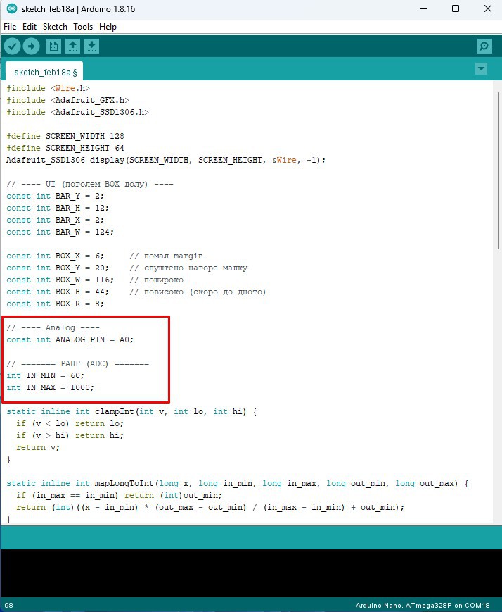

If you have experience with Arduino, it is advisable to use this method because you have better visibility of the result (numbers and bar) and also after a certain time you can calibrate it by changing the range of the mapped input signal, which will give us even greater precision, i.e. resolution. At the end of the text, the Arduino code is given.

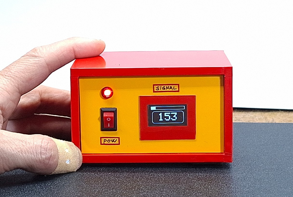

  Now let's see how the device works in real conditions: When turning on the display, a Relativity numerical value appears in the middle, and a small horizontal Bar indicator in the upper part. Currently, without an antenna connected, the value is about 150.
 I map the entire input from 0 to 1023, which means that the values on the display from 0 to 1024 correspond to a voltage from 0 to 5V.
 At the beginning of the code there are places where you can set the minimum and maximum expected value of the input signal to get maximum sensitivity.
 By connecting an antenna to the input, the bar moves to the right, and the numerical value also changes. In fact, these parameters show us the ability to reflect SW signals in the Ionosphere, i.e. SW propagation at that moment. After a short time of using this instrument, I can now notice even minimal changes in the reception conditions in this area.
 Of course, as I mentioned earlier, during the day the value is always lower, but with experience we will know exactly whether the reception conditions are good or bad, regardless of whether it is day or night.
