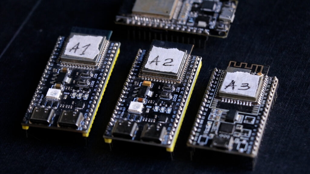

📡 Tag (ESP32)
This is the device being tracked, and its only job is to continuously broadcast a BLE signal so that other devices can detect it.
📍 Anchors (ESP32)
These are fixed nodes placed around the environment, and they constantly scan for the tag, measure RSSI, and send that data over Wi-Fi to a central server.
- Fixed positions
- Continuous scanning
- Real-time data transmission

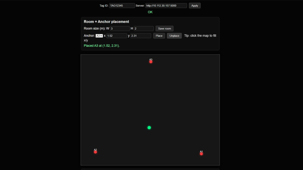

🧪 Testing — When It Starts Feeling Real
Once everything is configured, with all anchors connected to the same network and the server running, the system becomes interactive in a way that’s hard to appreciate until you see it working.
You place anchors on the map, define their positions, and after a few seconds:
A green dot appears.
Then you move the tag.
- The dot follows
- It jitters
- It corrects itself
Not perfect.
But alive.

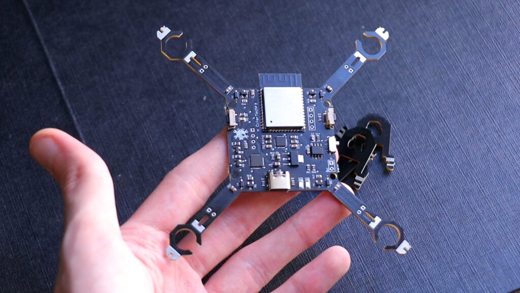

🔧 Hardware — Minimal Design, Real Constraints
ESP32 — Main Controller
- Control logic
- Communication
- Sensor processing
MPU6050 — Stabilization
- Gyroscope data
- Acceleration data
SI2302 MOSFETs — Motor Driving
- High current switching
- PWM control
Power System
- TP4056 → battery charging
- LF33 → voltage regulation
CP2102 — Communication
- Programming
- Debugging
