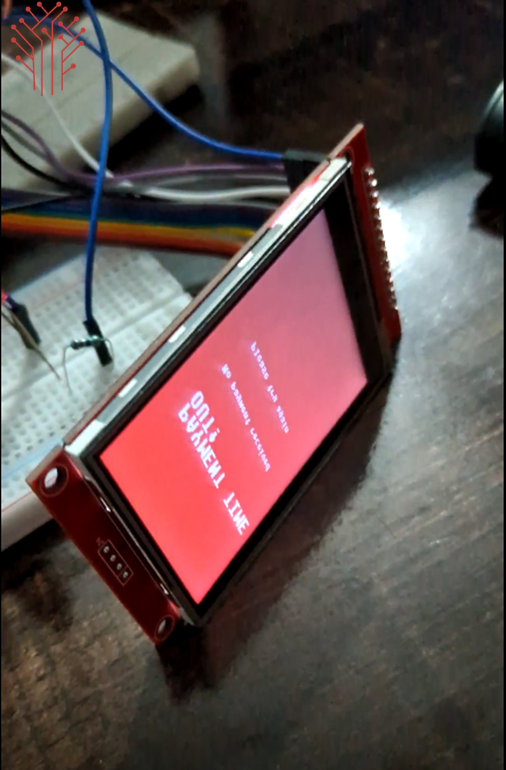

  • TFT display (ILI9341) for real-time QR rendering

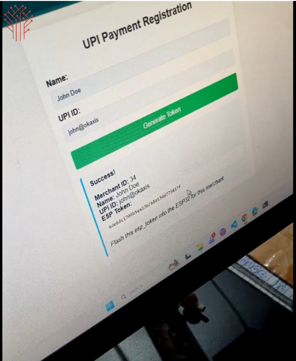

  1. ESP32 runs in AP mode for initial configuration
  2. User connects and submits:
    • UPI ID
    • Merchant Name
  3. Backend generates a UPI-compatible QR payload

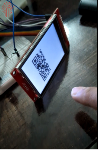

  4. ESP32 renders QR code on TFT display
  5. Customer scans QR using any UPI app

1. User Configuration (ESP32 AP Mode)
ESP32 starts in Access Point mode. User connects via mobile and opens a local web page to enter UPI ID and merchant name.
2. QR Code Generation
Entered details are sent to the backend (DigitalMonk server), which generates a valid UPI payment QR payload. ESP32 receives and displays it on the TFT.

5. ESP32 Action
ESP32 fetches/receives payment confirmation. If successful, it triggers the required action (e.g., dispense item, unlock system, etc.).
