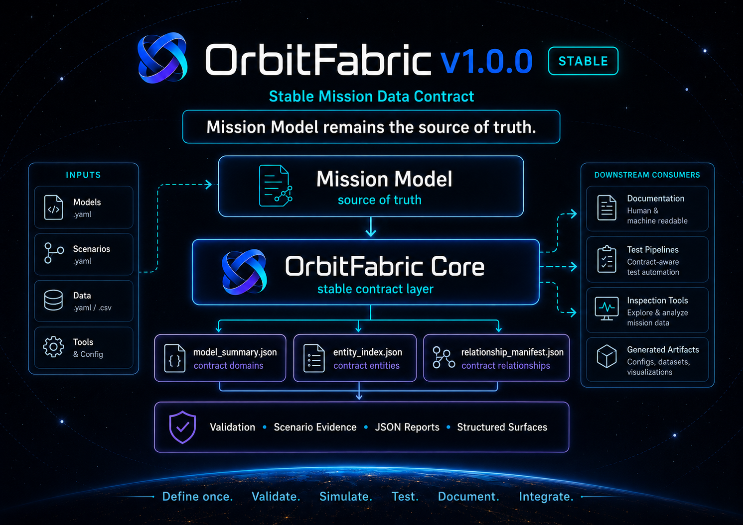

  • v1.0.0 - Stable Mission Data Contract
    Fabrizio Rovelli05/20/2026 at 16:33 0 comments
    OrbitFabric v1.0.0 is the first stable Mission Data Contract release.
    This is not another vertical slice.
    It is a boundary release.
    The previous public logs followed the growth of OrbitFabric through specific contract layers:
    payload contracts,
    data products,
    storage intent,
    contact and downlink assumptions,
    commandability and autonomy contracts,
    end-to-end data-flow evidence,
    and generated runtime-facing contract bindings.
    After that path, v1.0.0 stabilizes the deliberately narrow Core surface that those slices were building toward.
    OrbitFabric v1.0.0 stabilizes the Core contract boundary: Mission Model in, Core-owned structured surfaces and reproducible artifacts out.
    The important point is not that OrbitFabric is now complete.
    It is not.
    The important point is that the Core contract boundary is now explicit.
    What v1.0.0 stabilizes
    OrbitFabric v1.0.0 stabilizes a narrow Core surface around:
    • Mission Model documented contract semantics
    • structural validation
    • semantic linting
    • lint diagnostic policy
    • scenario YAML evidence inputs
    • lint JSON reports
    • simulation JSON reports
    • Core-owned structured surfaces
    • documented CLI workflows
    • release compatibility policy
    • extensibility boundary contract
    This is the v1.0.0 statement:
    Define the contract once.
    Validate it.
    Exercise scenario evidence.
    Generate review artifacts.
    Export Core-owned structured surfaces.
    Protect selected stable surface fields with golden signatures.
    Keep the Mission Model as the source of truth.
    That is the stable boundary.
    Not flight software.
    Not a ground segment.
    Not a mission control system.
    A Mission Data Contract framework.
    One of the most important v1.0.0 decisions is that downstream tools should not reconstruct OrbitFabric semantics from raw YAML, generated Markdown, terminal output, logs, UI state or private assumptions.
    They should consume Core-owned structured surfaces.
    The stable structured surface chain is:
    model_summary.json
            -> What contract domains are present?
    entity_index.json
            -> What contract entities are defined?
    relationship_manifest.json
            -> How are indexed contract entities related?
    These surfaces are derived from the validated Mission Model.
    They are not a second source of truth.
    They are read-only Core-owned views over the source of truth.
    That distinction matters for future tools.
    A visual workbench, inspection layer, generated artifact pipeline or future extension should not need to reimplement OrbitFabric Core semantics.
    It should consume the structured surfaces produced by Core.

  • From mission model to reproducible artifacts
    Fabrizio Rovelli05/05/2026 at 12:48 0 comments
    The core idea behind OrbitFabric is simple.
    The Mission Model should be the source of truth.
    Not the generated documentation.
    Not the test log.
    Not a hand-written table.
    Not a partially outdated diagram.
    The model comes first
    In many small spacecraft projects, mission data definitions start clean and then drift.
    Telemetry is described in one place.
    Commands are implemented somewhere else.
    Events and faults are listed in a document.
    Payload behavior is captured in tests.
    Storage assumptions live in a planning sheet.
    Downlink assumptions are discussed during integration.
    Ground-facing artifacts are created later, often manually.
    OrbitFabric explores a different flow.
    The model comes first.
    The current demo mission lives under:
    examples/demo-3u/mission/
    It contains structured YAML files for the mission contract:
    ├── spacecraft.yaml
    ├── subsystems.yaml
    ├── modes.yaml
    ├── telemetry.yaml
    ├── commands.yaml
    ├── events.yaml
    ├── faults.yaml
    ├── packets.yaml
    ├── policies.yaml
    ├── payloads.yaml
    ├── data_products.yaml
    └── contacts.yaml
    Those files are not intended to be a pretty configuration layer over an existing implementation.
    They are intended to make mission-data assumptions explicit before they become scattered across code, tests, documents and ground tooling.
    The current v0.4.0 flow
    The current v0.4.0 flow is:
    Mission Model YAML
            -> structural validation
            -> semantic lint
            -> engineering lint
            -> JSON lint report
            -> generated Markdown documentation
            -> scenario validation
            -> deterministic scenario execution
            -> simulation report
            -> simulation log
    That matters because every generated artifact is derived from the same declared contract.
    If a telemetry point is renamed, the documentation should not silently keep the old name.
    If a scenario references a command that does not exist, that should fail early.
    If a payload data product references an invalid producer, that should be detected.
    If a downlink flow references an unknown contact profile or an ineligible data product, that should not remain a hidden integration assumption.
    CLI flow
    The current CLI reflects this model-first flow.
    Typical local checks are:
    orbitfabric lint examples/demo-3u/mission/
    orbitfabric gen docs examples/demo-3u/mission/
    orbitfabric sim examples/demo-3u/scenarios/battery_low_during_payload.yaml
    Generated documentation
    The generated documentation currently includes mission-facing artifacts such as:
    generated/docs/
    ├── telemetry.md
    ├── commands.md
    ├── events.md
    ├── faults.md
    ├── modes.md
    ├── packets.md
    ├── payloads.md
    ├── data_products.md
    └── contacts.md
    These files are generated outputs.
    They are useful for review, discussion and integration.
    But they are not the source of truth.
    The source of truth remains the Mission Model and the scenario definitions.
    Scenario evidence
    The same applies to simulation reports and logs.
    For example, the synthetic demo scenario battery_low_during_payload exercises a declared chain:
    payload.start_acquisition
            -> payload.acquisition_started
            -> mode transition into PAYLOAD_ACTIVE
            -> battery voltage degradation
            -> eps.battery_low
            -> mode transition into DEGRADED
            -> automatic payload.stop_acquisition dispatch
            -> payload.acquisition_stopped
            -> scenario passed
    This is not a physics simulation.
    It is not a flight software runtime.
    It is not running on...
