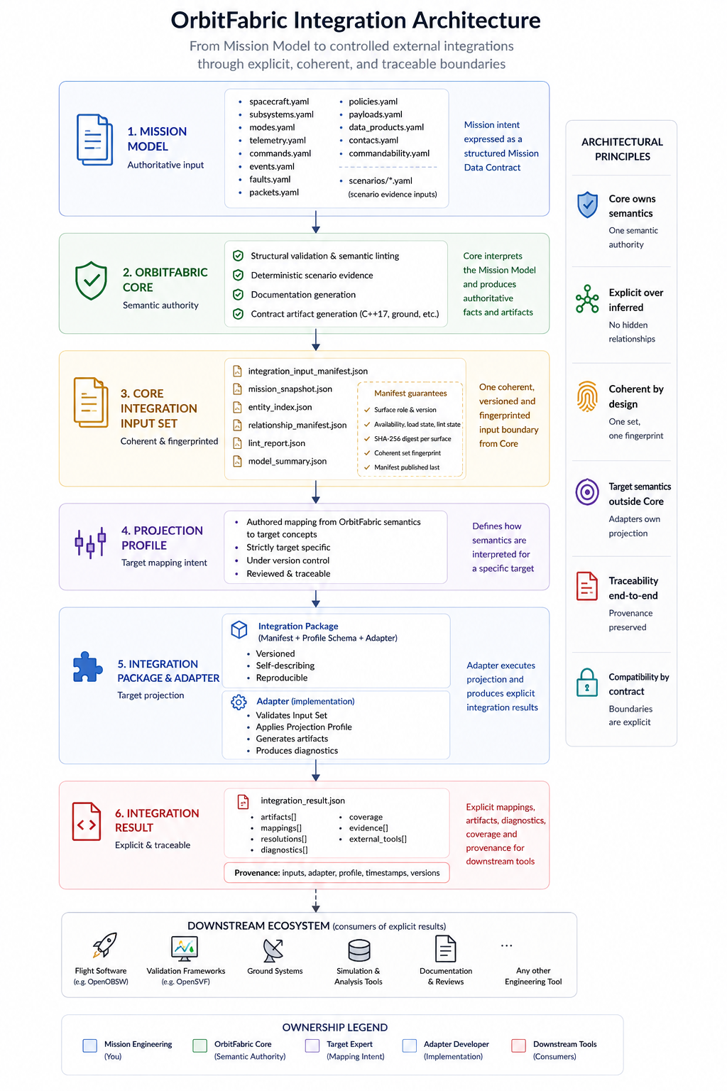

This led to the main integration change in OrbitFabric v1.2.
The Core Integration Input Set
Core can now produce one coherent Integration Input Set from one logical load and lint operation.
The current set contains:
integration_input_manifest.json
mission_snapshot.json
entity_index.json
relationship_manifest.json
lint_report.json
model_summary.json
The important part is not only the files.
The important part is that Core produces them as one coherent unit.
The manifest records information including:
- required and companion roles
- surface kind and version
- availability
- load state
- lint state
- SHA 256 digests
- a deterministic fingerprint of the complete input set
The complete set is fingerprinted using canonical JSON serialization.
The manifest is written last.
This gives an external integration a simple rule:
Either consume one coherent Core Integration Input Set,
or stop.
If a required surface is incompatible, the integration must reject the input.
It must not fall back to reparsing the Mission Model YAML and continue with its own interpretation.
That fallback would defeat the entire semantic ownership boundary.
Why the manifest is written last
This may sound like a small implementation detail, but it is part of the contract.
If the manifest appeared before all required surfaces were successfully written, another process could observe what looks like a complete Integration Input Set while some artifacts are still missing or incomplete.
Publishing the manifest last turns it into the completion marker for the set.
The manifest therefore represents not only metadata, but also the publication boundary of one coherent Core output.
From files to an integration architecture
Once the Core input boundary became explicit, the next architectural layers became much easier to separate.
OrbitFabric Integration Architecture. Core owns Mission Data Contract semantics and produces one coherent integration input boundary. Target specific projection, adapter execution and Integration Result ownership remain outside Core.
The ownership model is:
OrbitFabric Core
and coherent integration inputs
Projection Profile
owns authored target specific
projection intent
Integration Adapter
owns target validation,
projection and artifact generation
Integration Result
owns explicit mappings,
artifacts,
diagnostics,
coverage and provenance
Downstream consumer
presents, navigates or orchestrates
those explicit records
The important consequence is that target specific semantics stay outside Core.
Core does not need to know how a particular flight software framework, validation environment or ground system represents telemetry, commands or events.
The adapter understands the target.
The Projection Profile expresses the authored mapping intent.
The Integration Result records what actually happened.
Core remains responsible for OrbitFabric semantics.
