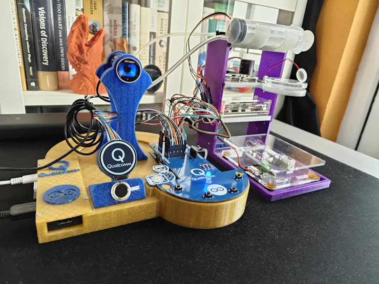

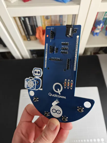

As I was taking inspiration from my previous lab assistant project, I heavily modified the device structure and added a lot of new features specific to this iteration, for instance, designing a unique PCB (UNO Q shield) for utilizing various lab sensors to conduct LLM-assisted basic lab experiments. After months of hard work, I managed to complete the reimagined AI-driven ancillary lab assistant structure and develop all the features I envisioned on UNO Q by solely employing the Arduino App Lab development environment, providing foundational building blocks (Bricks).

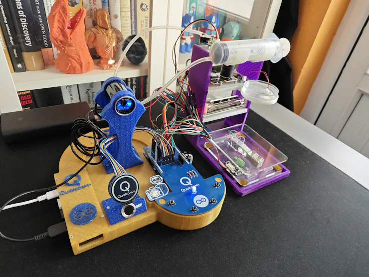

🤖 To build the ancillary lab assistant structure:

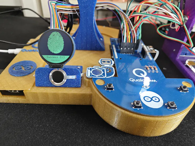

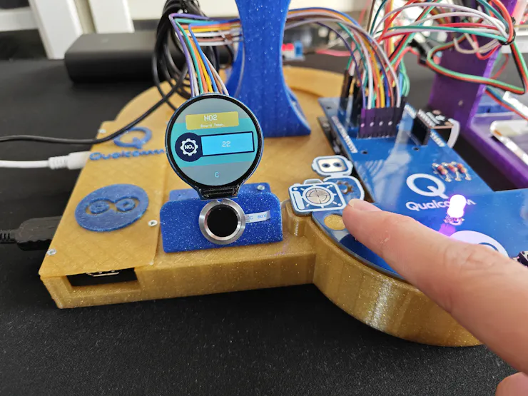

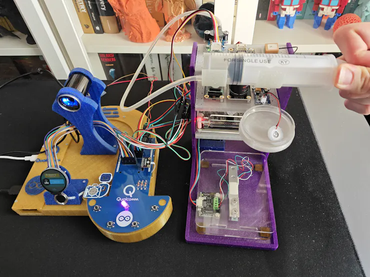

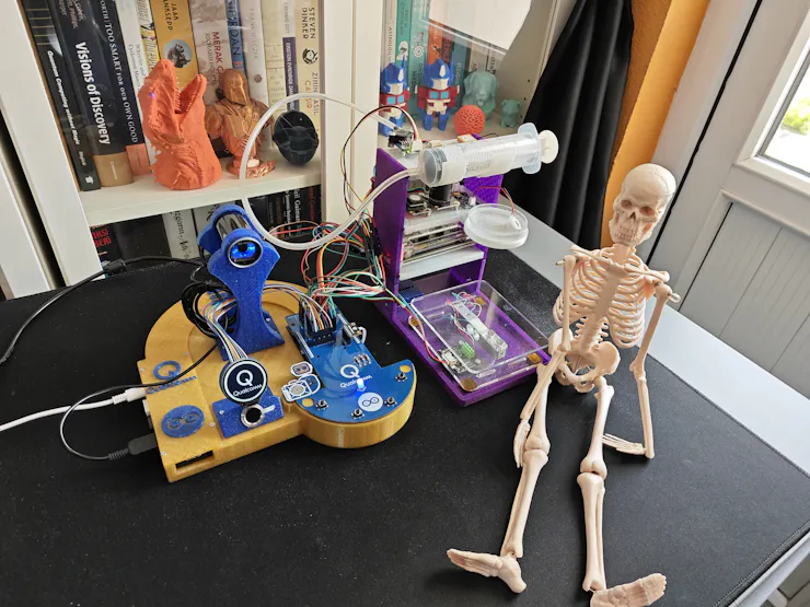

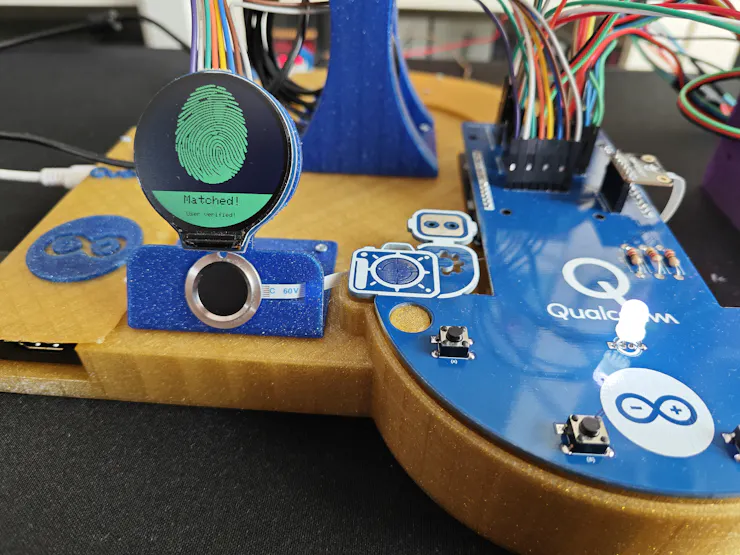

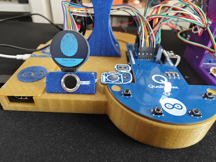

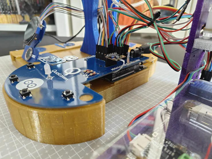

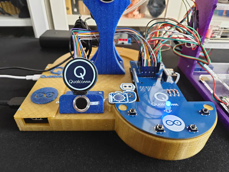

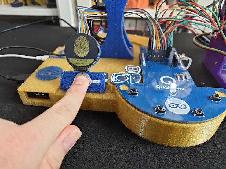

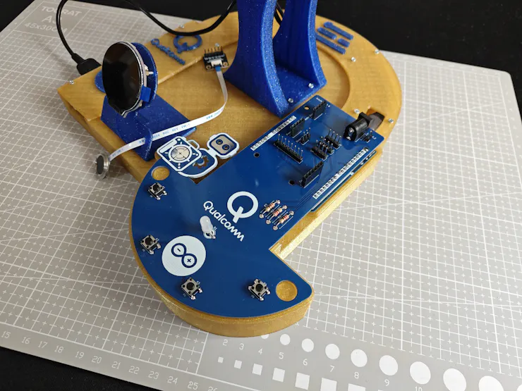

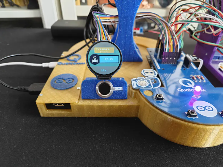

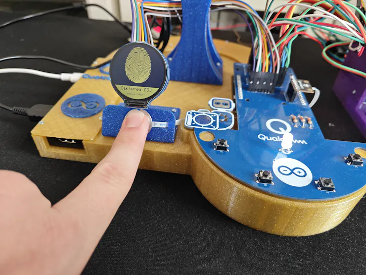

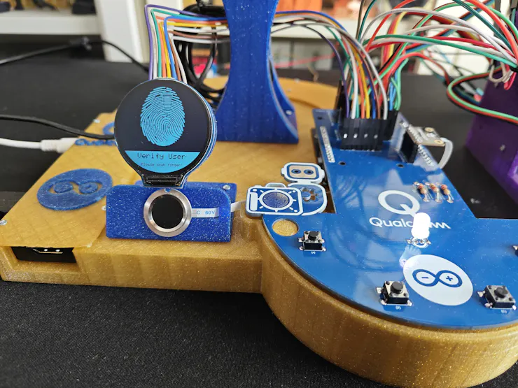

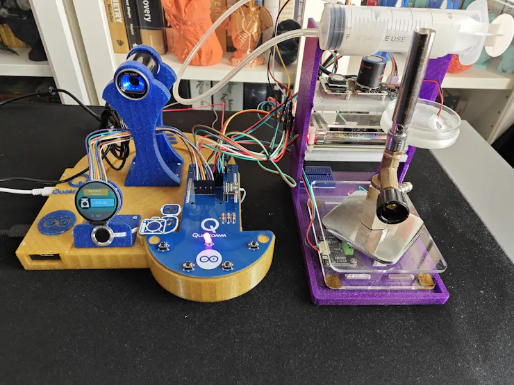

✍🏻 I designed a unique PCB as a UNO Q shield (hat) to connect the selected lab sensors and create the analog lab assistant interface, including the capacitive fingerprint sensor.

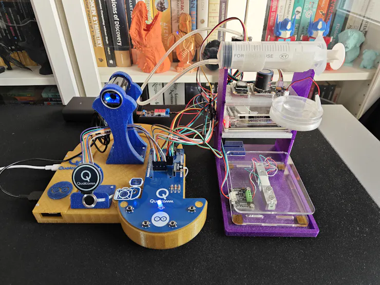

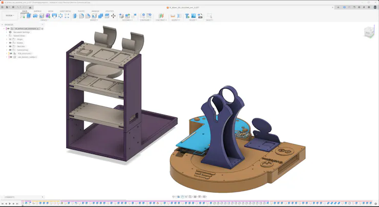

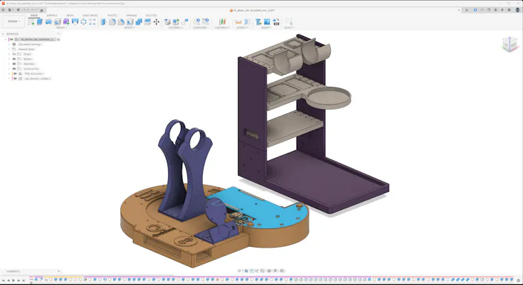

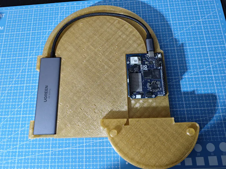

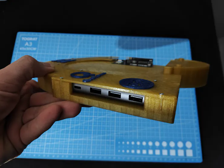

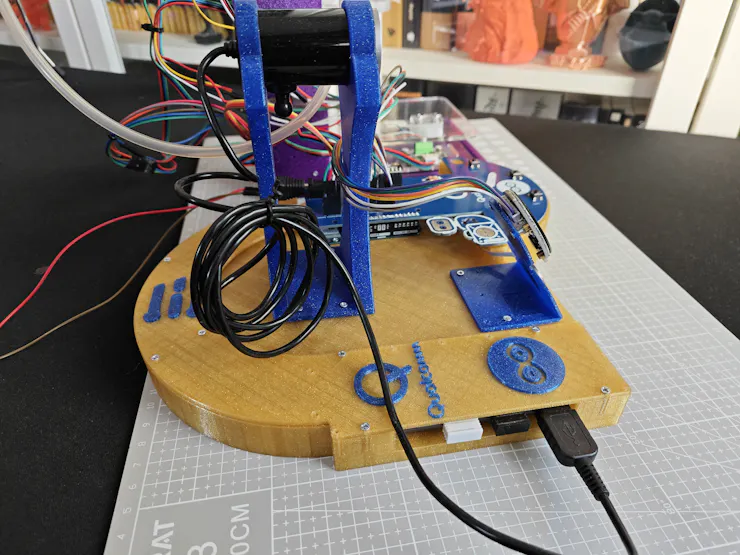

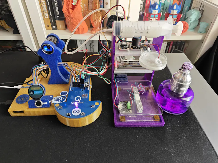

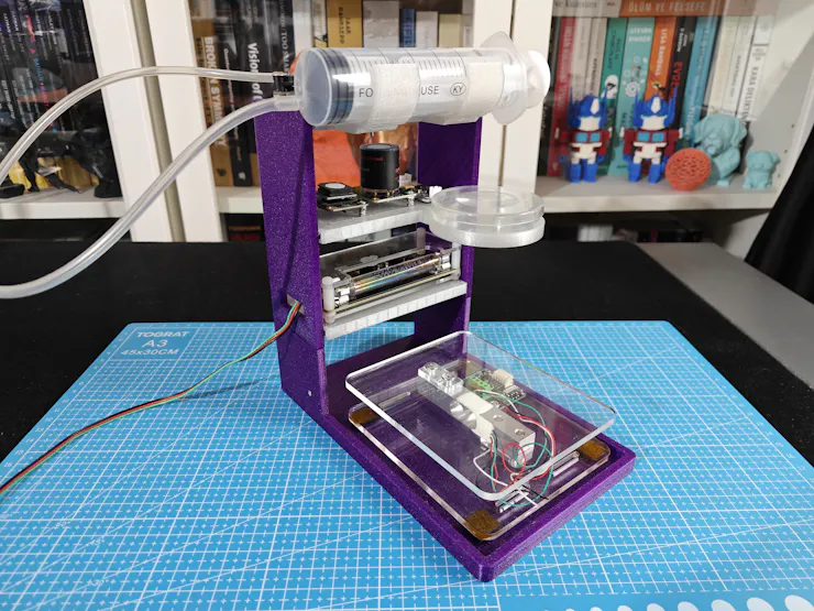

✍🏻 Then, I modeled 3D parts to design the ancillary lab assistant base, containing the USB camera and the analog interface.

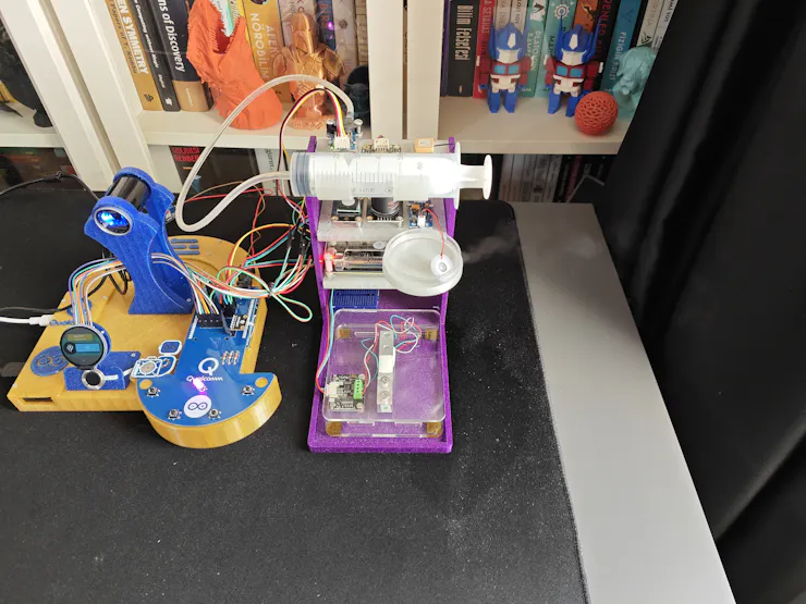

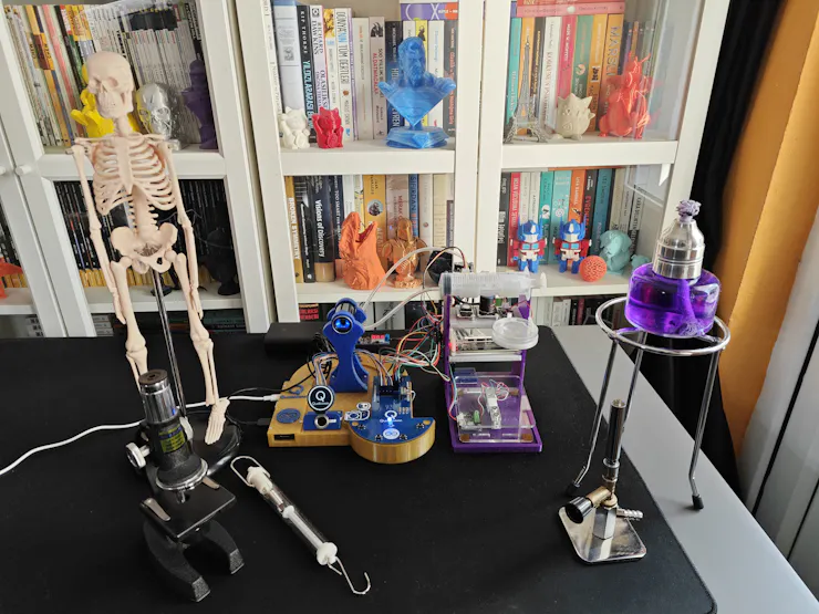

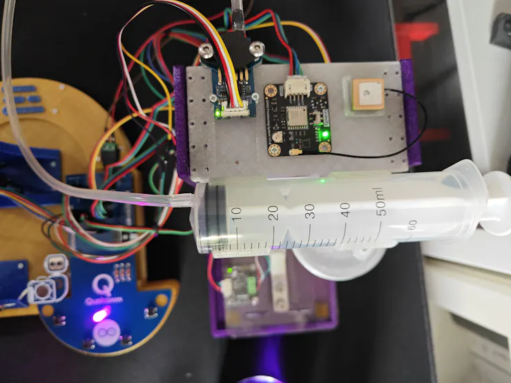

✍🏻 Finally, I designed a modular lab sensor ladder, organizing all sensors and secondary experiment tools, to create a compact but easy-to-use instrument.
🤖 To accomplish all of the ancillary lab assistant features I contemplated, performed by an Arduino App Lab application:

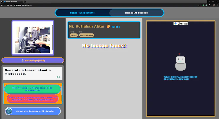

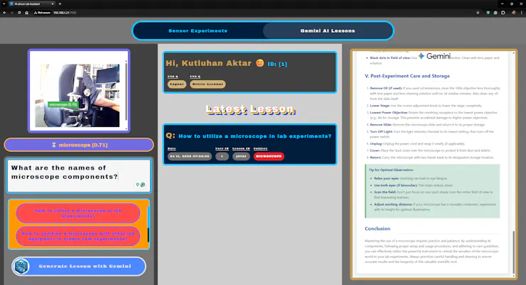

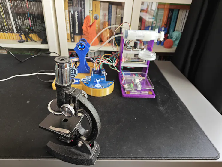

🛠️ I trained an Edge Impulse object detection model to identify various lab equipment.

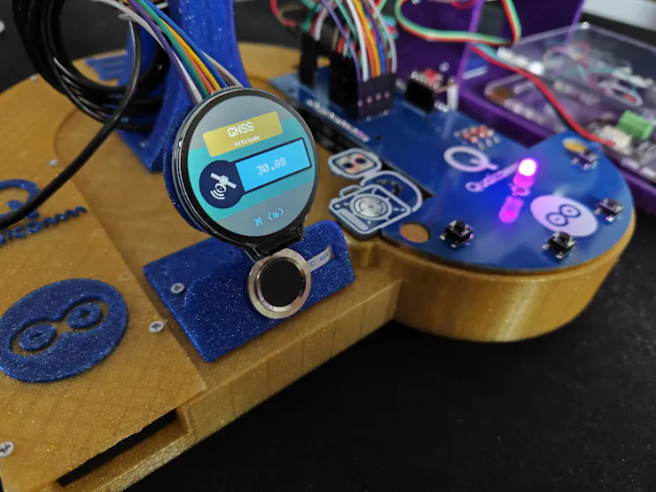

🛠️ I programmed the MCU (STM32) to collect real-time sensor information and manage the analog lab assistant interface.

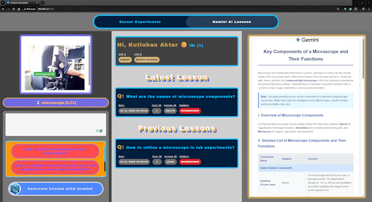

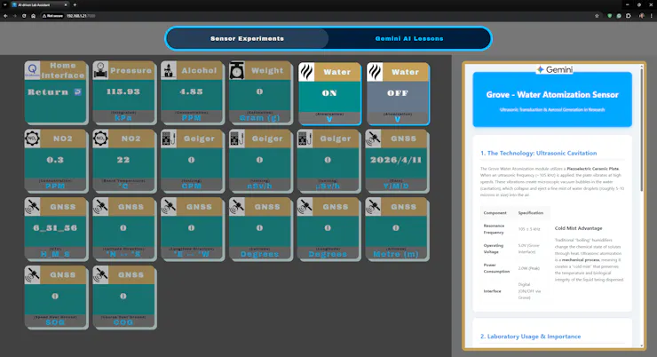

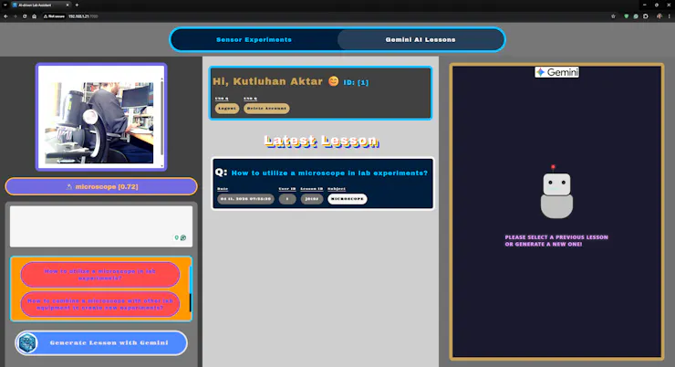

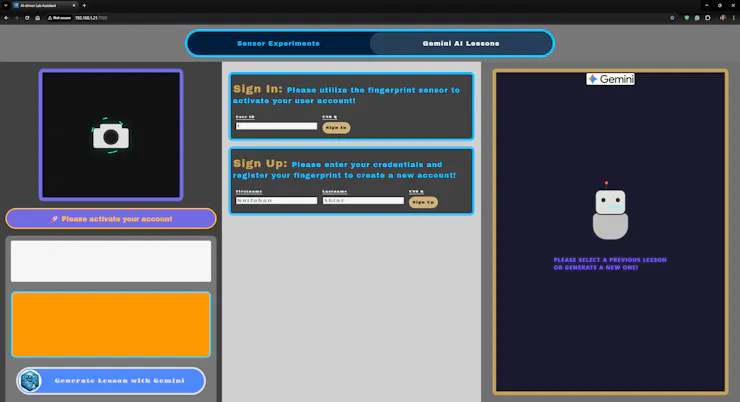

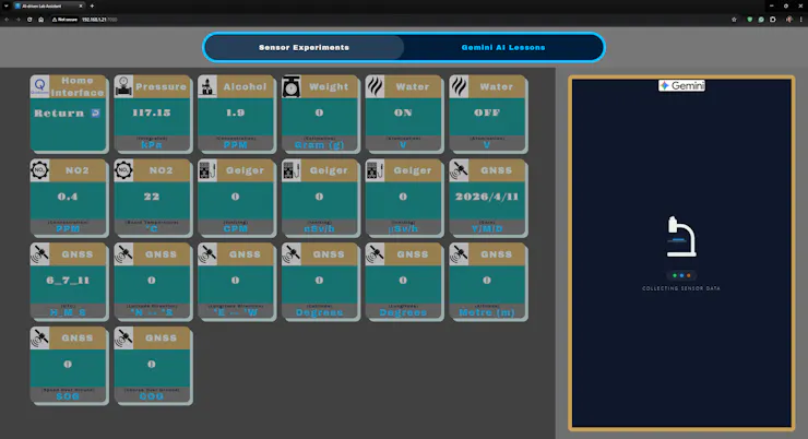

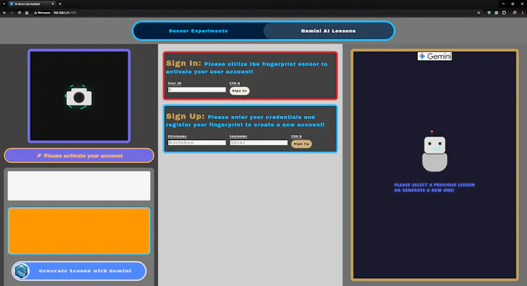

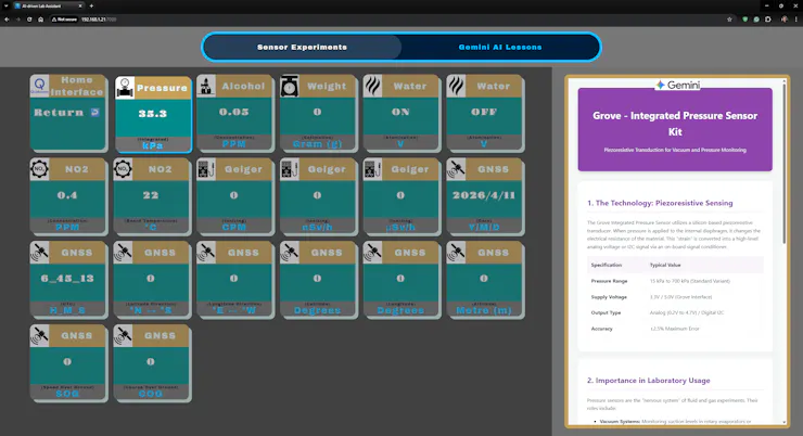

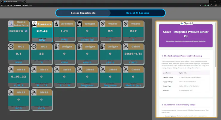

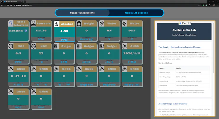

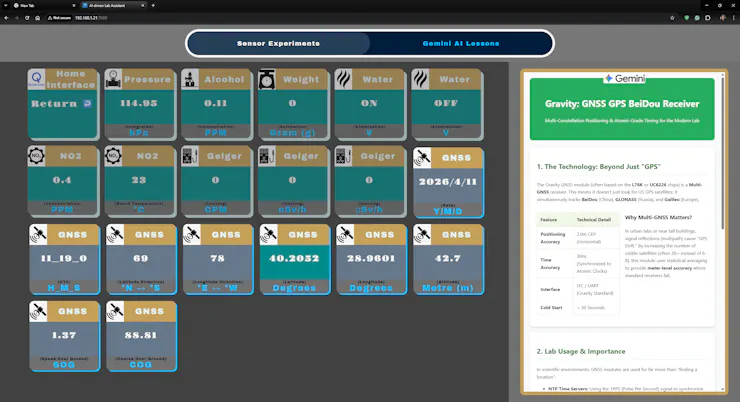

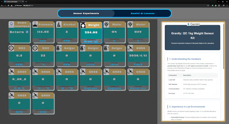

🛠️ I developed a feature-rich web dashboard as the primary user interface and control panel of the lab assistant, hosted directly by the Arduino App Lab.

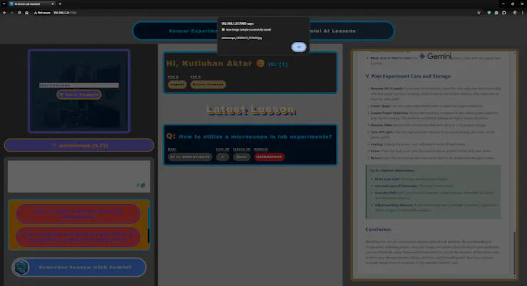

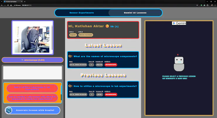

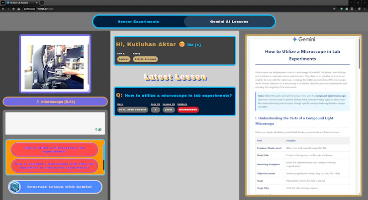

🛠️ I incorporated Google Gemini to enable the lab assistant to generate LLM-based lessons about the detected lab equipment.
🛠️ Thanks to the built-in background Linux MPU-MCU communication service (Arduino Router), I built the interconnected interface background in Python, handling the data transfer between the web dashboard, the analog interface (MCU), and the Qualcomm QRB (MPU) running the essential App Lab Bricks (Docker containers); database registration, inference running, web dashboard (UI) hosting, etc.
🤖 The finalized ancillary lab assistant allows users to:
🔬 create web dashboard accounts and sign in via fingerprint authentication,

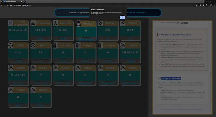

🔬 monitor real-time lab sensor readings via the analog interface or the web dashboard,
🔬 inspect LLM-generated sensor guides and experiment tips for each lab sensor via the web dashboard,

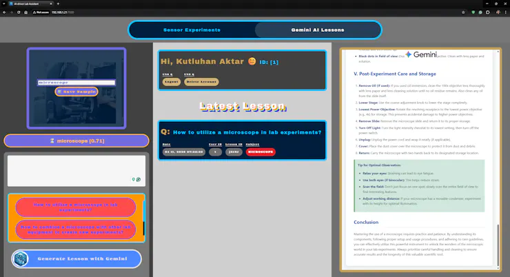

🔬 capitalizing on the built-in browser text-to-speech (TTS) module, listen to LLM-generated sensor guides and experiment tips,
🔬 identify lab equipment via the provided Edge Impulse FOMO object detection model,
🔬 use the predefined equipment questions or enter a specific one to generate AI lessons through Google Gemini,
🔬 access the list of LLM-generated lessons assigned to your account on the web dashboard anytime,
🔬 study LLM-generated lessons by reading or listen to them via the TTS module.
