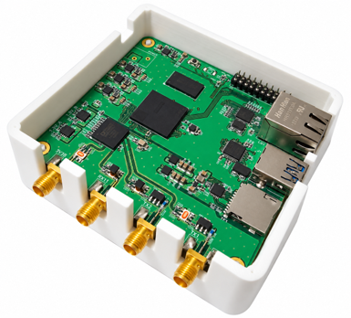

Figure 1. Integrive-100, the SDR development platform we built during this project.

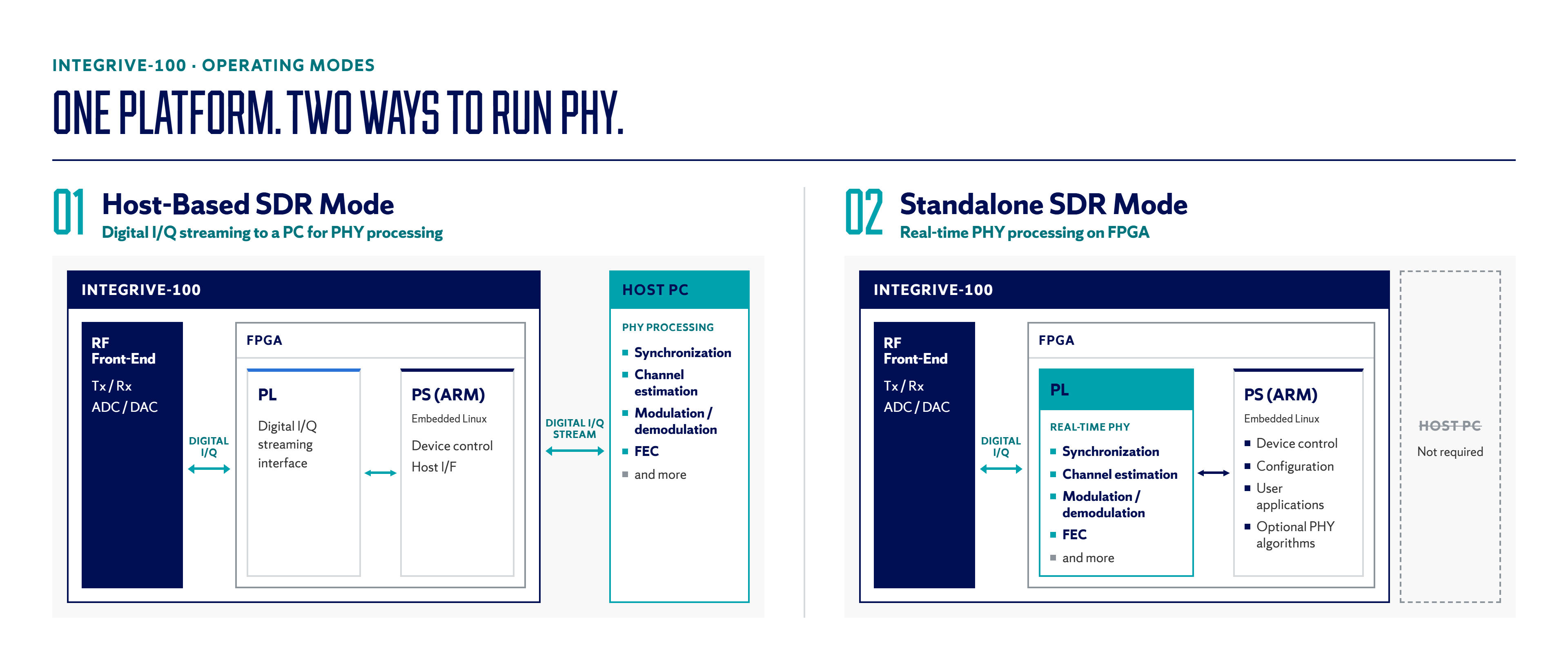

    Two SDR Operating Modes of Integrive-100: Host-Based and Standalone
    Integrive-100 supports two operating modes. In Host-based SDR Mode, digital I/Q samples are streamed to and from a host PC for software-based PHY processing. In Standalone SDR Mode, the real-time PHY processing chain runs directly on the FPGA, enabling independent wireless system operation without a host PC.
    Left:
    • Digital I/Q samples are streamed between Integrive-100 and a host PC.
    • PHY functions, including synchronization, channel estimation, modulation/demodulation, and FEC, are executed on the host PC using C/C++, Python, MATLAB or other software tools.
    • Ideal for algorithm development, verification, signal analysis and experimentation.
    Right:
    • Enables easy development and evaluation of PHY algorithms in real RF.
    • Enables product-level validation of PHY, MAC and networking protocols under real-world wireless conditions.
    • Accelerates the transition from validated wireless prototypes to product development.

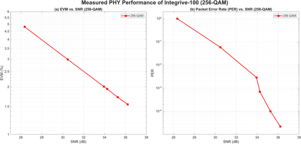

    In loopback measurements, the radio achieved a combined TX/RX EVM of −35 dB or better, providing approximately 3 dB of margin relative to the −32 dB reference level used for 256-QAM.
    But we also wanted to see what this looked like in an operating PHY rather than relying on the loopback EVM measurement alone.
    For this test, we implemented SIP-DDM, our PHY technology for highly reliable wireless communication, together with Reed–Solomon coding and no retransmission.
    The figure below shows the measured EVM and packet error rate (PER) as SNR changes.
    Figure 1. Measured 256-QAM performance on Integrive-100 using the SIP-DDM PHY with Reed–Solomon coding and no retransmission: (a) EVM versus SNR and (b) PER versus SNR.
    As SNR increases, EVM decreases while PER drops rapidly. At approximately 36 dB SNR, the measured EVM reaches about 1.55%, while PER falls to around 2 × 10⁻⁵.
    For us, the important part of this test was seeing the RF hardware and PHY processing working together in an actual packet-based 256-QAM link.

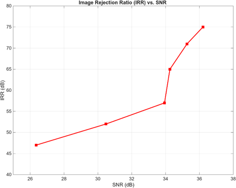

    I/Q Imbalance and Image Rejection
    Another RF impairment we looked at was I/Q imbalance, which can generate unwanted image components that degrade signal quality, particularly in direct-conversion RF systems. Integrive-100 uses digital I/Q calibration to suppress these image components.
    Figure 2. Measured image rejection ratio (IRR) versus SNR.
    As shown in Figure 2, the measured image rejection ratio (IRR) reaches up to 75 dB, providing a reliable RF foundation for PHY algorithm evaluation.

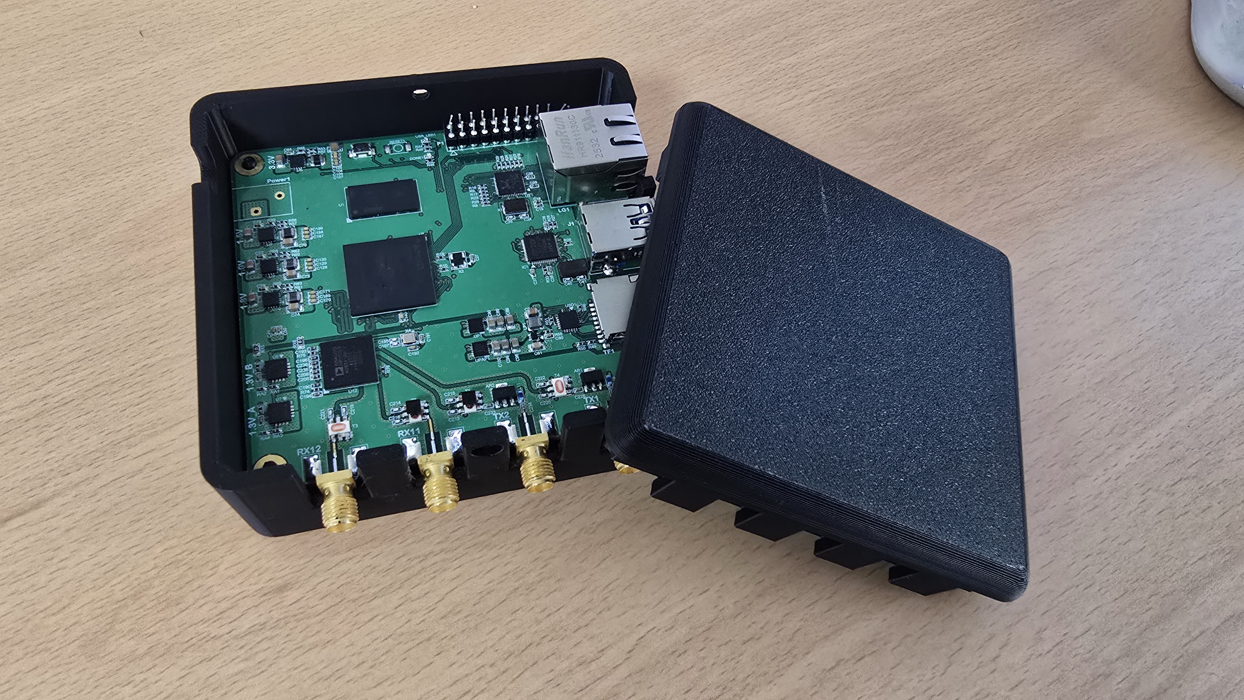

    Integrive-100 in Black Case
    I’d like to explore how the architecture I discussed in the previous post helps us build wireless applications and validate them in real RF environments.

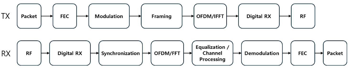

    From PHY Algorithms to Real RF Validation
    One of the design goals was to make it easier to test an individual PHY algorithm without rebuilding the entire communication chain around it.
    A complete wireless PHY includes synchronization, channel estimation, equalization, modulation and demodulation, FEC, framing, OFDM processing, and RF configuration. In research, however, the focus is often on only one or two of these functions.
    Figure 1. The Tx/Rx processing chain used in Integrive-100.
    When testing a new channel-estimation algorithm, moving it from simulation to RF hardware still requires the surrounding receive chain to be available: synchronization, FFT processing, equalization, demodulation, framing, and data movement.
    We got tired of having to deal with all of that just to test one algorithm. What we wanted was a workflow where the function under development could run in software on the ARM-based Processing System (PS), while the existing FPGA implementation handled the surrounding PHY processing in the Programmable Logic (PL).
    This allows the algorithm to be evaluated within an operating PHY rather than only against simulated or previously captured data.

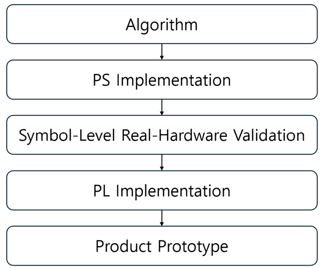

    Figure 2. An algorithm can first be evaluated in the PS within the working PHY chain and later moved toward a PL implementation when deterministic real-time processing is required.
    The distinction we wanted to make here is between testing an algorithm by itself and testing it as part of an operating wireless link.
    With the complete Tx/Rx chain running, the algorithm can be evaluated at the symbol level using actual transmitted and received RF signals. This makes it possible to observe behavior under practical hardware effects that may not be fully represented in simulation.
    The same approach can be applied to other areas of PHY research, including synchronization, FEC, modulation/demodulation, OFDM processing, and framing. For synchronization in particular, real RF testing involves effects such as timing error, carrier-frequency offset, phase noise, and other RF impairments. For OFDM and waveform development, parameters such as FFT size, cyclic prefix, modulation, and framing can be explored before moving toward a real-time implementation.
    You can select the function you want to investigate and implement or evaluate a new algorithm on the embedded ARM processor, while the remaining PHY functions continue to operate in FPGA logic. In this way, the algorithm is not tested in isolation, but as part of a working PHY over real RF hardware.

Jayoung Oh wrote 09/18/2026 at 03:03 • point
The main profile photo with my hand is real. The white case is a prototype, and AI was only used to enhance the photo, but I just replaced it with the original one (thanks for pointing that out). For the black one, I used the white prototype image to try out different colors and add the logo with AI. The final case is still in development, and I'm still deciding on the color.
Matthew wrote 09/17/2026 at 20:06 • point
Why were both images in your details section AI generated?  Theres a SynthID coming from ChatGPT from the 2 images.
