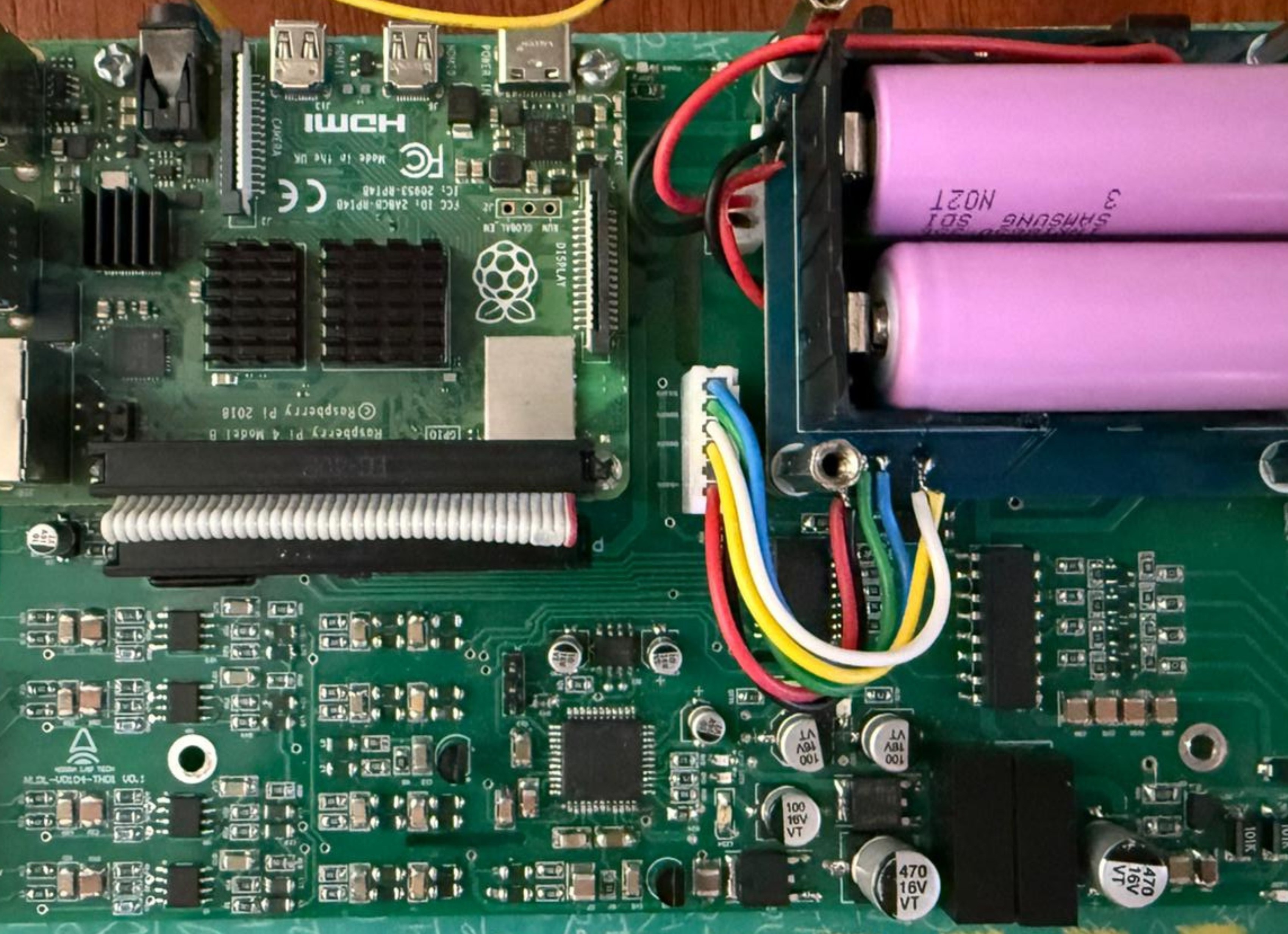

This project started during the development of a real industrial system based on Raspberry Pi.
At the time, we were using one of the commercially available UPS HATs to provide backup power and improve reliability. While the idea worked well on paper, the real-world behavior turned out to be far less stable and predictable than we expected.
During testing and long-term operation, we experienced several problems including:
  • unstable restart behavior
  • reboot loops after low battery conditions
  • unreliable shutdown handling
  • inconsistent recovery after power loss
  • inaccurate battery and fuel gauge readings
  • and power behavior that was difficult to trust in unattended systems
That experience eventually pushed us to start designing our own UPS architecture — with the goal of building something stable, dependable, and truly usable beyond hobby projects and into real industrial environments.

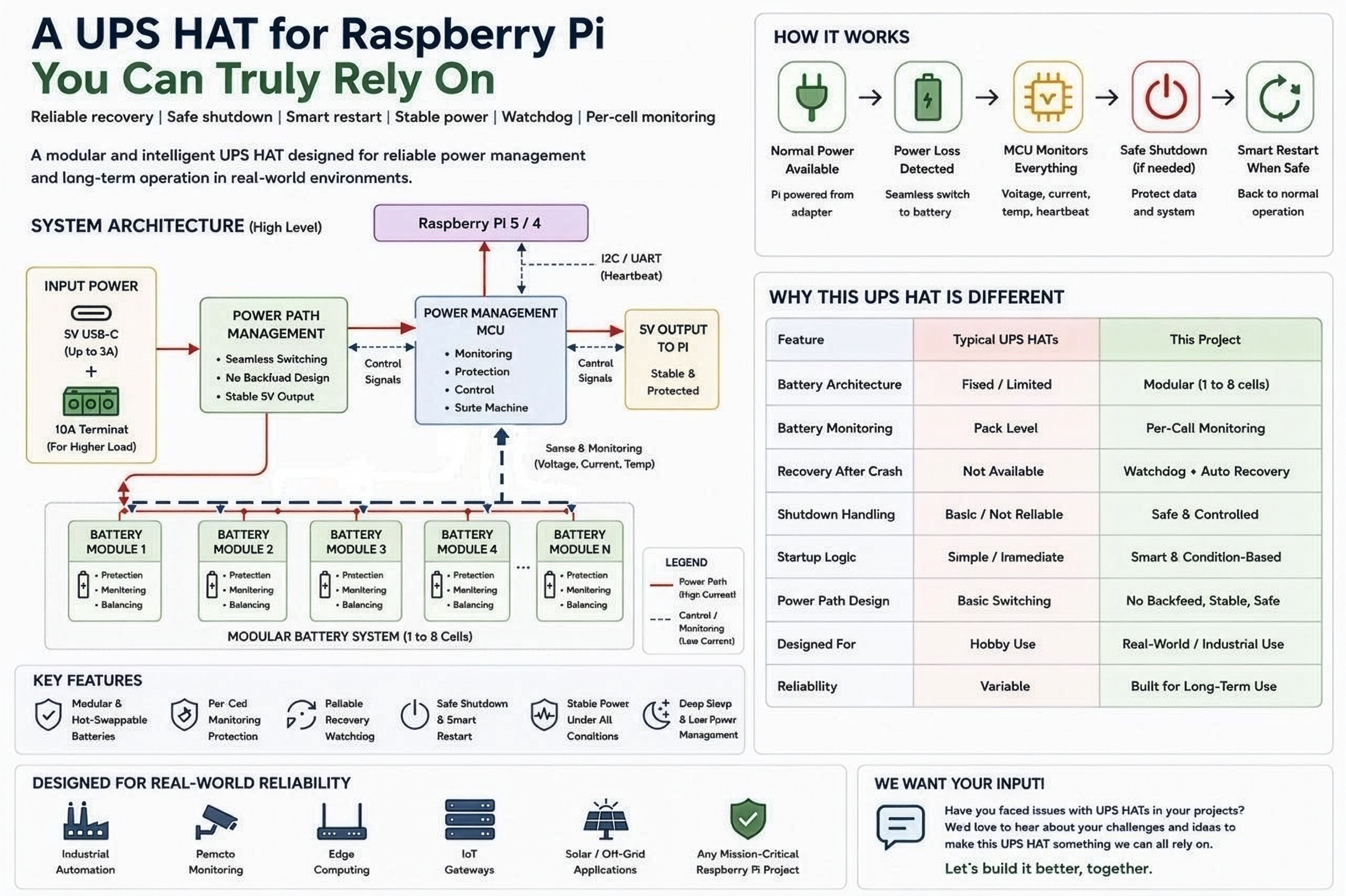

OVERVIEW
The goal of this project is not simply to create another Raspberry Pi battery backup board.
We are trying to design a UPS HAT focused on:
  • reliable power recovery
  • safe shutdown behavior
  • watchdog-based crash recovery
  • stable long-term operation
  • modular battery scalability
  • safer unattended operation
The current design direction includes:
  • support for 1 to 8 modular 18650 battery modules
  • per-cell monitoring and protection
  • hot-swappable battery architecture
  • heartbeat-based Raspberry Pi watchdog monitoring
  • smart restart and recovery logic
  • safe shutdown handling
  • no-backfeed power path design
  • deep sleep and low power standby behavior
  • USB-C and high-current terminal power input options
