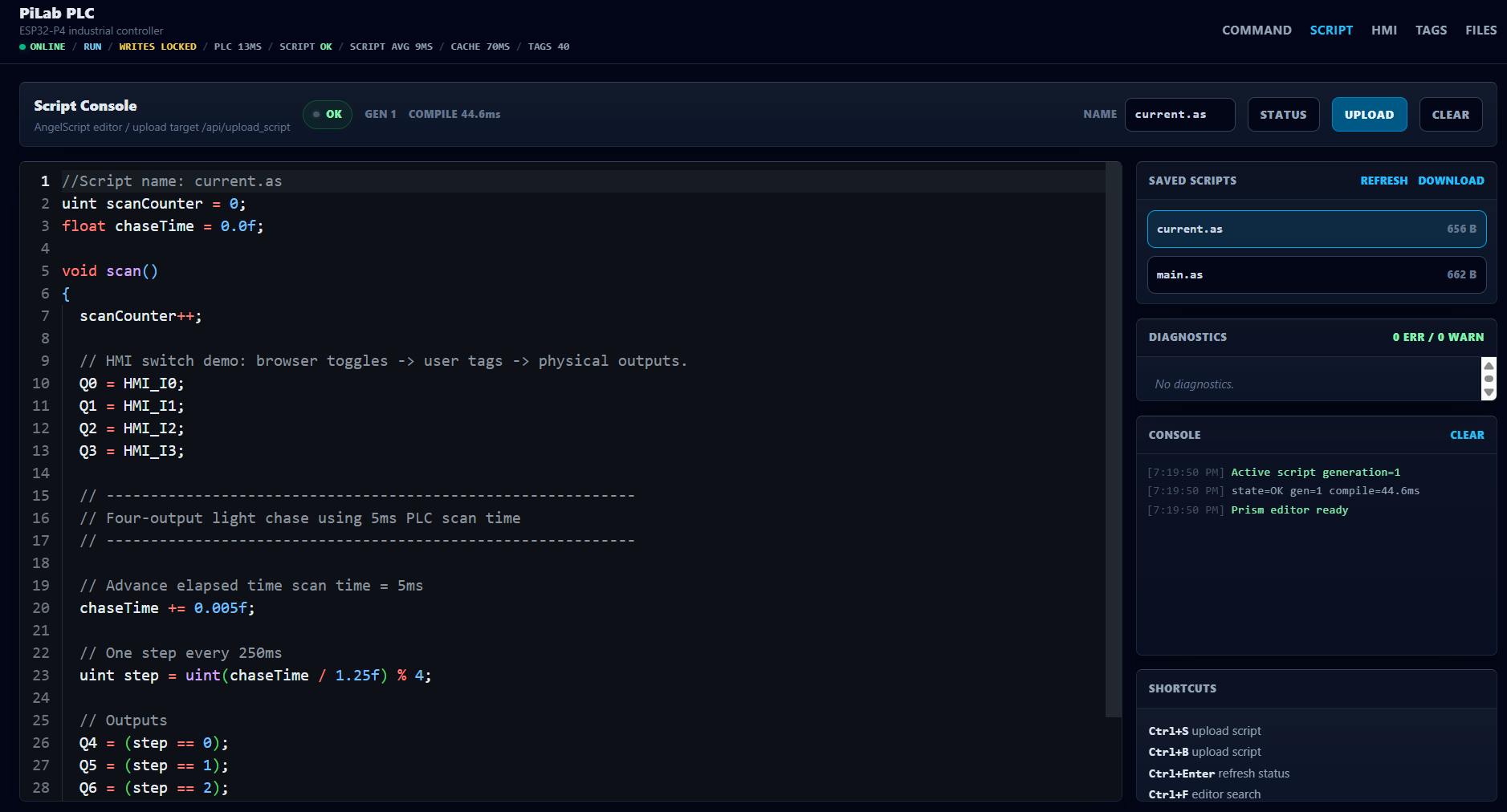

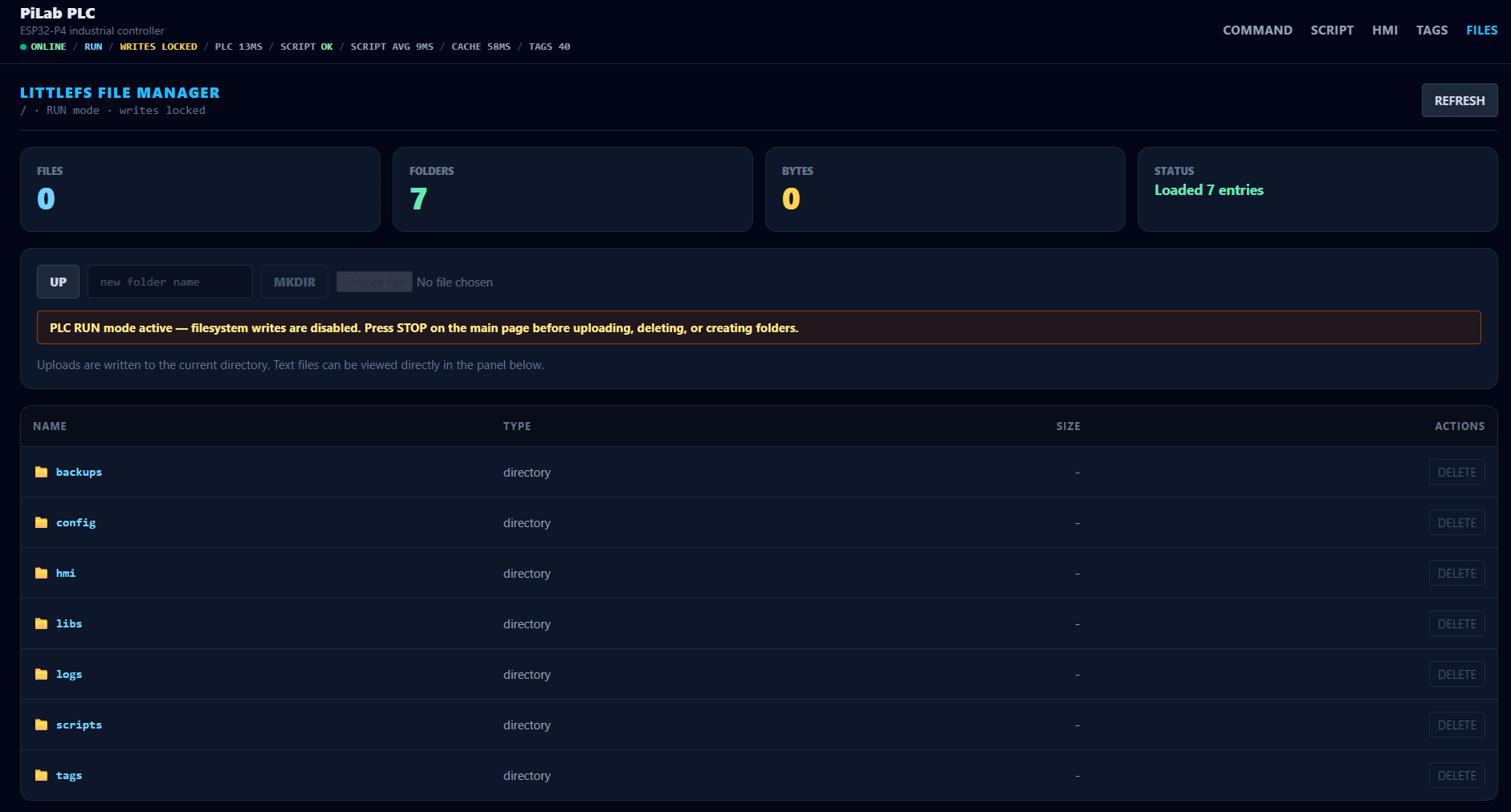

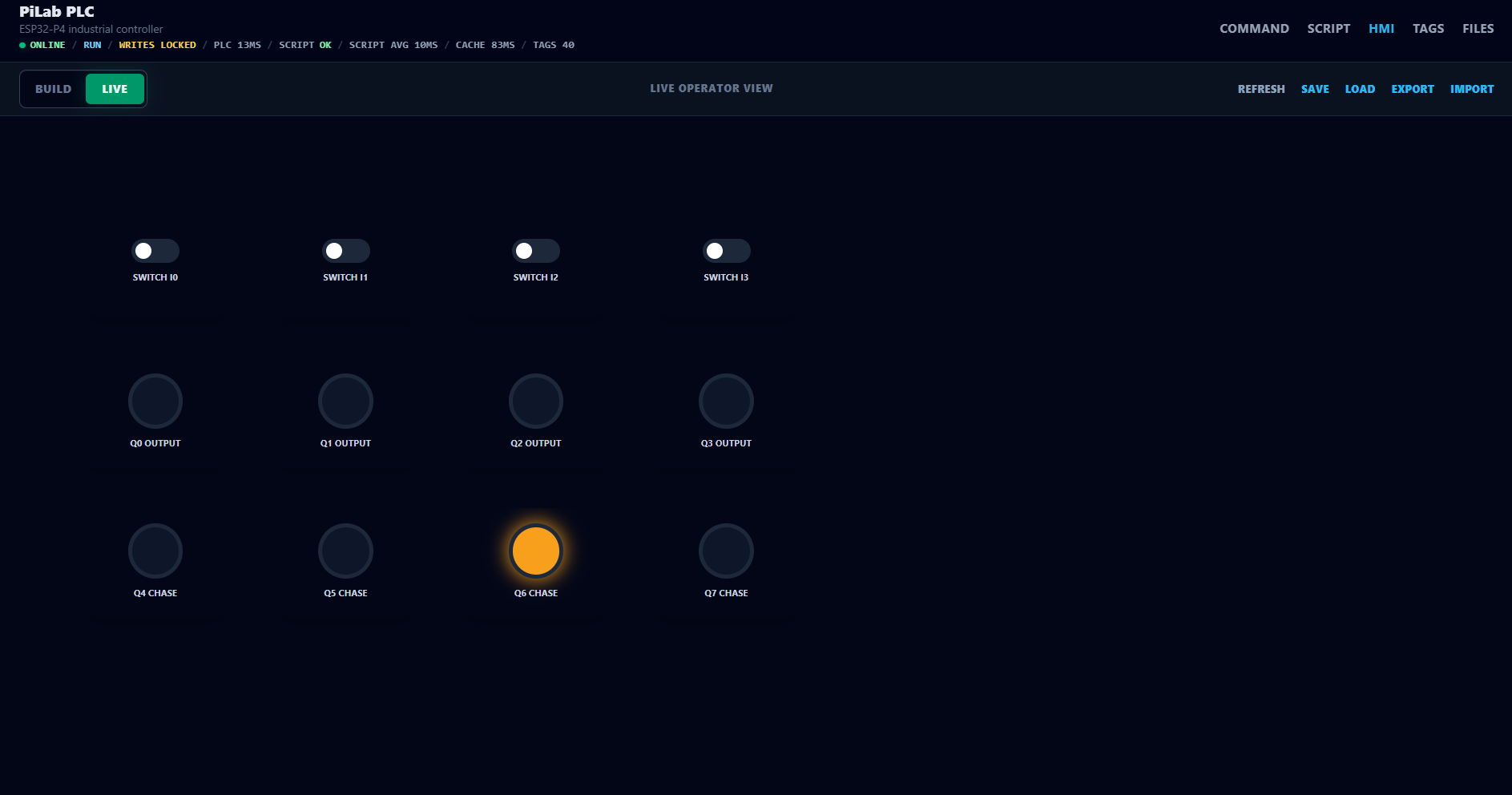

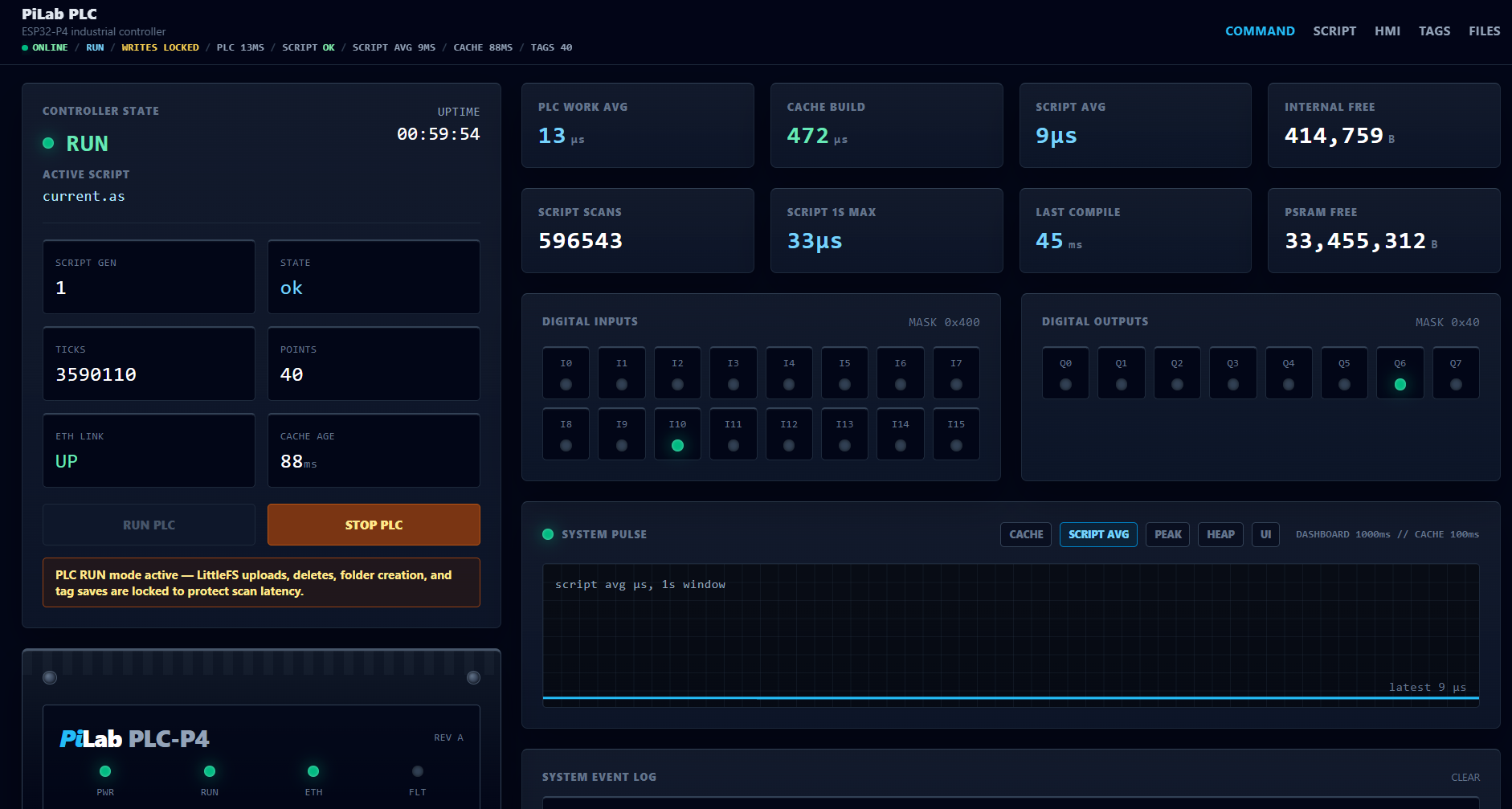

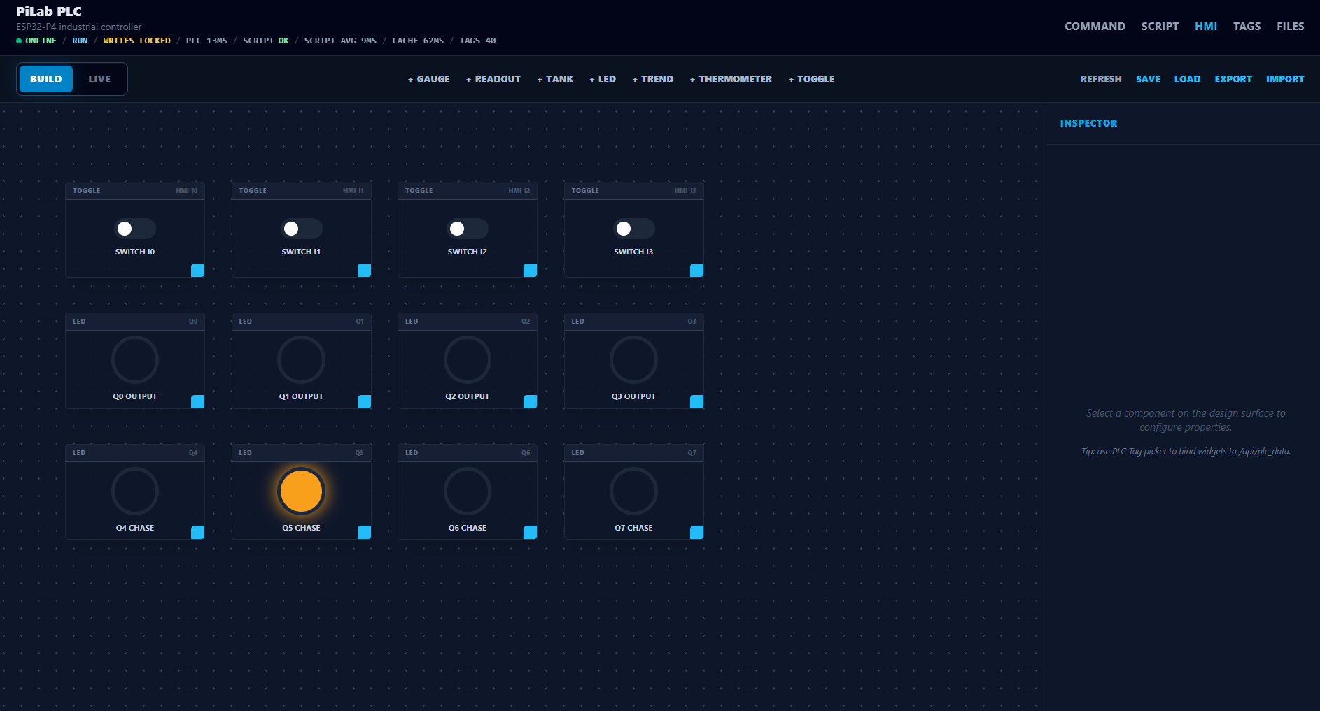

ESP32-P4 PLC/HMI Edge Controller Gallery
