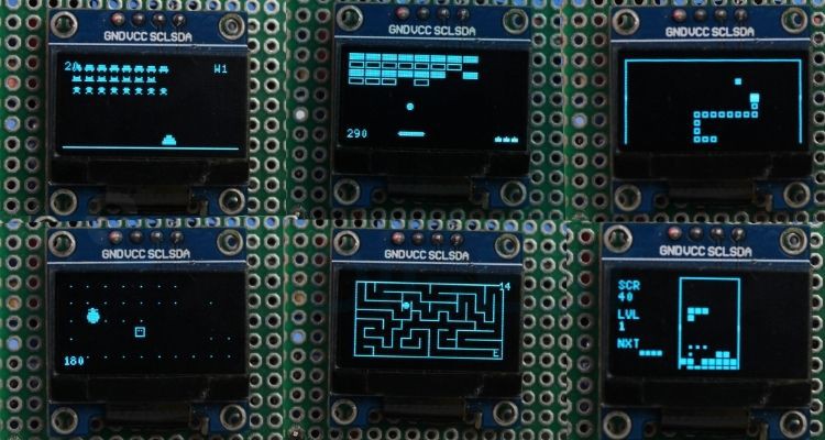

Included Games
This console ships with ten games inspired by arcade classics:
  1. Snake
  2. Pong
  3. Tetris
  4. Breakout
  5. Flappy Bird
  6. Dino Runner
  7. Pac-Man
  8. Space Invaders
  9. Asteroids
  10. Maze Runner
These are optimised for the limited memory and processing power of the Arduino platform.

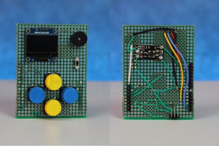

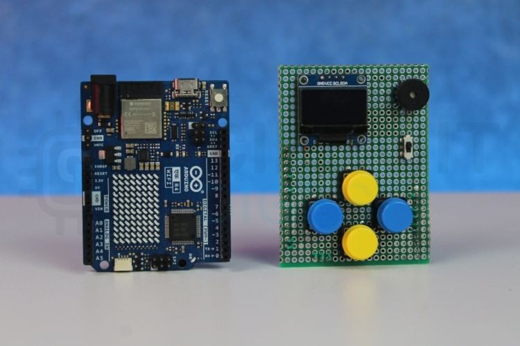

The design is built around a custom perfboard “HAT” that plugs directly onto the Arduino UNO R4 WiFi. This approach keeps the wiring compact and makes the console sturdy enough for everyday use.
Main Components
  • Arduino UNO R4 WiFi
  • SSD1306 0.96-inch OLED Display
  • Four tactile push buttons
  • Active buzzer
  • 3.7V LiPo battery
  • 5V boost converter
  • Slide power switch
  • Perfboard

Display and Audio
The console uses the U8g2 library to drive the OLED display. This library offered better compatibility with the UNO R4 than the more commonly used Adafruit GFX stack.
A simple buzzer adds sound effects for menu clicks, collisions, and scoring events.

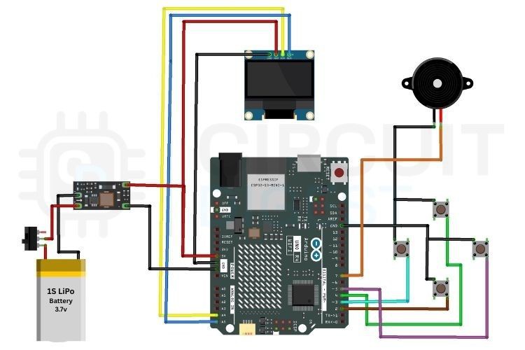

Power System
To make the console fully portable:
  1. A single-cell LiPo battery supplies 3.7V.
  2. A boost converter raises this to a stable 5V.
  3. A slide switch controls power.
This setup allows several hours of gameplay in a compact package.

Build Notes
A custom perfboard layout was used instead of a breadboard to keep the design portable and durable.
Helpful assembly tips:
  • Use female headers for easy removal
  • Verify the boost converter outputs exactly 5V
  • Insulate battery connections with heat shrink
  • Keep wires short to reduce noise
