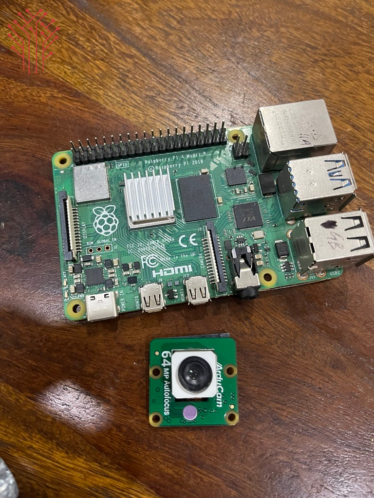

  • Raspberry Pi 4 Model B
  • Arducam Camera Module / USB Webcam

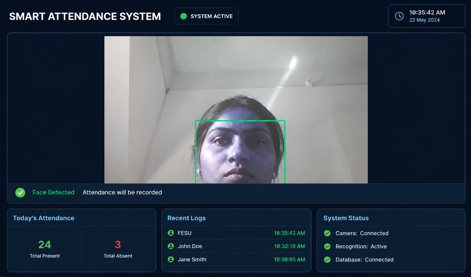

Step 2 — Face Detection
The system scans each frame and detects human faces using computer vision algorithms.
Detected faces are highlighted using bounding boxes on the screen.

Step 5 — Attendance Marking
Once a valid match is found:
  • User name is displayed
  • Attendance is marked automatically
  • Date and time are recorded
  • Duplicate entries are prevented
Attendance data is stored in CSV/database format.

3. Connect Camera Module
Attach the camera module to the CSI port or connect a USB webcam.
Enable the camera interface if required.
