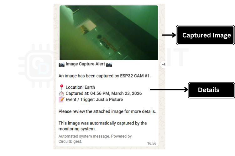

  2. Captures a JPEG image.
  3. Uploads the image to a web service.
  4. Sends a WhatsApp message containing the image link.

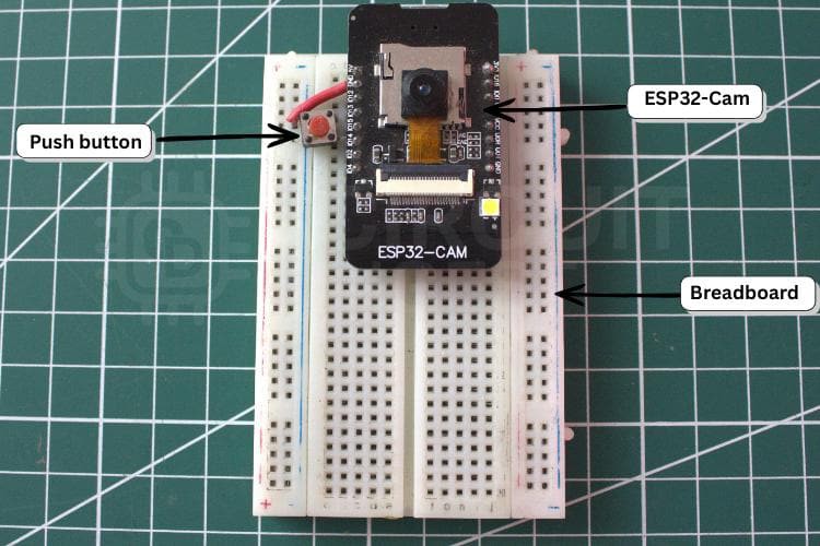

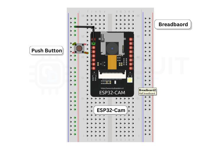

Hardware Required
  • ESP32-CAM
  • USB-to-Serial programmer (FTDI or CP2102)
  • Pushbutton, PIR sensor, or reed switch
  • 5 V power supply
  • Jumper wires and breadboard

The ESP32-CAM includes both a dual-core ESP32 microcontroller and an OV2640 camera sensor, making it ideal for connected imaging projects.
When a trigger is detected, the firmware captures a photo and sends it to a cloud endpoint. The endpoint returns a URL to the image, which is inserted into a WhatsApp message and sent to the configured recipient.
Because WhatsApp supports image previews directly in chat, the alert appears as a rich message that can be opened immediately.
