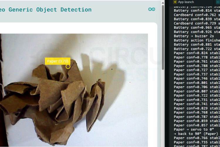

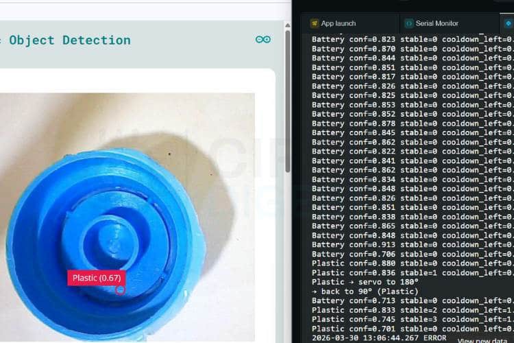

The Python application validates each detection using confidence thresholds and stability counters to avoid false triggers.

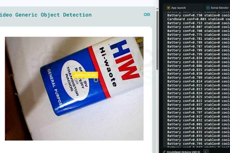

BatteryBuzzer sounds for 2 seconds

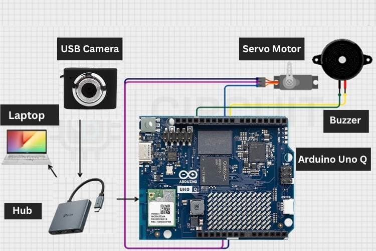

Hardware Used
  • Arduino UNO Q
  • USB webcam
  • SG90 micro servo motor
  • Active buzzer
  • USB hub
  • Jumper wires
  • Cardboard or acrylic frame
  • A laptop for running the Python application

Wiring Summary
ComponentArduino Pin
Servo SignalD9
BuzzerD8
Power5V
GroundGND
The camera connects to the host computer through USB.

The dataset was labelled in Edge Impulse and trained as an object detection model. After deployment, the model runs in real time and outputs class labels and confidence scores.
To improve reliability:
  • Confidence threshold: ~82%
  • Battery threshold: ~88%
  • Stable detections required across multiple frames
  • Cooldown periods prevent repeated actions

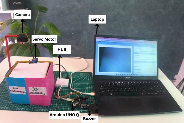

Build Notes
The prototype bin was constructed from cardboard, making it inexpensive and quick to iterate.
The servo acts as a diverter gate:
  • Left position: biodegradable items (paper/cardboard)
  • Right position: plastic
  • Neutral: waiting state
Batteries are not dropped automatically; instead, the buzzer alerts the user to remove them for safe disposal.

During testing, the system reliably sorted well-lit objects presented one at a time.
What worked well:
  • Stable multi-frame confirmation reduced false positives
  • Servo sorting was repeatable
  • Battery alerts were highly effective
