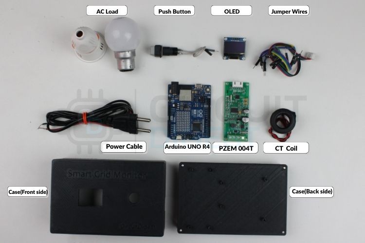

Hardware Requirements
ComponentsPurpose
Arduino UNO R4 WiFiMain controller with built-in Wi-Fi

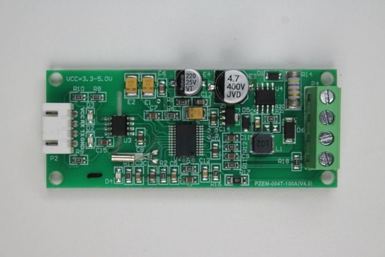

PZEM-004T v3.0AC energy meter with Modbus interface
Current Transformer (CT)Non-invasive current measurement
SSD1306 OLED DisplayLocal readout
Push ButtonDisplay mode selection
ThingSpeakCloud dashboard
3D Printed EnclosureSafe and clean packaging

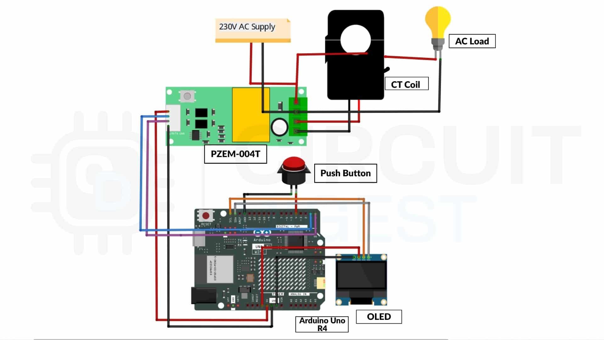

How It Works
The project follows a simple edge-to-cloud architecture.

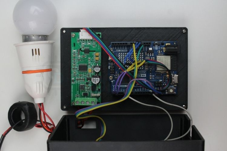

  1. The PZEM-004T measures electrical parameters directly from the mains.
  2. The Arduino UNO R4 WiFi reads those values over Modbus RTU.
  3. Data is displayed on the OLED.
  4. The same values are uploaded to ThingSpeak using Wi-Fi.
  5. Historical graphs are generated automatically.
This provides both instant local feedback and long-term cloud logging.
System Architecture
AC Mains
PZEM-004T + CT Clamp
   │  (Modbus UART)
Arduino UNO R4 WiFi
   ├── OLED Display
   └── ThingSpeak Cloud

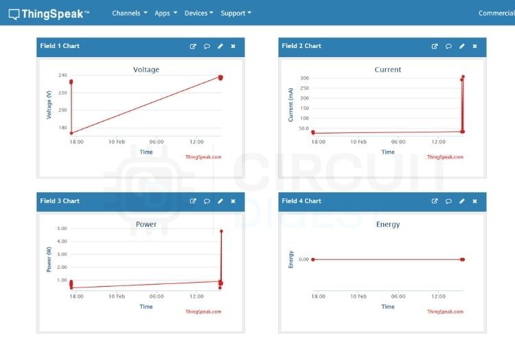

Cloud Dashboard
ThingSpeak stores the uploaded data and plots it automatically.
This enables:
  • Daily and weekly energy trends
  • Voltage fluctuation analysis
  • Startup current spike observation
  • Efficiency monitoring
Viewing the graphs over time reveals patterns that are impossible to spot from a single utility bill.
Real-World Observations
Testing the project on household loads produced some interesting results:
  • Refrigerators showed sharp inrush current spikes
  • Power supplies caused noticeable power factor changes
  • Voltage dipped slightly during heavy load switching
  • Energy usage increased exactly as expected over time
These observations make the project both educational and practical.

Enclosure Design
To make the project deployment-ready, all electronics were installed inside...
