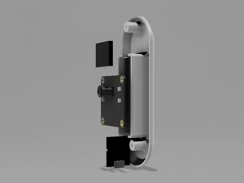

    CAD Design
    The first step of this project was designing the complete enclosure and internal structure of Sentra. I created all the parts from scratch in Autodesk Fusion 360, focusing on clean curves, compact dimensions, proper component clearances, and easy assembly.
    Since this camera is designed to be portable and battery-powered, I wanted the body to feel minimal, modern, and product-like rather than looking like a typical DIY electronics project, while keeping the overall design slim and clean.

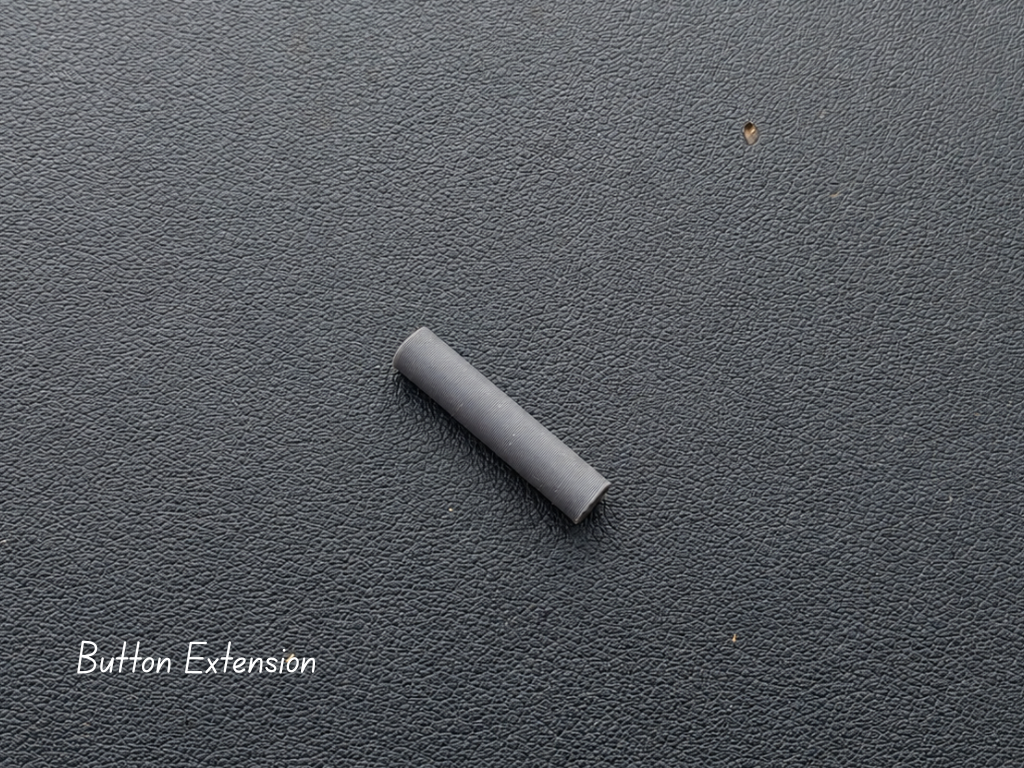

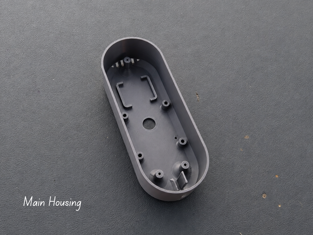

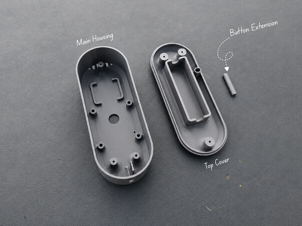

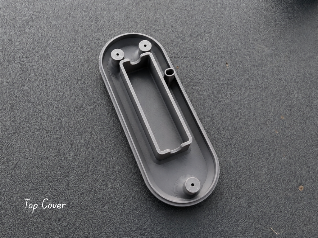

    Once the CAD design was completed, the next step was printing all the enclosure parts. The design consists of three main printed components:
    1. Main Housing
    2. Top Cover
    3. Button Extension
    For this build, I chose a gray PLA filament because it gives the camera a clean and modern product-like appearance while still being easy to print with high dimensional accuracy. PLA is a good choice for achieving smooth surface quality and maintaining the tight tolerances needed for proper assembly.

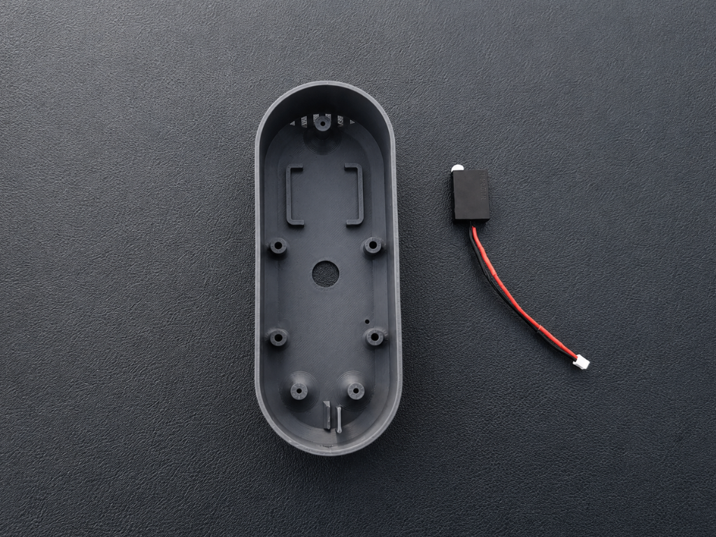

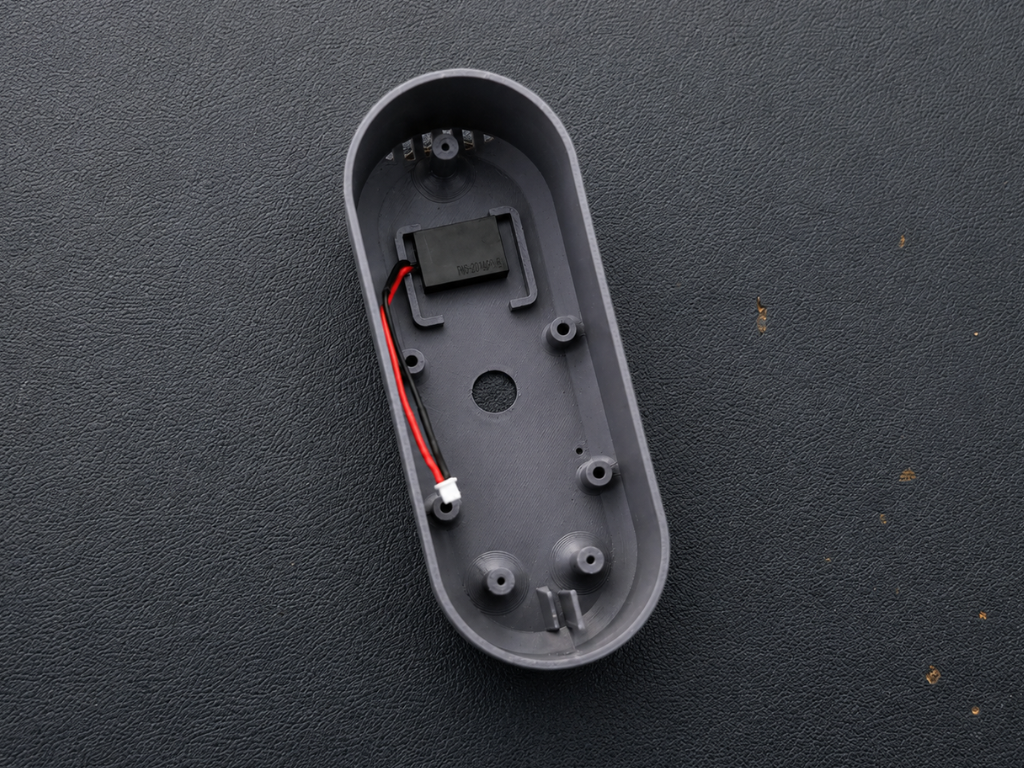

    Spekar Assembly
    The next step was installing the speaker inside the enclosure. I first trimmed the speaker wires to a suitable length and added a little extra wire to make the final assembly easier and cleaner.
    After that, I removed the adhesive backing from the speaker and carefully placed it into the dedicated mounting area inside the main housing. I applied a small amount of pressure to secure it properly in position.
