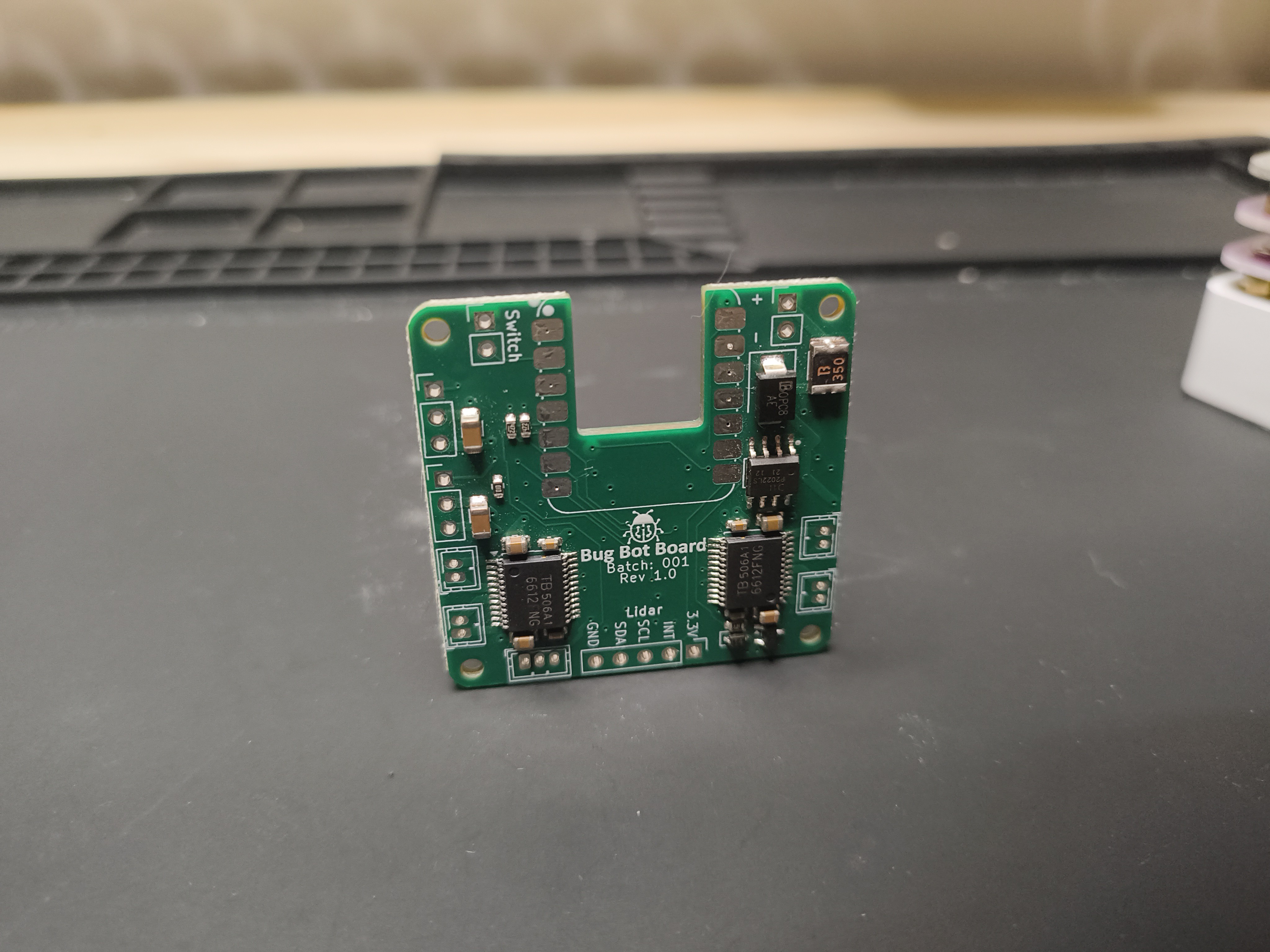

Electronics
Custom 4-layer PCB designed around the ESP32-S3 (dual-core, 240 MHz, Wi-Fi + Bluetooth).
| Subsystem | Implementation |
| Microcontroller | Xiao ESP32-S3 Sense (dual-core, 240 MHz, Wi-Fi + Bluetooth) |
| Drive | 4 × 6 mm coreless brushed motors via TB6612FNG dual H-bridges |
| Servo outputs | 2 × 3-pin headers driven by a PCA9685 PWM controller |
| Vision | On-board camera connector + 8×8 ToF depth sensor (VL53L5CX) |
| Motion sensing | Bosch BNO055 (9-axis) |
| Storage | MicroSD card slot for code and TinyML model storage |
| Power | USB-C charging + on-board Li-ion / LiPo battery management |
| Dimensions | 7 × 7 × 7 cm |
