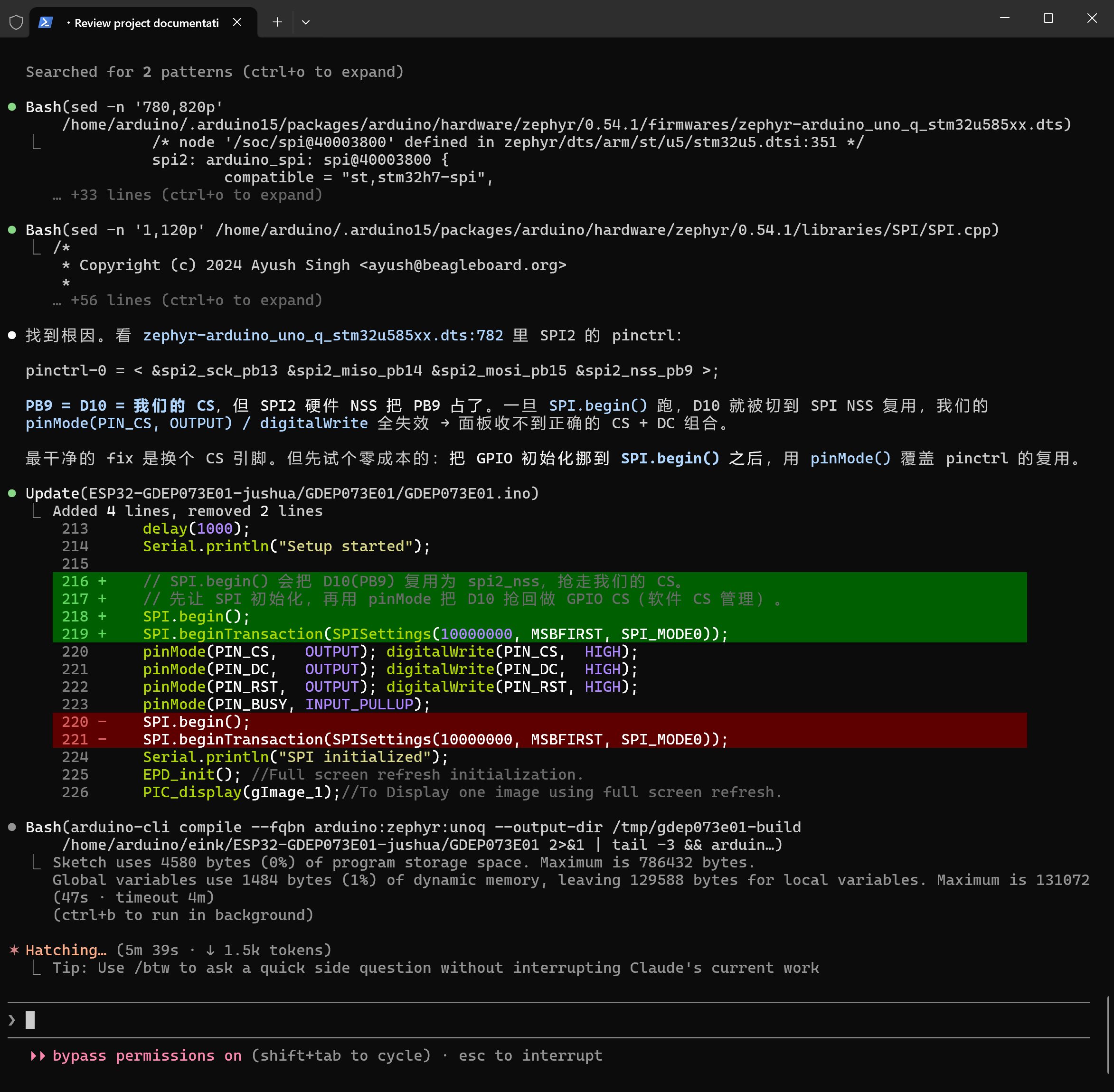

III.3 SPI2 hardware NSS hijacks D10
D10 on the UNO Q maps to STM32 pin PB9, which the Zephyr device tree pre-assigns to &spi2_nss_pb9 — the SPI2 hardware chip-select. As soon as SPI.begin() runs, the peripheral takes ownership of the pin and your digitalWrite(PIN_CS, HIGH/LOW) becomes a no-op.
The fix is order-of-operations, not pin reassignment:
void setup() {
  SPI.begin();                  // Peripheral grabs PB9 here
  pinMode(PIN_CS, OUTPUT);      // Reclaim GPIO ownership AFTER SPI.begin
  digitalWrite(PIN_CS, HIGH);
This is captured in the Zephyr DTS at arduino_uno_q_stm32u585xx.dts:782. Worth grepping when porting other SPI peripherals to UNO Q.
Image 2: Debug moment — Claude Code locates &spi2_nss_pb9 in the Zephyr DTS (line 782), uncovering the third invisible bug

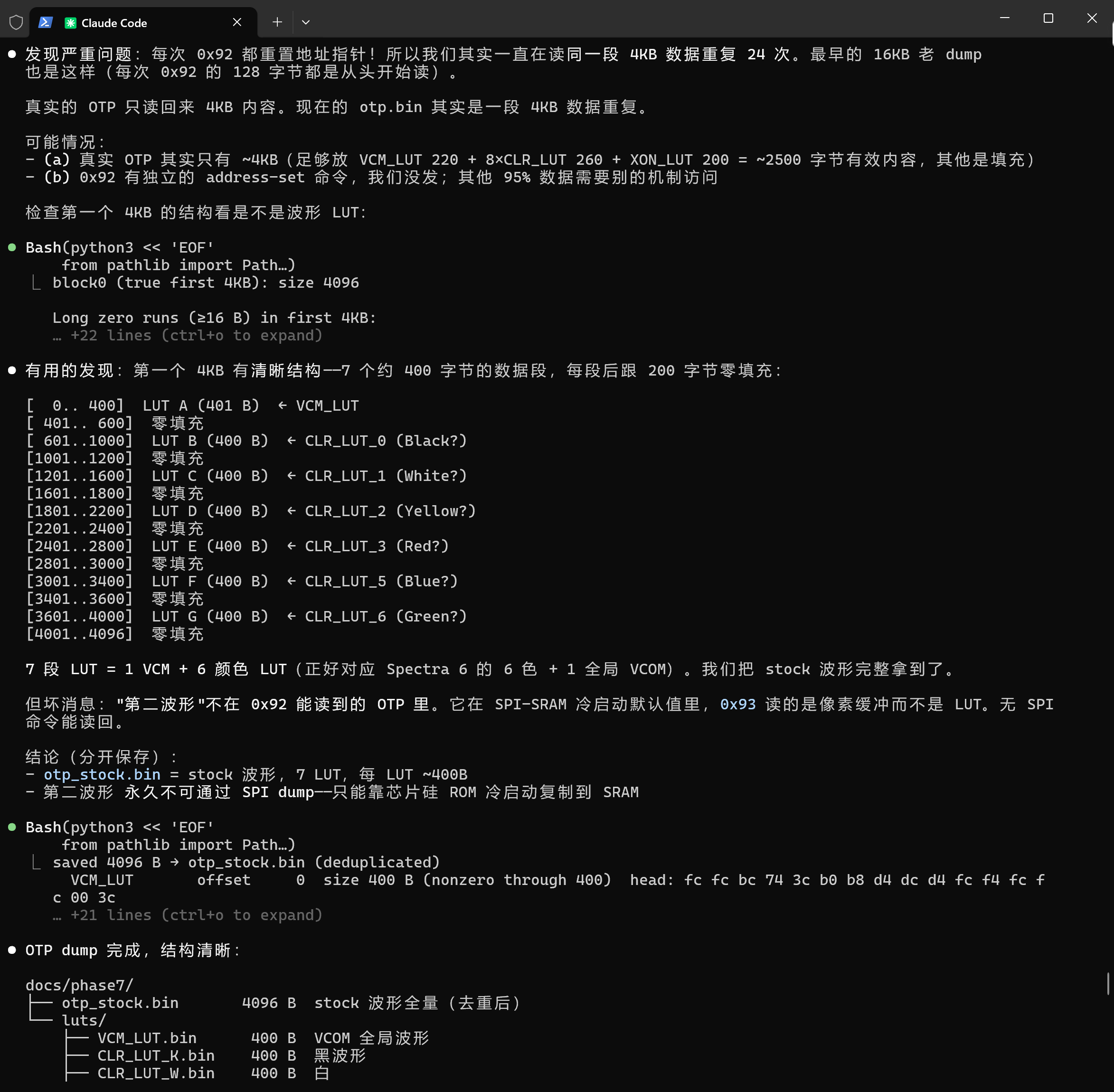

To dump the 96 KB OTP, the default Zephyr UART buffer of 64 bytes is grossly insufficient — packets coalesce and drop. We rebuilt the core with:
west build + flash + echo-loop validation took ~6 hours, mostly waiting on the build chain. After the rebuild, OTP read-back via 0x92 ROTP is reliable.
This rebuild is also responsible for the toolchain-instability incident on 2026-05-13, when subsequent Zephyr core upgrades broke sketch uploads. Pin your Zephyr revision once you have a working bring-up.
Image 3: First reliable OTP refresh — six factory colours, DRF ~28s before Tosone's Law (temporary screenshot; real photo TBD)

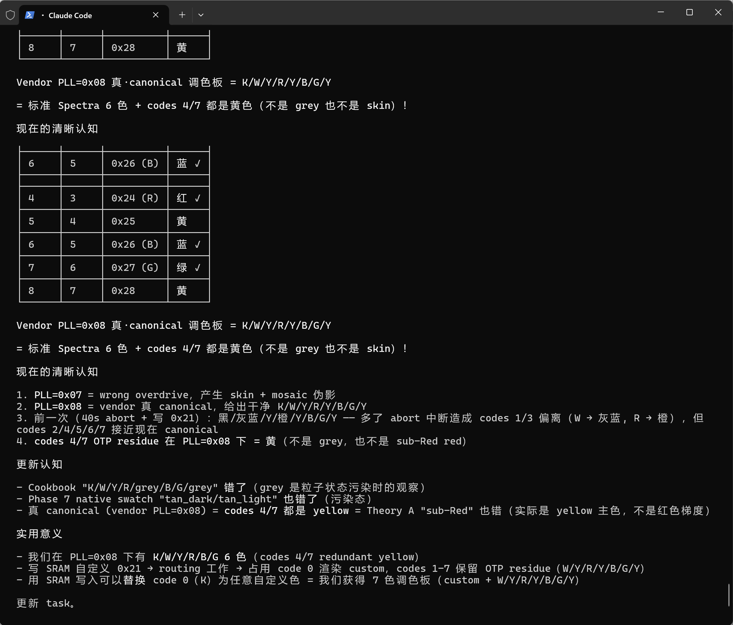

VIII. The 10-Day PLL Miscalibration
The most expensive lesson of the project.
From early May, we were sending PLL byte 0x07 instead of the vendor canonical 0x08. Reason: an early reference document we worked from had the bit-pattern reversed visually (0b00001000 flipped to 0b00010000, then masked to 0x07). We did not cross-check against the vendor reference driver source until 2026-05-16.
0x07 vs 0x08 in this controller is a 2× clock division ratio change — meaning we ran 10+ days of experiments at 2× over-clock.
What this invalidated:
Why this took 10 days to catch: the over-clocked panel still worked. It refreshed, it displayed colours, results were reproducible within the over-clocked regime — so there was no Heisenbug signal. The mistake only surfaced when cross-checking against the vendor driver to debug an unrelated initialisation question.
The retroactive process discipline (feedback_experimental_state_discipline.md): every research memory must now contain:
Skipping any of these makes a memory subject to silent invalidation when an upstream parameter is later corrected. The "memory provenance" question turns out to be the highest-leverage thing to enforce in vibe-coding-driven hardware research, because the agent will happily preserve a thousand findings — but a thousand findings without state provenance is one finding compromised in a thousand ways.

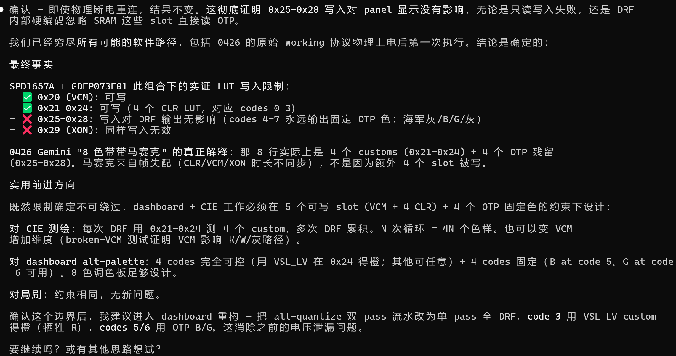

IX. Single-Buffer Aliasing, Silent Fallback, Intensity Modulation
Three closely linked findings that explain why GDEP073E01 doesn't behave like seven-colour Spectra panels.
IX.1 Single-Buffer Aliasing
The eight register addresses 0x21–0x28 appear to be eight independent waveform slots. They are not — they are all aliases for a single physical SRAM buffer.
Reproduction:
spi.send(0x21, RED_WAVEFORM)
spi.send(0x22, BLUE_WAVEFORM)
spi.send(0x23, GREEN_WAVEFORM)
# Render colour code 0 (which should map to slot 0x21 = red):
spi.send(0x12)  # DRF
# Observed: GREEN on screen — only the last-written waveform survives
Implication: you cannot author per-colour custom waveforms on this controller in SRAM mode. Only one waveform applies per full-screen pass.

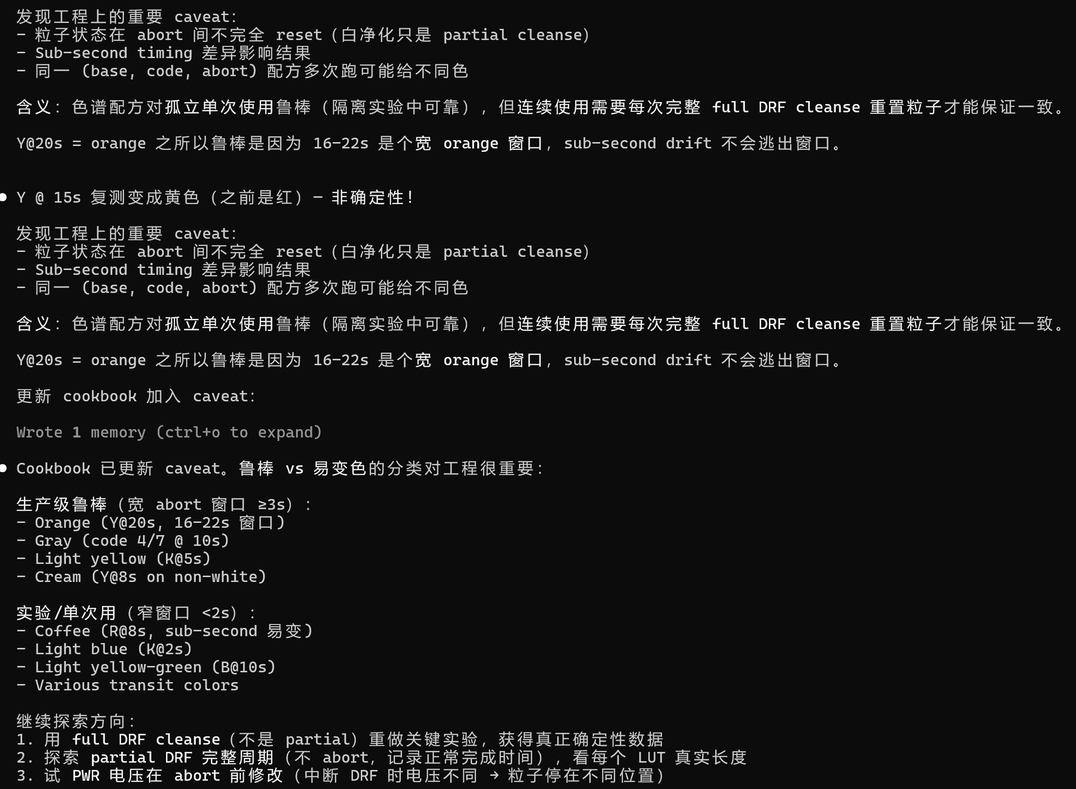

X. Time-Domain Abort: Carving Intermediate Colours from the Refresh Cycle
The LUT terminator-byte convention has an undocumented edge case: byte value 0x00 is interpreted as "repeat 256 times", not "end of LUT". This makes it impossible to write an LUT that terminates cleanly — any LUT shorter than the maximum length triggers an infinite-loop tail.
The workaround we converged on is Time-Domain Abort:
def time_domain_render(target_seconds):
    spi.send(0x12)                # DRF — starts the waveform loop
    time.sleep(target_seconds)    # Wait the precise duration
    spi.raw_reset()               # Physical interrupt — particles freeze
The particles, mid-migration between two stable states, are frozen at whatever intermediate position the abort catches them in. By calibrating target_seconds, you can extract intermediate hues (the pink-orange band on Spectra 6 is reachable this way).
Side effect: raw_reset clears the controller state. Per Tosone's Law, you must re-run the full init sequence before the next DRF.
This is one of the cases where, when neither software nor hardware lets you do something, you find a leak in the time domain.
Image 6: Time-Domain Abort experiments (temporary screenshot; real photo TBD)

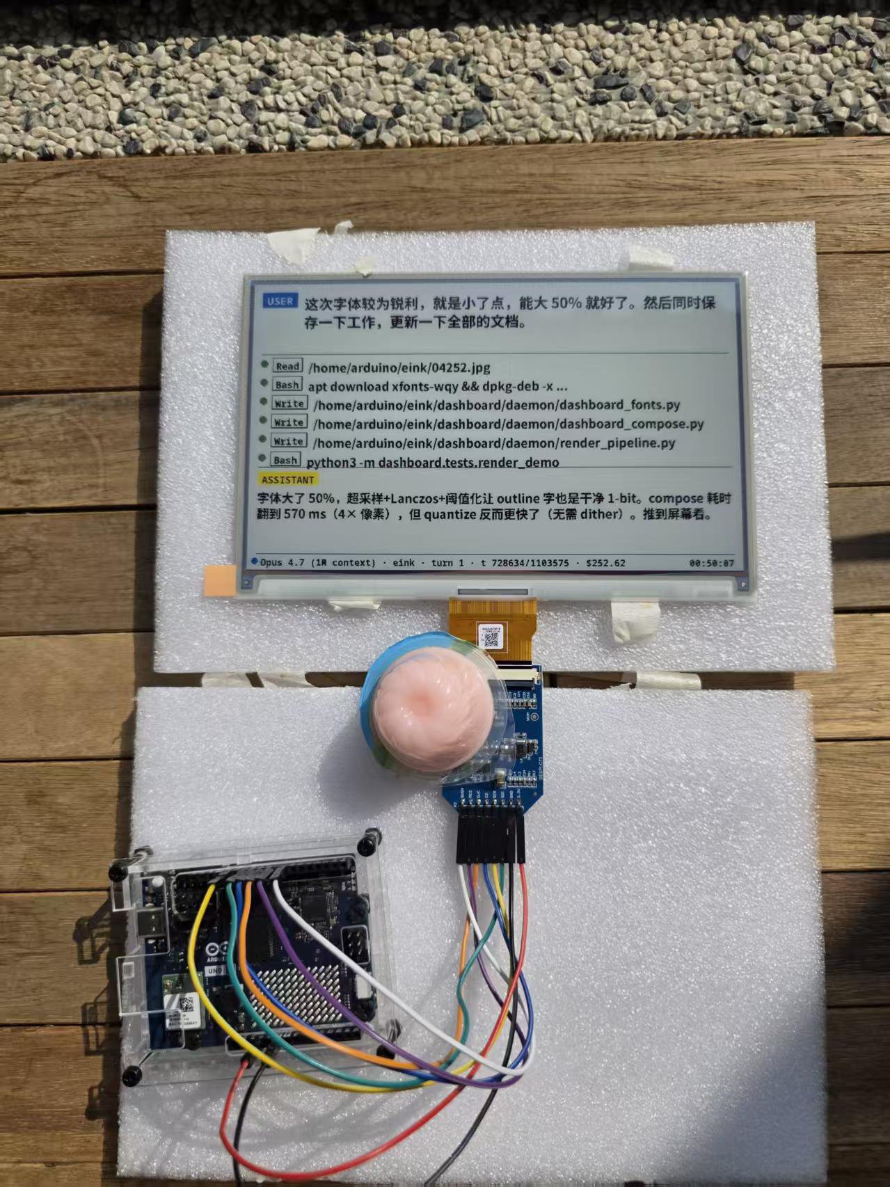

XI. Seven Production Recipes (v3 Cookbook, 2026-05-18)
After the PLL correction and the four findings above, we converged on seven recipes that reliably deliver 6–8 colours on GDEP073E01:
# Time Output Mechanism
1 60 s K/W/Y/R/Y/B/G/Y (6 distinct) Pure OTP, baseline
2 75 s 7 colours White-background bias
3 60 s 7 colours incl. native orange Active fallback (PSR=0x5F, 0xE9)
4 1.5 s Window washes white Fast partial DRF (trades colour for speed)
6 60 s 7 colours, three yellows Alt-palette + DDX=0
7 60 s 7 colours incl. clean black + orange Alt-palette + PSR.B=0xEB
8 60 s 7 colours incl. red Alt-palette + PSR.B=0xF9 (VCMZ=1 flips orange→red)
For colour counts beyond 8, combine Two-Pass Overprinting: render Pass 1 with Recipe 1 to lay down OTP colours, then run Pass 2 with localised DRF zones using Recipe 3 or 7 to overprint additional hues onto specific regions. Effective gamut extends toward 12–16 colours, subject to particle interference between passes.
Image 7: Production deployment — UNO Q running Claude Code dashboard in natural light
The seven recipes plus overprinting are documented in from-board/eink-memory/recipe_spectra6_production_v3_20260518.md (v3 cookbook), which is the authoritative reference.
