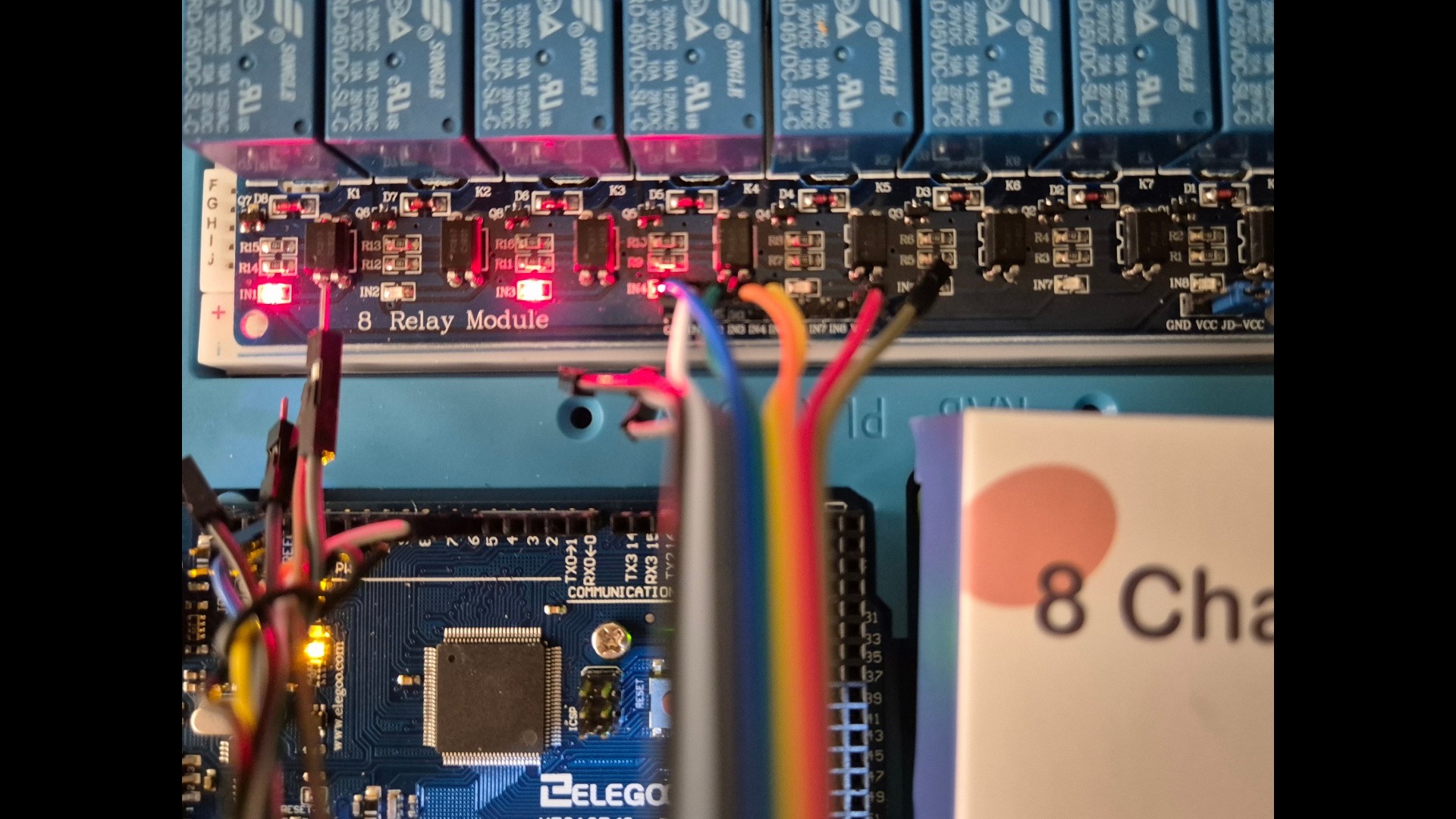

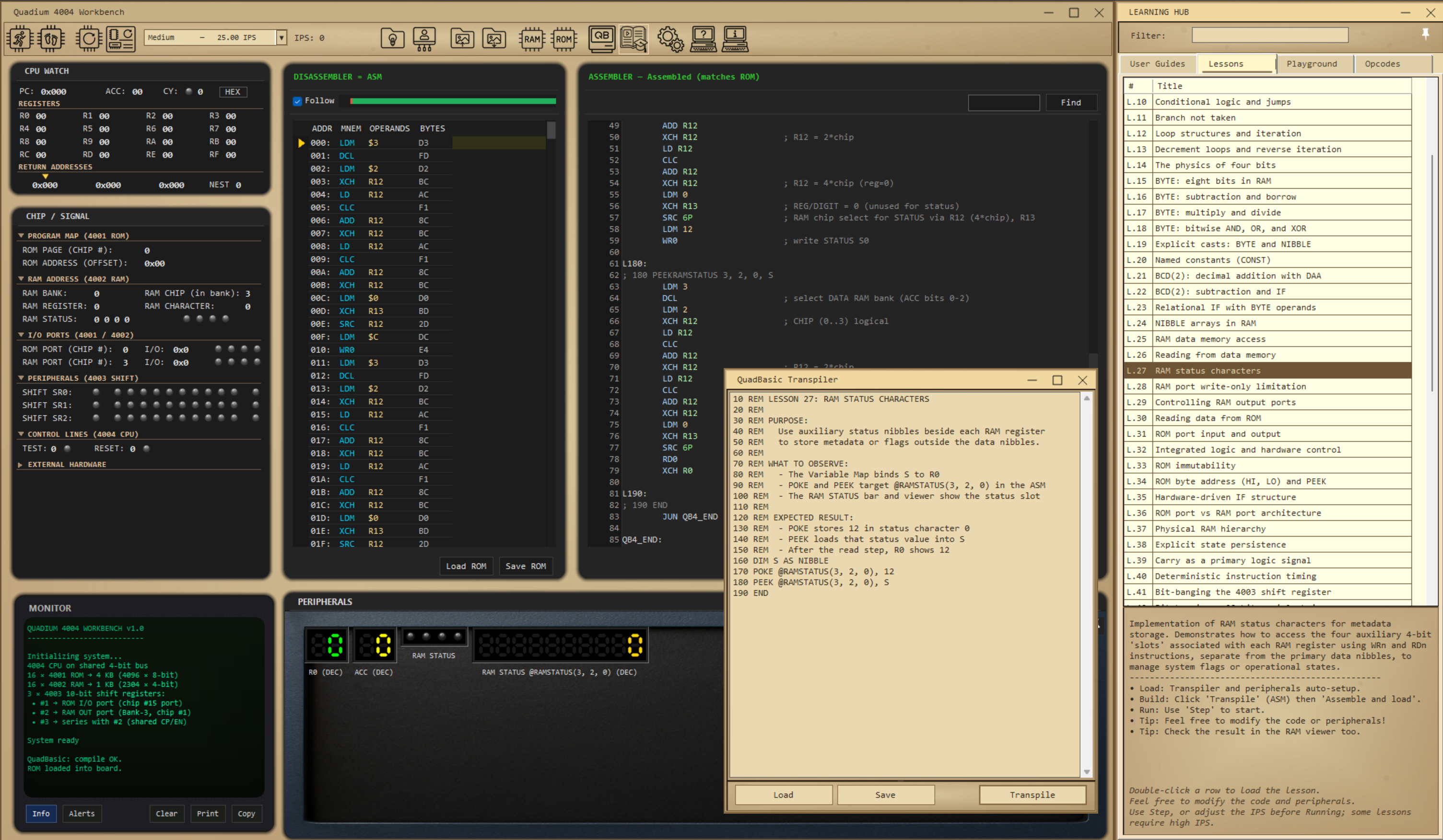

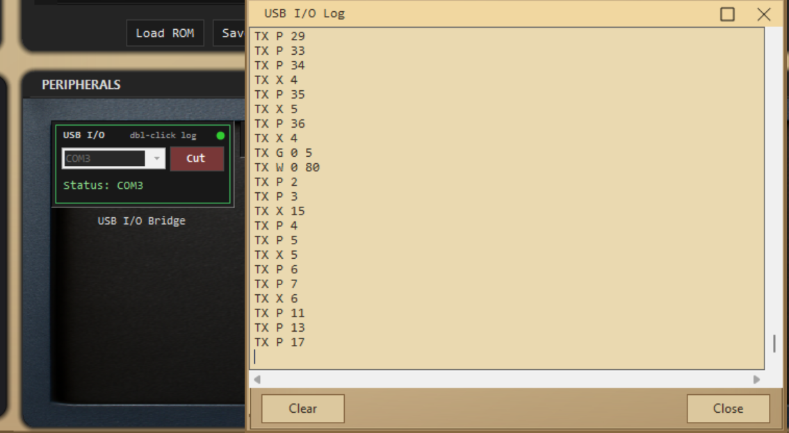

Quadium 4004 Workbench
Educational MCS-4 workbench: 4004 + 4001/4002/4003, peripherals, QuadBasic transpiler, breakpoints and bus inspection.
Quadium 4004 Workbench is a Windows desktop laboratory for learning and experimenting with the historic Intel MCS-4 microcomputer family. It is centered on the Intel 4004 CPU but models a complete system: ROM, RAM, shift registers, inter-chip bus, and peripherals.
- Full MCS-4 topology: 4004, 4001, 4002, 4003, and bus semantics aimed at the historic machine.
- Wired-OR I/O: multiple peripherals on the same port combine like an electrical OR bus.
- QuadBasic: line-numbered 4-bit BASIC that transpiles to Intel 4004 assembly in the same UI.
- Lab workflow: assemble, program ROM, run; disassembly tracks the loaded image.
- Real debugging: breakpoints by PC, single-step, pause, RAM and ROM inspection.
- Peripheral profiles: LEDs, virtual printer, LCD, switches; test patterns without rewriting ROM.
- Machine snapshots: save and restore full CPU, memory, ports, 4003, and bus state.
- Speed control (IPS): from classroom-slow to real MCS-4 rates to stress runs.
- VDP-style 64x48
The Project Story
A personal project of mine. I have always been fascinated by retro-computing and low-level hardware architecture, especially the Intel MCS-4 system. However, modern emulators often rely on high-level abstractions that hide the actual constraints of the era.
Quadium 4004 Workbench is a Windows desktop laboratory designed to learn and experiment with a complete, hardware-faithful system. It is centered on the Intel 4004 CPU but models everything: ROM, RAM, shift registers, inter-chip bus, and peripherals.
Core Features & Architecture
  • Pure Hardware Topology: Replicates the 4004, 4001, 4002, 4003, and the raw bus semantics aimed at the historic machine.
  • Wired-OR I/O: Multiple virtual peripherals connected to the same port combine exactly like an electrical OR bus.
  • QuadBasic Transpiler: A 4-bit BASIC implemented directly in the UI that transpiles to native Intel 4004 assembly. To keep it technically accurate to the original hardware, it lacks modern "magic" like strings or dynamic arrays.
  • Real Debugging: Hardware breakpoints by PC, single-step execution, pause, and full RAM/ROM state inspection.
  • Lab Workflow: Assemble, program the virtual ROM, run, and track the loaded image with a live disassembly view.
  • Visual Layer: An integrated VDP-style 64x48 virtual display processor inspired by the classic TMS9918.
  • Speed Control: Adjustable execution speed (IPS) from classroom-slow up to real MCS-4 hardware rates to stress-test runs.
  • Machine Snapshots: Save and restore the full state of the CPU, memory, ports, 4003, and bus at any cycle.
From High-Level to 4-Bit Reality: Code Transpilation to understand how the QuadBasic transpiler bridges the gap between readable code and raw Intel 4004 constraints, here is a practical compilation example. When you write a single string statement to target the display, the workbench generates the historical MCS-4 assembly architecture, populates the variable maps, maps the CPU registers, and setups the page-F runtime stubs dynamically.
 The Source Input
10 PRINT @SCREEN, "Hi hackaday.io"
20 END
The Transpiled Intel 4004 Assembly (Raw Output)
; ===== Basic4 mini-BASIC => 4004 ASM =====
; R0..R9   : user NIBBLE variables (see Variable Map).
; R10 (T0) : expression temp, logic operand A, JMS results.
; R11 (T1) : expression temp, logic operand B, print char HI.
; R12 (ADR): FIM/SRC address (4*chip+reg); decimal quotient.
; R13 (DIG): FIM digit; print-started flag; PRINTDEC scratch.
; R14 (WLO): wide scalar low nibble (BYTE).
; R15 (WHI): wide scalar high nibble (BYTE).
; BYTE lives in RAM; R14/R15 are a per-statement window.
; System RAM: RAM[3,3,2,*] and RAM[3,3,3,*] (compiler/runtime scratch). Carry @ [3,3,3,0].
; BASIC4 VARIABLE MAP
; #   Name       Type          Storage
; Registers used: none of R0..R9            (10 free)
; RAM used:       0 nibbles
        ORG 0000H
; --- INIT OUTPUT DEVICE @SCREEN ---
        LDM 0                   ; 0=SCREEN
        JMS B4_SETDEV
L10:
; --- SELECT OUTPUT DEVICE (RAM[3,3,3,13]) ---
        LDM 0
        JMS B4_SETDEV
; 10 PRINT @SCREEN, "Hi hackaday.io"
;   char 'H' = 72 (0x48)
        LDM 8
        XCH R10
        LDM 4
        XCH R11
        JMS B4_PRINTCHAR
;   char 'i' = 105 (0x69)
        LDM 9
        XCH R10
        LDM 6
        XCH R11
        JMS B4_PRINTCHAR
;   char ' ' = 32 (0x20)
        LDM 0
        XCH R10
        LDM 2
        XCH R11
        JMS B4_PRINTCHAR
;   char 'h' = 104 (0x68)
        LDM 8
        XCH R10
        LDM 6
        XCH R11
        JMS B4_PRINTCHAR
;   char 'a' = 97 (0x61)
        LDM 1
        XCH R10
        LDM 6
        XCH R11
        JMS B4_PRINTCHAR
;   char 'c' = 99 (0x63)
        LDM 3
        XCH R10
        LDM 6
        XCH R11
        JMS B4_PRINTCHAR
;   char 'k' = 107 (0x6B)
        LDM 11
        XCH R10
        LDM 6
        XCH R11
        JMS B4_PRINTCHAR
;   char 'a' = 97 (0x61)
        LDM 1
        XCH R10
        LDM 6
        XCH R11
        JMS B4_PRINTCHAR
;   char 'd' = 100 (0x64...
  • New Feature: USB I/O Bridge
    Jaime Clot07/19/2026 at 21:19 0 comments
    The new USB I/O Bridge extends Quadium 4004 Workbench beyond software emulation, enabling real-time communication with external hardware through a standard USB Serial (CDC) connection.
    Compatible devices include Arduino Leonardo, Arduino Mega, and virtually any USB CDC device implementing the Quadium USB protocol.
    What can it do?
    • Send CPU register / PC / ACC / carry to external hardware.
    • Send ROM and RAM I/O port state.
    • Receive nibbles from hardware into Quadium ROM ports.
    The USB I/O Bridge makes it possible to build interactive demonstrations, educational projects, laboratory experiments, and custom peripherals using real hardware.
    The protocol is lightweight, easy to implement, and designed specifically for the Intel 4004's 4-bit architecture.
    Drive LEDs, read switches, control displays, or build your own expansion hardware. The USB I/O Bridge provides a simple and flexible way to connect Quadium with the real world.
    Quadium USB I/O — Protocol card
    Link: USB serial · 115200 8N1 · ASCII · one command per line · ends with LF
    Host → device (Quadium sends)
    Line
    Meaning
    R c n
    ROM port chip c (0–15) output nibble n (0–15)
    A c n
    RAM port chip c (0–15) output nibble n (0–15)
    S i b
    4003 shifter index i, 10-bit value b (0–1023)
    P pc
    Program counter pc (0–4095)
    X n
    Accumulator nibble n (0–15)
    Y 0 / Y 1
    Carry flag clear / set
    G i n
    CPU register i (0–15) = nibble n
    W p b
    Register pair p (0–7) = byte b (0–255)
    Q
    Query: report current inputs now
    R…W: only on change. Q: on link / when asked.
    Device → host (board sends)
    Line
    Meaning
    I c n
    Inject nibble n into ROM port chip c (input to the MCS-4)
    This feature is fully integrated and will be available at launch this coming November.
    Thank you for being part of this journey. Watching this project grow has been incredible, and there is even more to come before the release.
    Quadium 4004 Workbench in Steam
View project log
