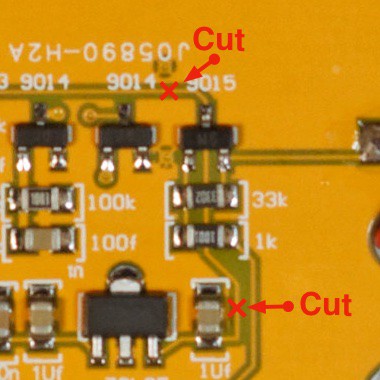

    Cut the PCB Traces
    Locate the 9015 PNP transistor on the bottom of the PCB. This transistor is part of the original power control circuit. Using a sharp knife, cut the traces running from its collector to both the LDO regulator and the voltage divider. This isolates the collector so the boost converter can be inserted in between.
    Note: After cutting, verify the cuts with a multimeter in continuity mode. An incomplete cut will leave the boost converter's output connected back through the trace, which can cause back-voltage on the input and potentially damage the boost converter.

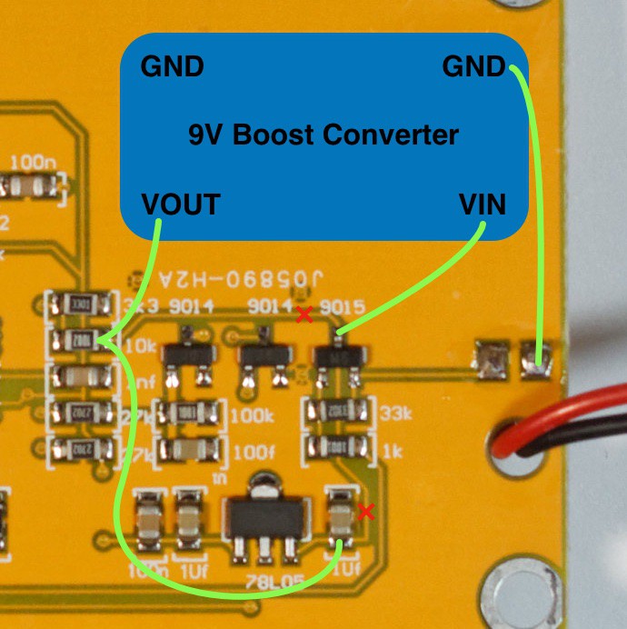

    Wire the Boost Converter
    Wire the boost converter module as follows:
    1. VIN to the 9015 collector
    2. VOUT to the LDO regulator input and the voltage divider
    3. GND to the 9V input negative rail
    Pre-tune the boost converter output to 9V before installation by powering it from a bench supply and adjusting the trimmer potentiometer.

morganflint wrote 8 hours ago point
Won't it be better to choose a lower voltage for the boost converter?
As it's followed by the linear regulator U1, I'd choose the lowest output voltage that provides enough margin for U1 to work, maybe around 6.5-7V (you'll need an adjustable one).
Another (maybe better) possibility is using a 5V boost converter, connecting its output to the output of U1 (if the noise in the output of the boost converter is low enough, so the filtering effect of the linear regulator isn't needed)
