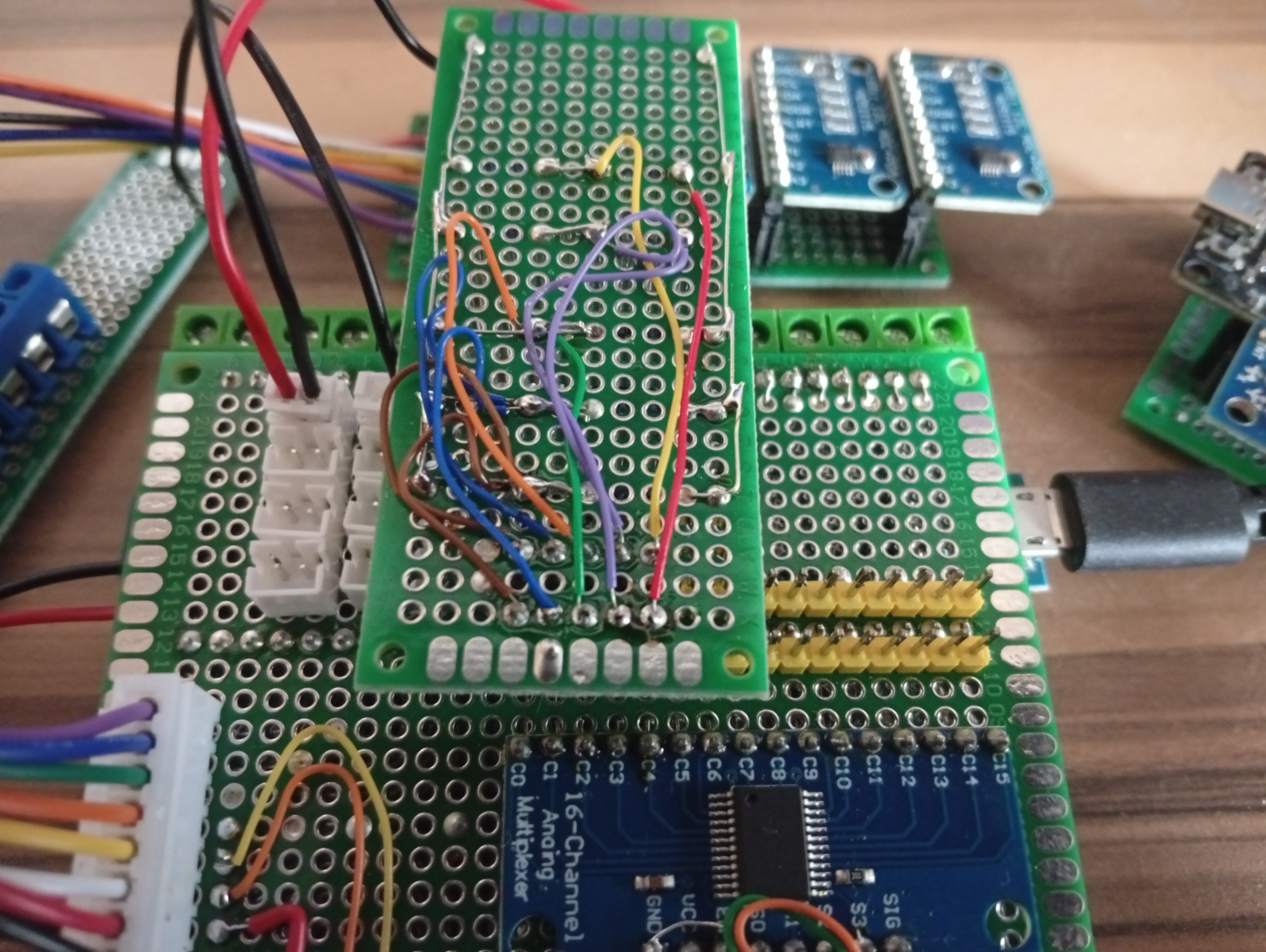

Modular universal marine IO system. Main board with ESP32 + up to 4× ADS1115 + CD74HC4067 MUX (16 channels). All components on sockets – no soldering needed for replacements. Stackable mini-boards per channel (voltage divider, pull-up/down, Schmitt trigger, optocoupler, pulse counter). Fully configurable via JSON. Coming soon as its own repository.

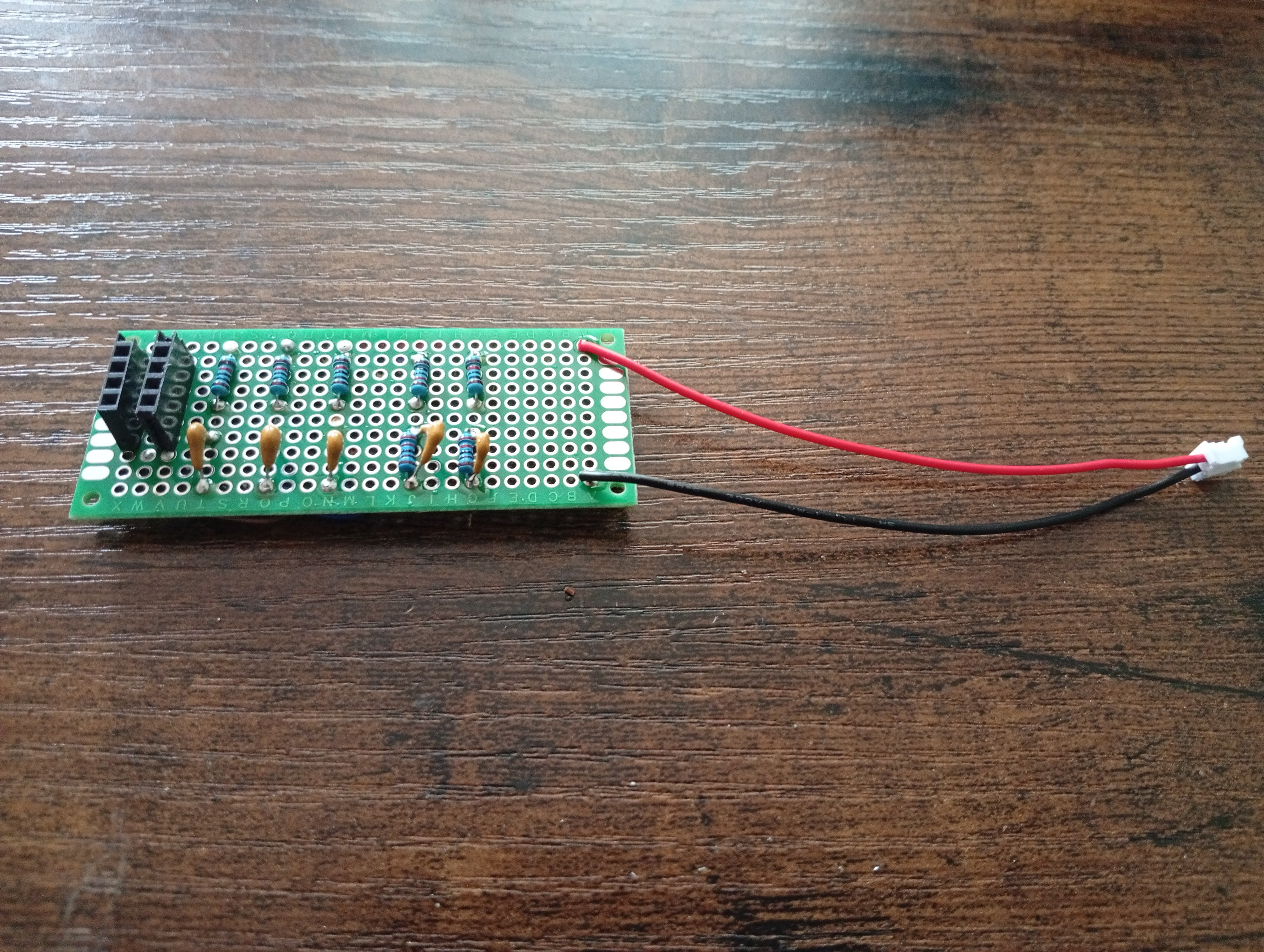

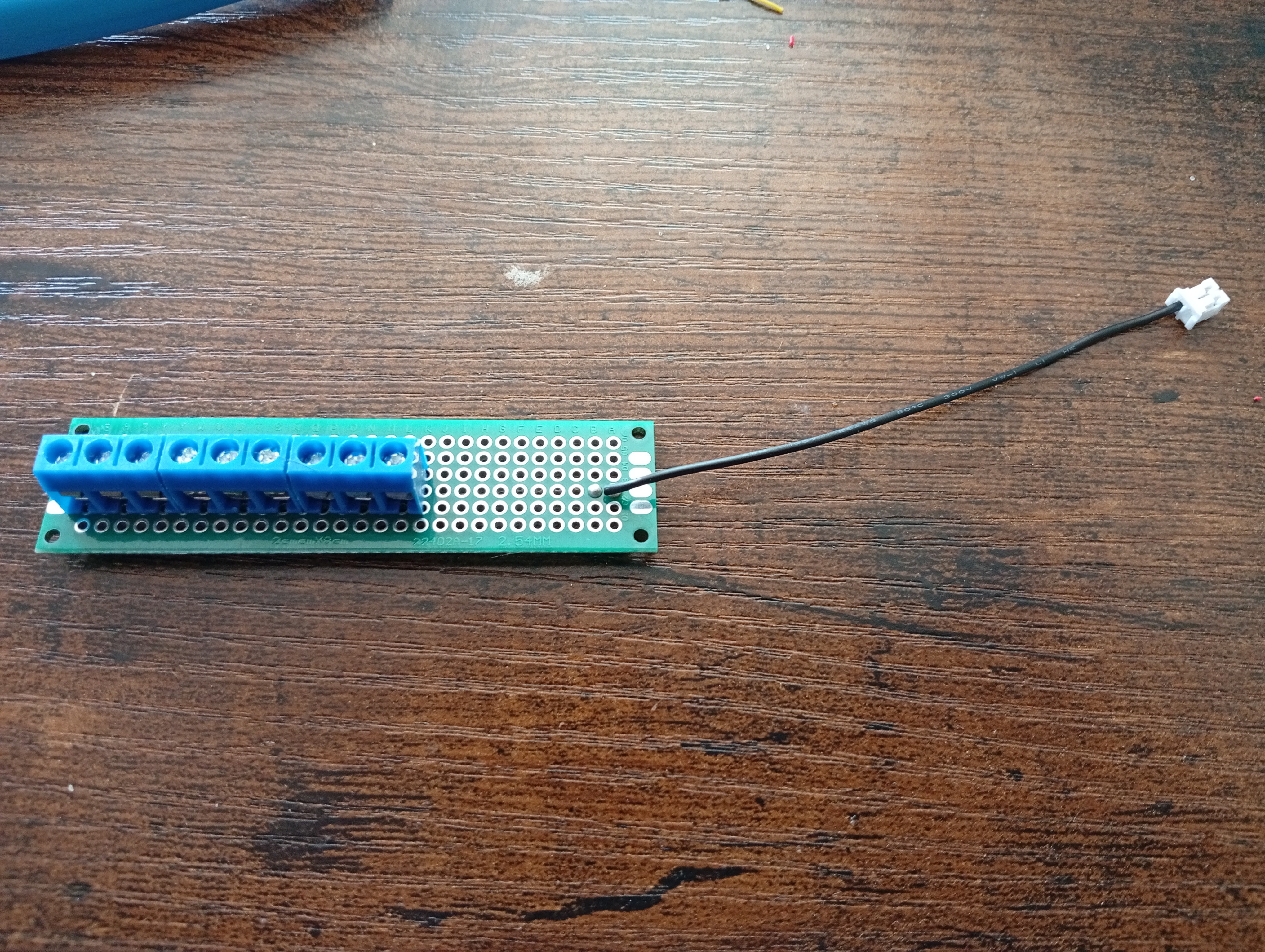

  • BoatOpenIO – First prototype boards ready
    Maik6 hours ago 0 comments
    First mini-boards assembled and plugged in!
    • Multi mini-board with voltage dividers and pull-ups for channels 1-5 – connected via JST 2-pin for VCC/GND and pin headers for signal in/out
    • GND collector board for clean ground routing
    • All plugged into the main board
    The modular concept works – swap a mini-board, change the JSON config, done. No resoldering, no rewiring.
    Next: optocoupler board for RPM (W-terminal) and testing with real VDO sensors on the boat.
