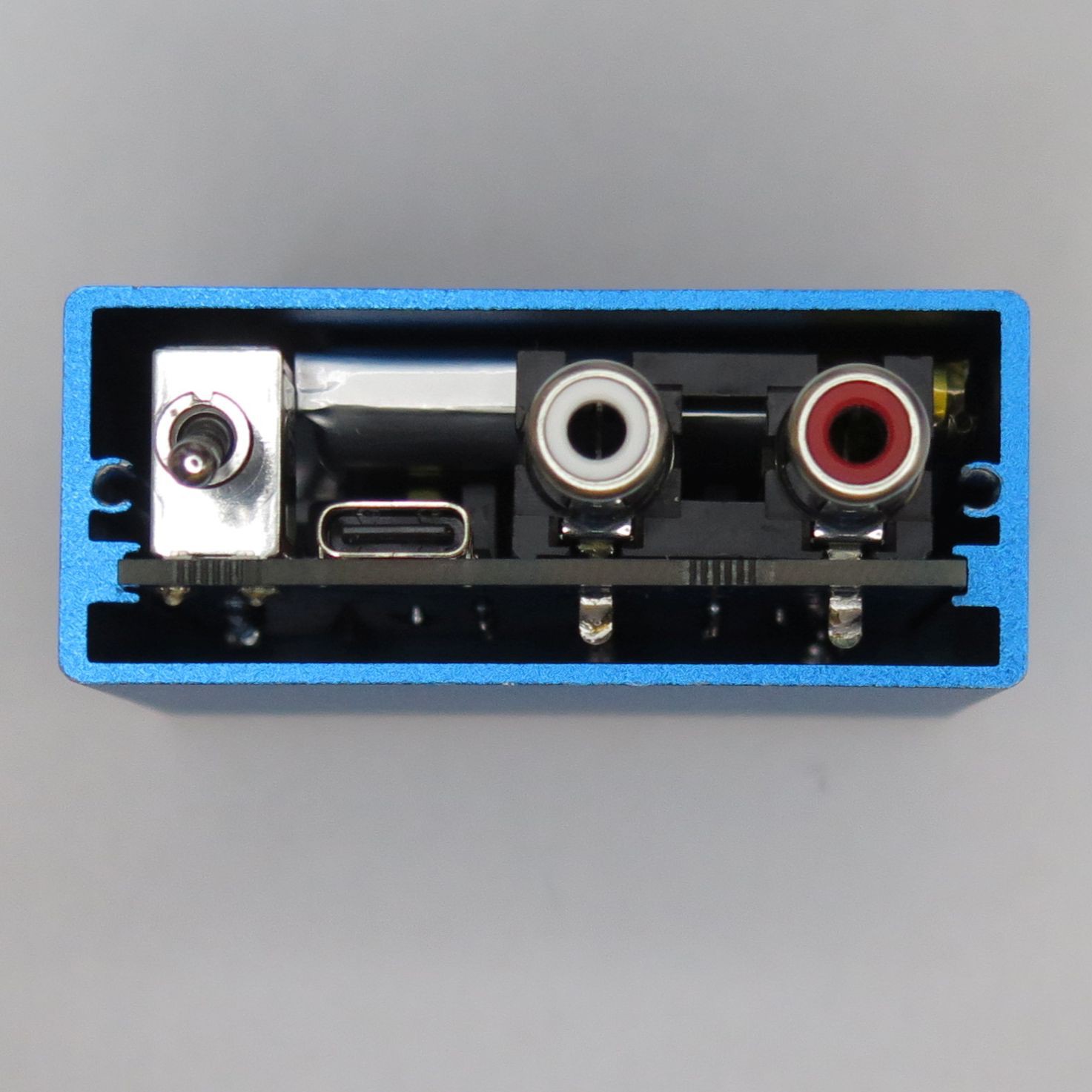

The PHONO-EQ-100 is a finished, cased MM phono preamp measuring about 58 mm x 53 mm x 24 mm. It is designed to run on a Li-Po battery, charged over USB-C, so playback is free of the supply noise that mains power brings. A single 800 mAh cell keeps it running for over 180 hours, long enough to make battery operation genuinely practical, not just a party trick. And while it's priced to be affordable, we didn't cut the corners that matter for sound. There are a handful of deliberate choices inside that you don't usually find at this size, or in this class.

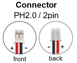

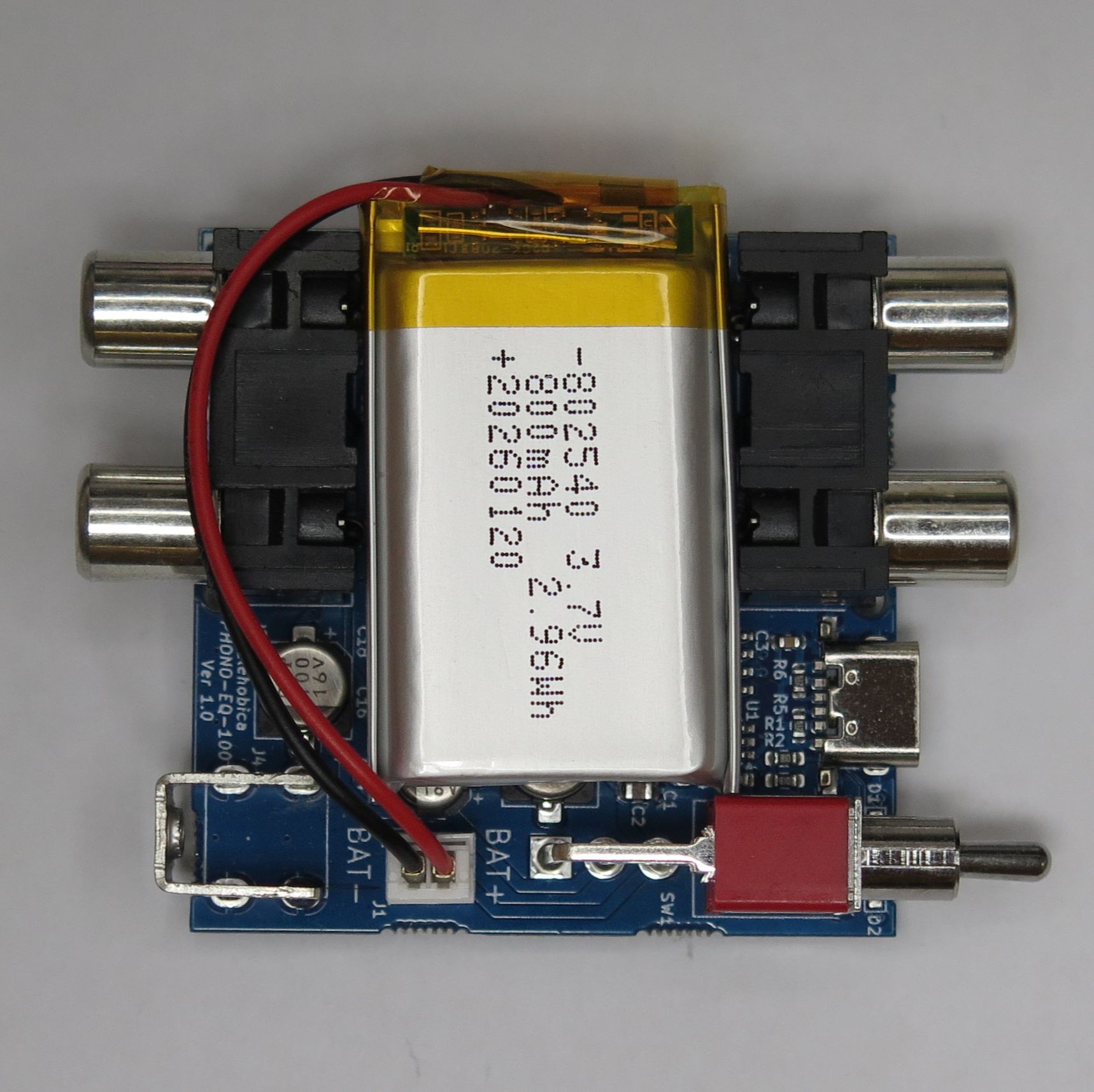

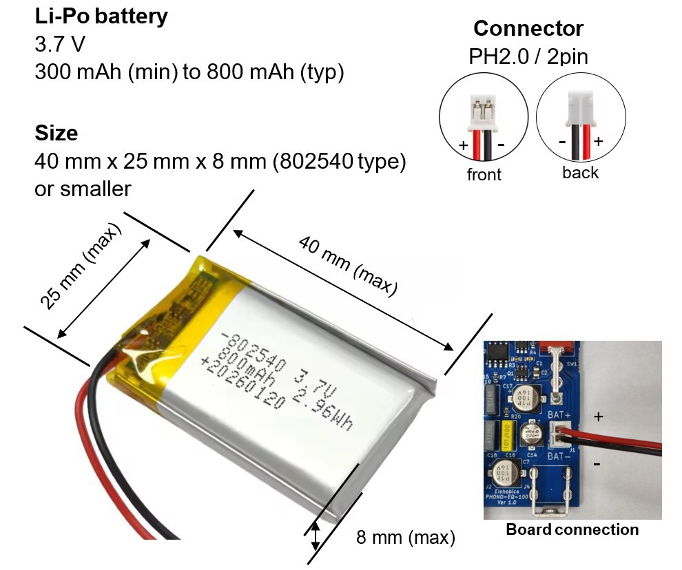

    What the battery needs to be A rechargeable Li-Po cell, 3.7 V nominal. It has to fit inside the case, so 802540 (40 mm x 25 mm x 8 mm) is the largest that goes in, and anything smaller in each dimension is fine. Capacity should be 300 mAh or more, with around 800 mAh being a practical upper size. The connector must be PH2.0 / 2pin, and only PH2.0 / 2pin. Note that PH2.0 also comes in a 3pin version, which will not work here, so check the pin count, not just the connector name.
    Check the polarity (important) First, the connector itself must match. If the battery’s connector is not PH2.0 / 2pin and does not fit the connector on the board, never force it in or try to connect it in any way. Beyond that, polarity is the one thing you must get right. Even with the correct PH2.0 / 2pin connector, the red and black wires are not always wired the same way from one supplier to the next. The plug can fit perfectly and still have reversed polarity, which will definitely cause damage to the battery or the board. Before connecting, check the polarity by its wire color, and if it is reversed, never connect the battery to the board. Do not try to swap the wires by hand: that risks a short circuit. The only rule you follow is to obtain a battery whose polarity is already correct.
    Finding one Stock comes and goes, so it’s better to search by the requirements than to chase a single product. Search terms like “802540 3.7V lipo PH2.0 2pin” are a good starting point. When it arrives, check it once more against the size, capacity, connector shape (PH2.0 / 2pin), and polarity described above.

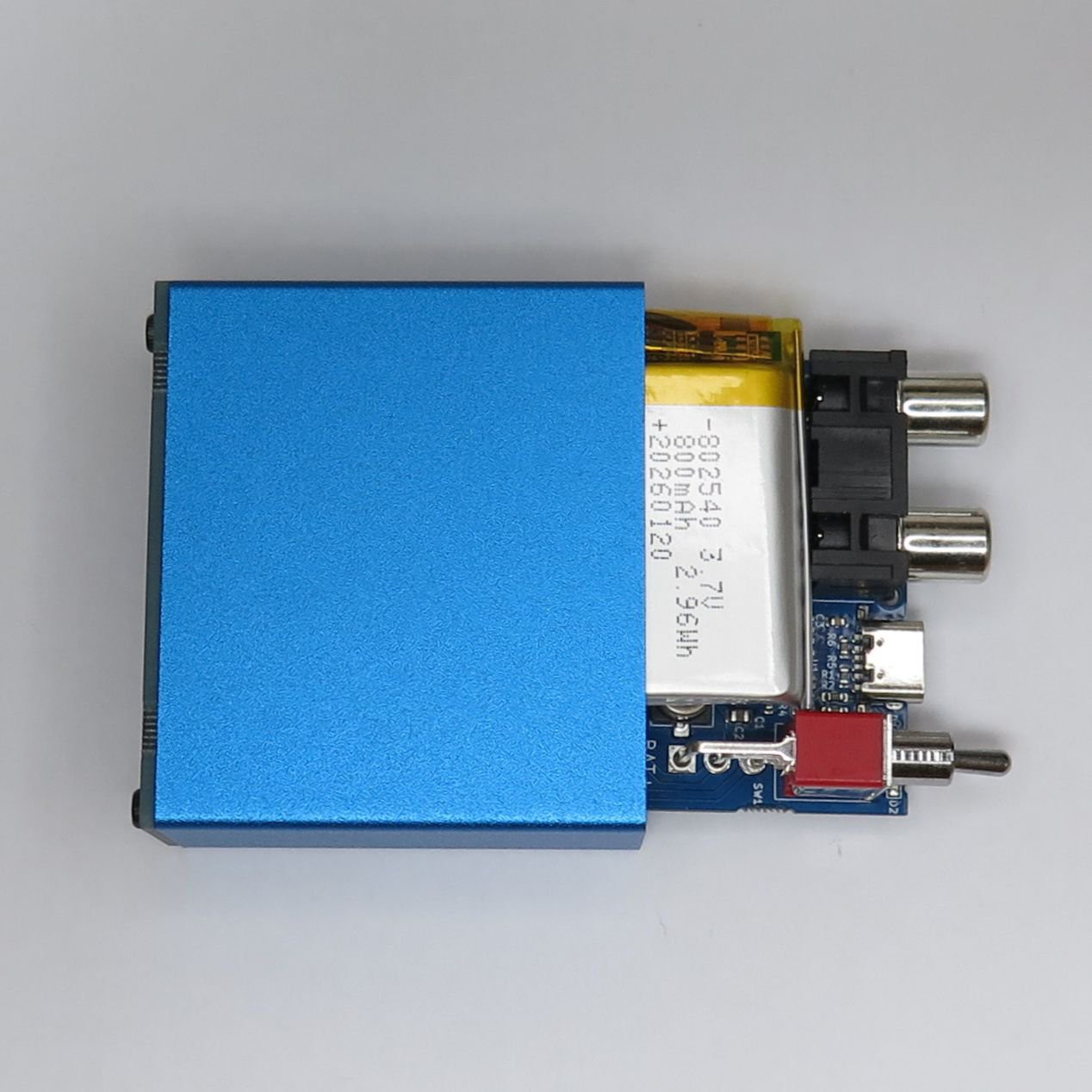

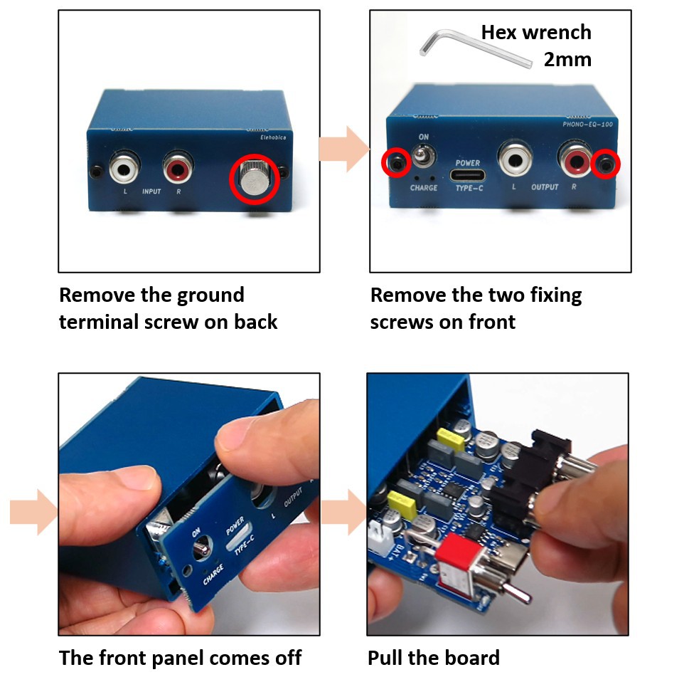

    Opening the case To reach the battery connector, you need to open the case. First, remove the ground terminal screw on the back panel. Then remove the two fixing screws on the sides of the front panel using a 2 mm hex wrench. The front panel then comes off, and you can pull the board out to reach the battery connector inside.

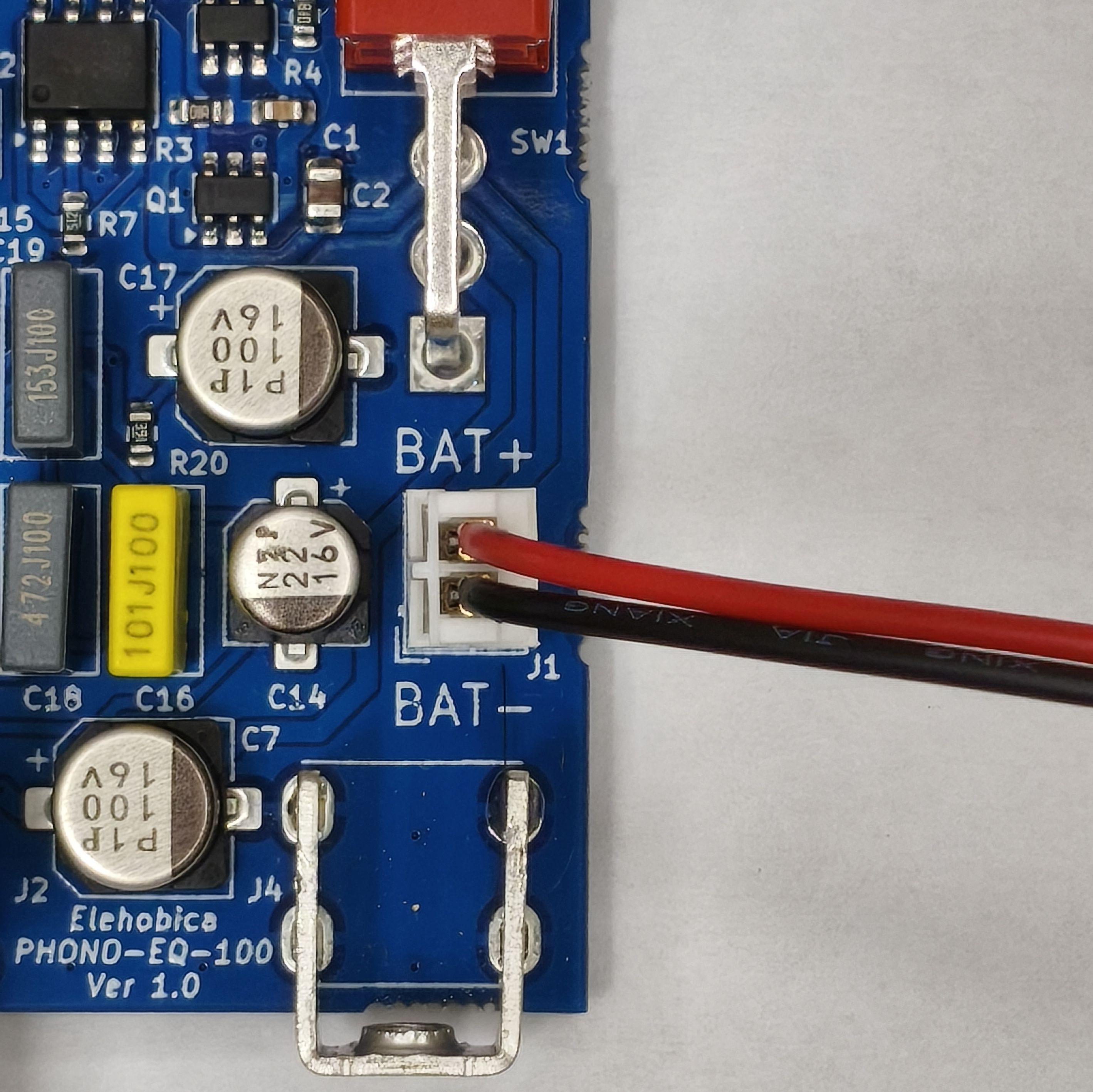

    Connecting it Once the polarity is confirmed, plug the PH2.0 / 2pin connector into the battery terminal on the board with the power switched off. Before use, double-check that the BAT+ and BAT- silkscreen markings on the board correspond to the red and black wires of the battery respectively. If the battery is connected correctly, the red LED will light when charging over USB-C, and the green LED will light when fully charged over USB-C. If instead the LED is blinking, the battery is not connected correctly: check it again, and if the problem is not resolved, disconnect the battery from the connector and stop using it.
