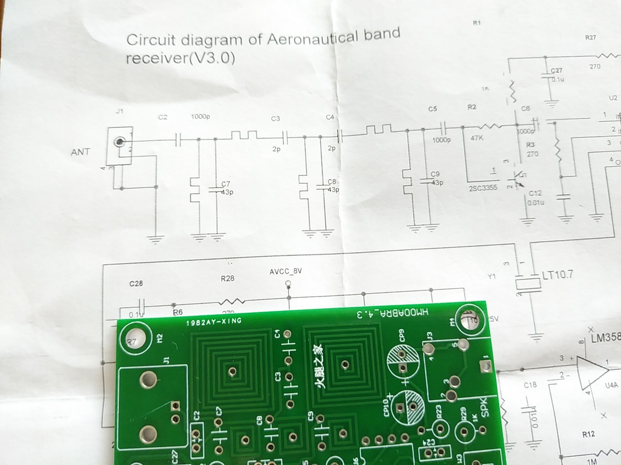

This receiver design has been copied and modified by many manufacturers over the years. At some point, the original air-core inductors were replaced by PCB spiral coils to reduce assembly cost.
https://nobcha23.hatenadiary.com/entry/2026/01/22/234313
At some point in that process, the original air-core inductors were replaced by PCB spiral inductors.

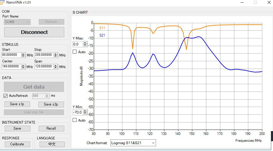

At first glance this seems reasonable. PCB inductors reduce assembly cost and simplify manufacturing. However, the receiver suffered from poor sensitivity, and the front-end filter became a prime suspect.

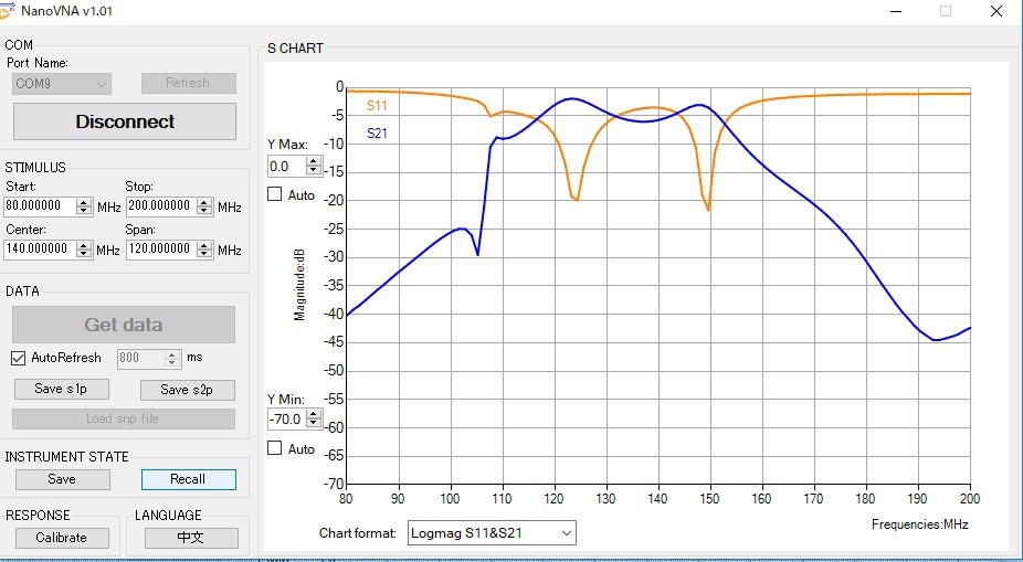

Using a nanoVNA, I measured the filter response and found significant passband irregularities.
By
modifying component values, I was able to flatten the response and improve overall behavior.
At this stage I believed the problem had been solved.

The passband shape had improved, but insertion loss remained much higher than desirable.
This raised a more interesting question: how much performance had been sacrificed when the original wound inductors were replaced by PCB spirals?

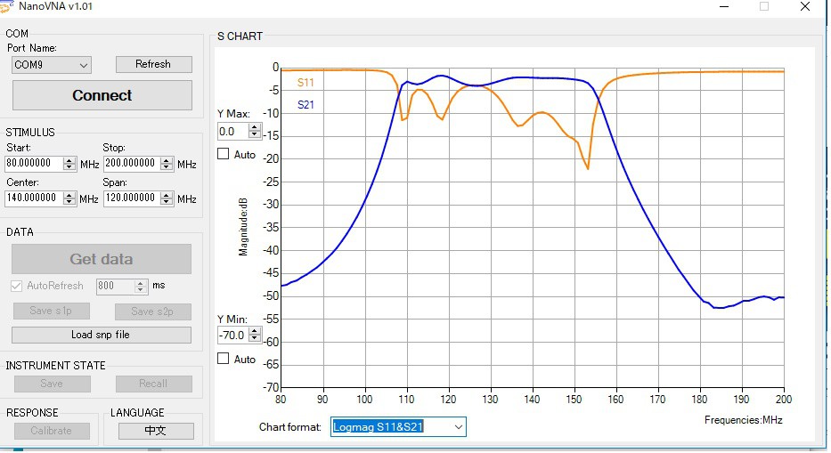

I still have an air-core version of the filter. Here is its measured response:
We should recognize that thePCB pattern coil is much different from the desired coil at VHF.
