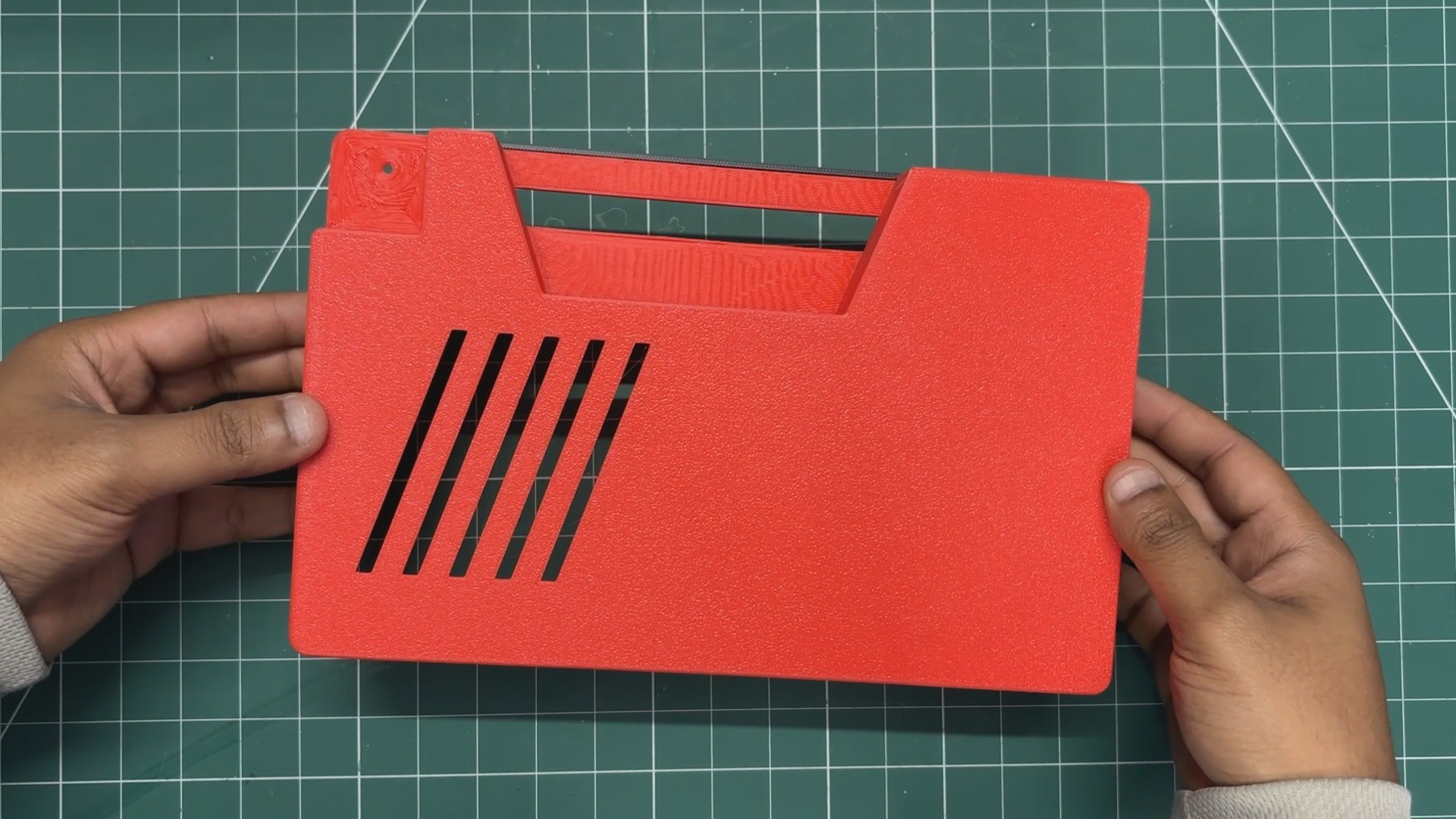

On the back, grills are added for airflow. While it does allow air to pass through, it's mostly an aesthetic feature that enhances the industrial design. On the left side, we included a dedicated opening for easy access to all the CM5 I/O ports. On that same side, there's also a separate USB Type-C port used exclusively for charging the battery.
To make the device stand out even more, the frame and the main body were printed in two different colors. I used Hype PLA Red for the back body and Hype PLA Black for the frame. This combination creates a striking dual-tone red-and-black color scheme that looks absolutely awesome.

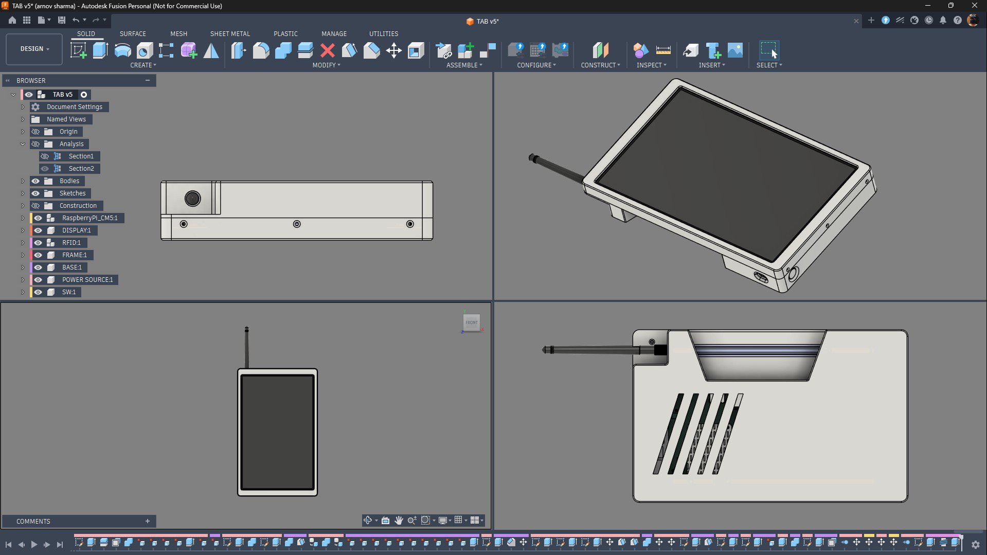

ENCLOSURE

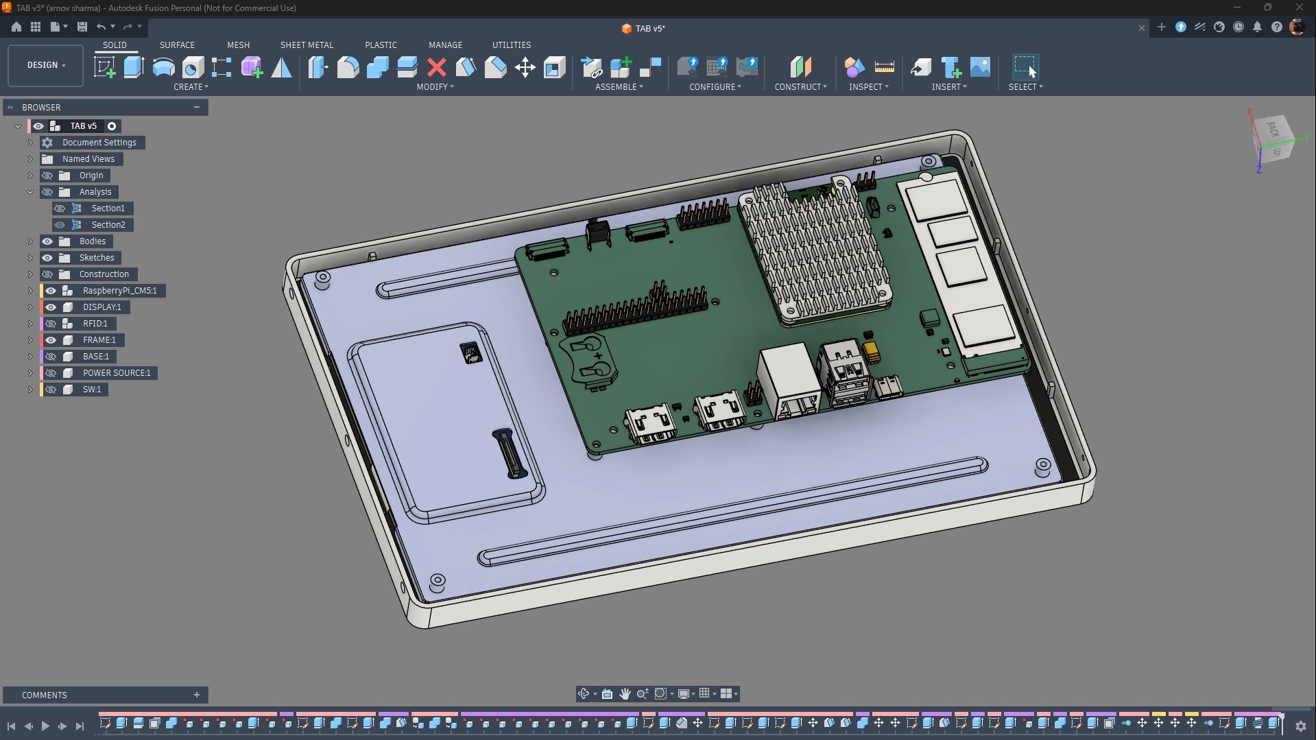

The enclosure mainly consists of two parts: the frame, which holds the display and Raspberry Pi CM5 assembly in place, and the back cover, which houses the battery pack, power circuitry, and antenna. Both parts are secured together using M2 screws that fasten into mounting holes placed around the perimeter of the frame.
I also added a few ventilation grills near the CM5 location to improve airflow, as this device relies on passive cooling with a heatsink. On the left side, there is a dedicated opening that provides access to the Raspberry Pi CM5 expansion board's I/O ports. The HDMI port, power input, USB ports, and other connectors can all be accessed through this opening in the back cover.

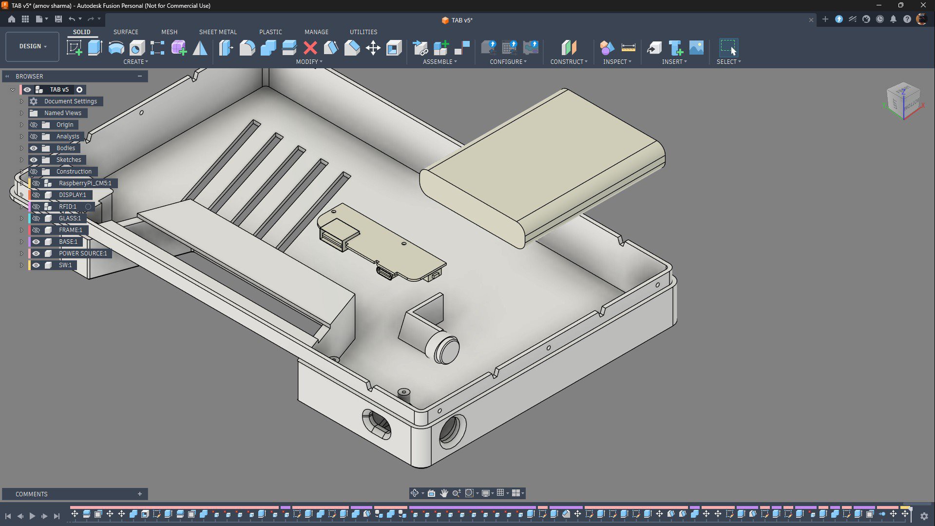

POWER SOURCE (LIPO CELL FITMENT)
During the CAD design process, I measured the power circuit using a vernier caliper, recreated it in CAD, and then integrated it into the back cover. The circuit already had mounting holes, so I added corresponding screw bosses inside the enclosure to securely mount it in place.
One side of the enclosure provides access to the USB Type-C port on the power circuit, allowing the battery to be charged without opening the device. On the opposite side, I designed a button actuator that presses the SMD switch on the power module. This actuator allows the power circuit to be turned ON or OFF from the outside of the enclosure.

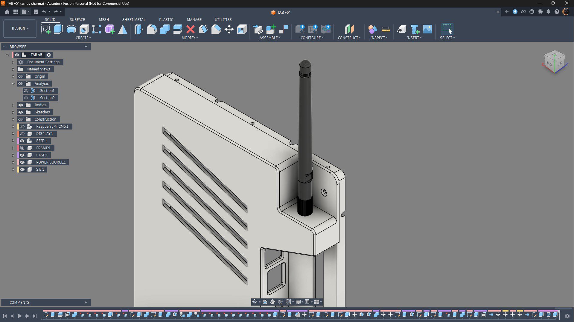

ANTENNA

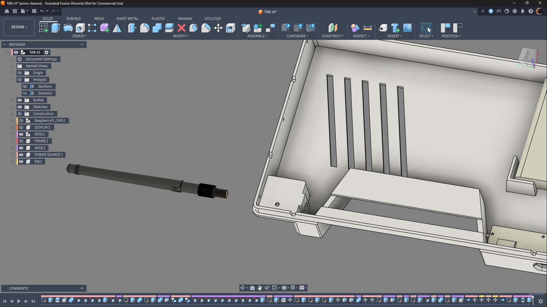

CM5 does come with Wi-Fi, but because we are adding it inside a plastic housing, the signal strength can be affected. That's not a problem, as the CM5 comes with a U.FL connector, and our idea was to attach an external antenna to the Raspberry Pi.
We modeled the antenna we salvaged from an NRF24 device and positioned it on the back of the body. The antenna attaches through an RP-SMA female connector mounted in a dedicated hole, where it is secured in place using an M6 nut.
By adding the antenna, our tablet stands out and looks more industrial.

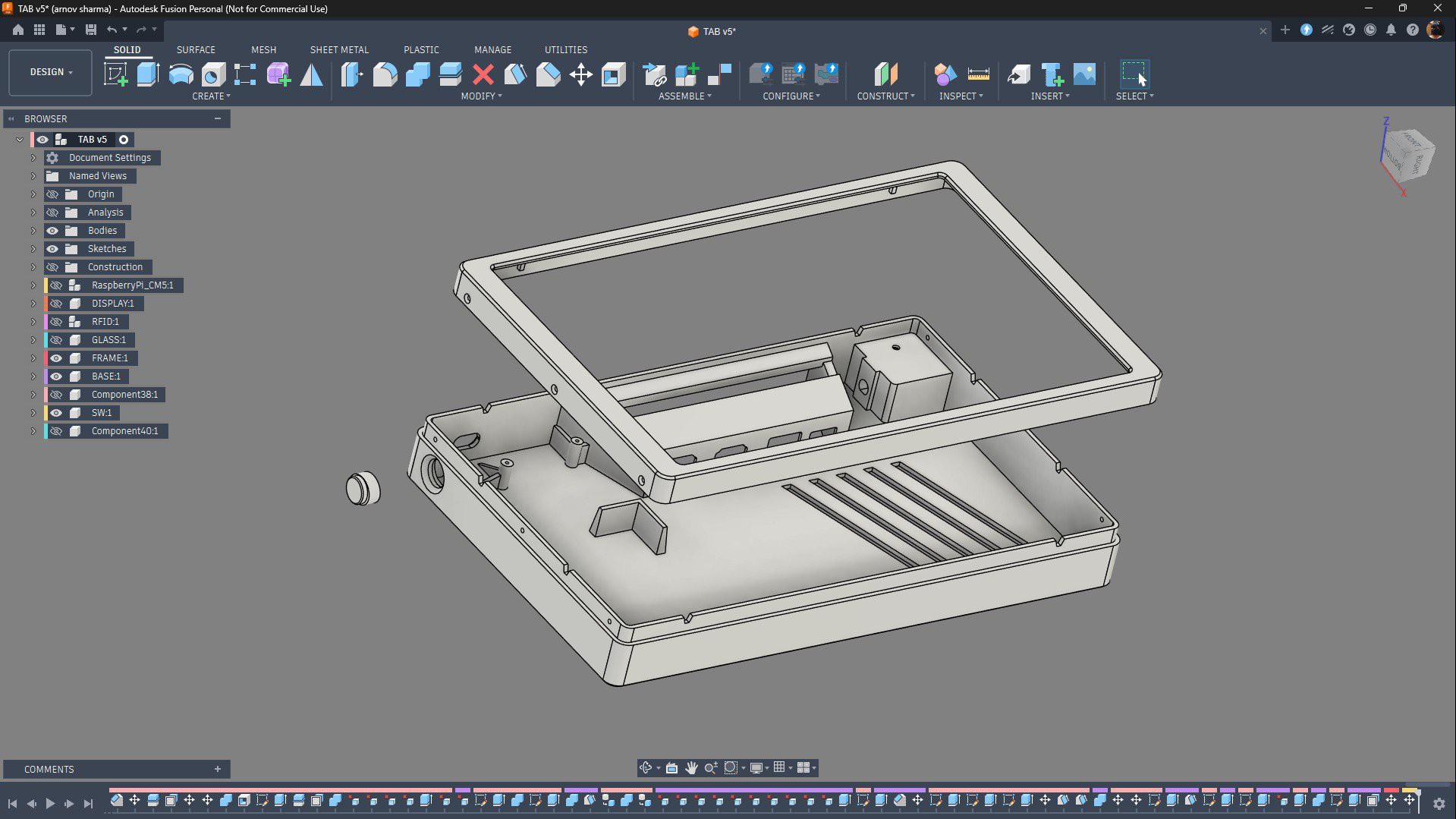

CM5-DISPLAY WITH FRAME
The frame part holds the Waveshare display and Raspberry Pi CM5 board assembly in position.
When the back body is placed below the frame part, the display is held in place between the frame part and the back part. M2 screws are used for securing both parts, and in between them, the display assembly is tightened in place.

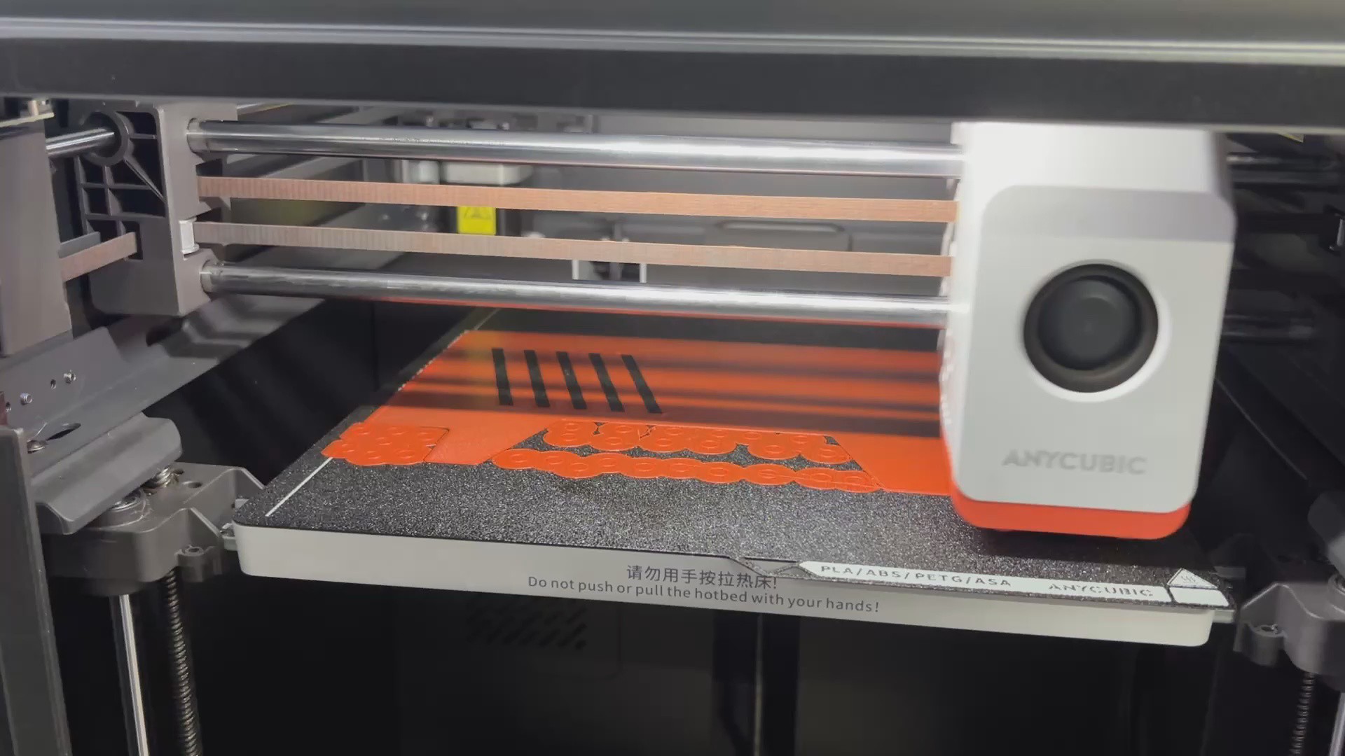

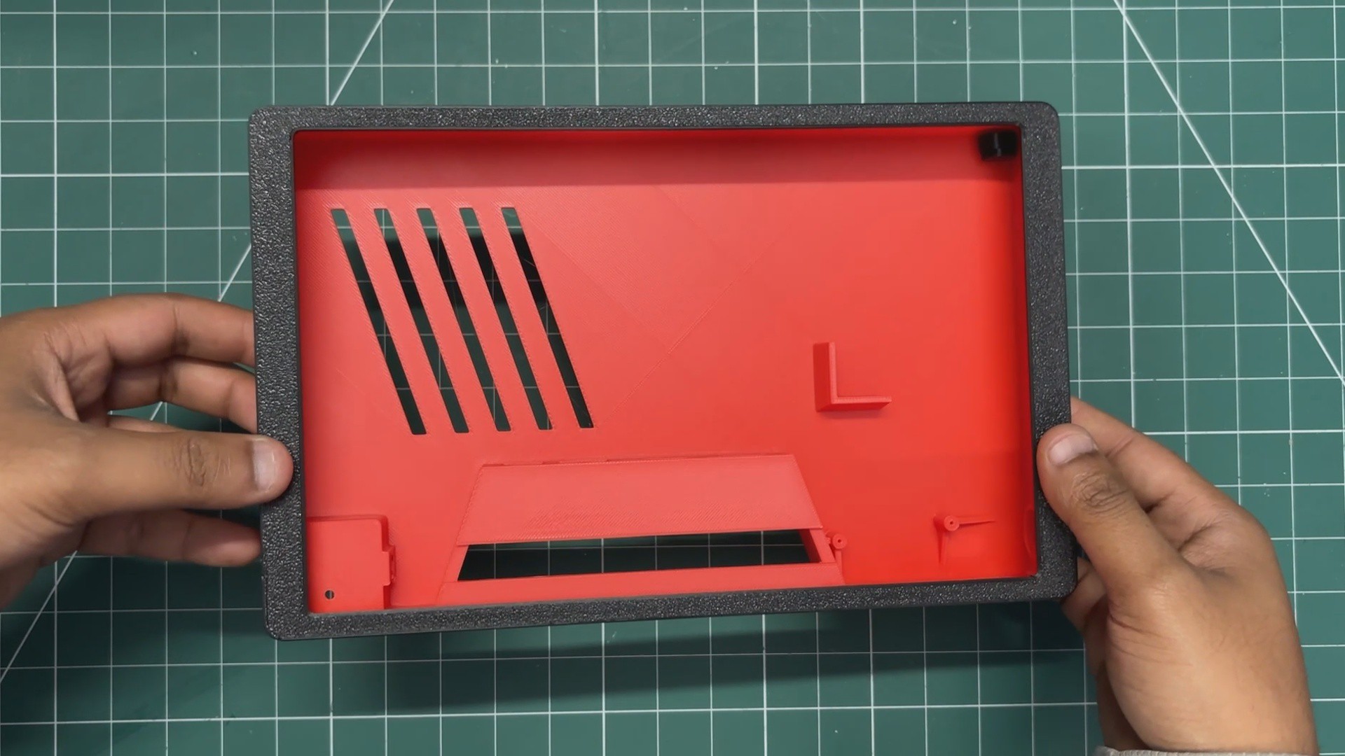

3D PARTS
After finishing the model, we exported three parts: the back part, the frame, and the button actuator.
The frame part and button actuator were both printed in Black Hype PLA with a 0.2 mm layer height and 25% infill. The back part was printed in Red Hype PLA with similar settings.
