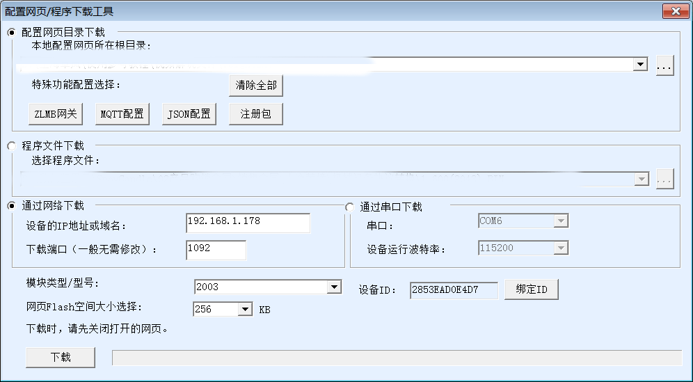

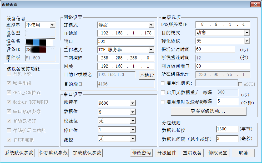

2. Gateway Configuration Instead of setting the gateway to "Transparent Mode", I logged into its web UI and configured the string parser:
  • Baud Rate: 9600, 8, N, 1
  • Parsing Rule: Strip all non-numeric characters (CR, LF, spaces).
  • Math Logic (for the Shimadzu): Applied a linear transformation (value - offset) / scale directly in the gateway memory to handle the negative tare weights.
  • Output: Pushed the final clean integer to Modbus Holding Register 40001.

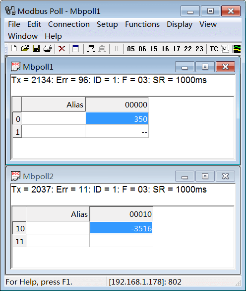

3. The Result
Now, instead of listening for messy ASCII strings, my SCADA simply polls the gateway's IP address on port 502 and reads register 40001 like a standard PLC.
