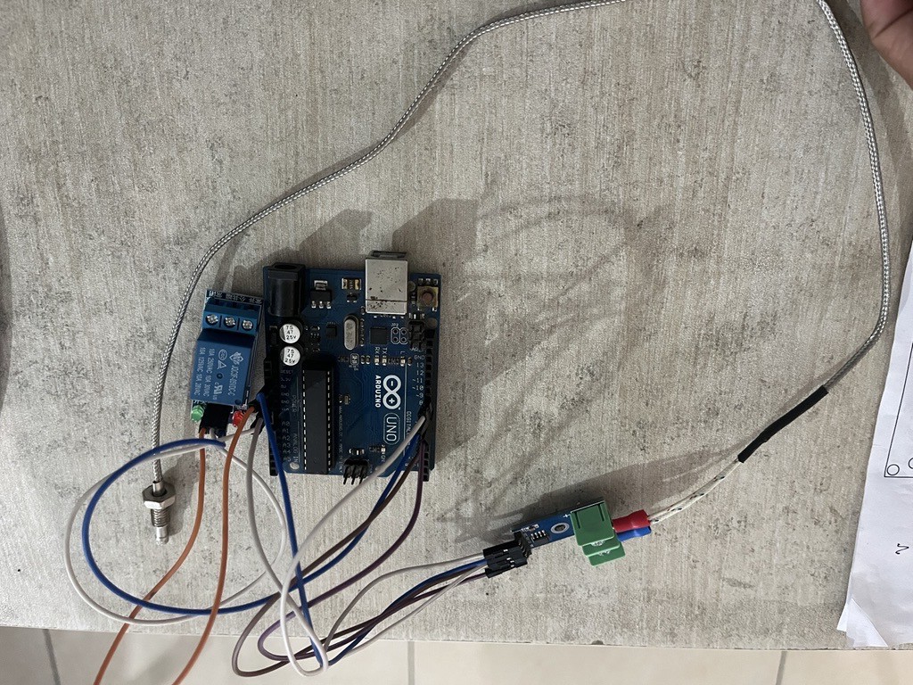

Temperature control is an essential requirement in many industrial, laboratory, and automation systems. This project demonstrates a simple, yet effective temperature controller built using an Arduino Uno, a MAX6675 Thermocouple Amplifier Module, a K-Type Thermocouple Sensor, and a 5V Relay Module.
The system continuously monitors temperature in real time and automatically controls a relay based on a user-defined temperature threshold. When the measured temperature reaches or exceeds the configured limit, the relay is activated. If the temperature falls below the threshold, the relay is automatically turned off.
For additional safety, the system also detects thermocouple connection failures and immediately disables the relay to prevent unintended operation.

How the System Works
The K-Type thermocouple measures the surrounding temperature and sends a small voltage signal to the MAX6675 module.
The MAX6675 performs:
- Signal amplification
- Cold-junction compensation
- Analog-to-digital conversion
The Arduino Uno reads the digital temperature data from the MAX6675 through SPI communication.
Every second, the system:
1.Reads the temperature value.
2. Converts the temperature to Celsius and Fahrenheit.
3. Displays the reading on the Serial Monitor.
4.Compares the temperature against the configured threshold.
5. Controls the relay accordingly.
MAX6675 Connections
| MAX6675 Pin | Arduino Pin |
| VCC | 3.3V |
| GND | GND |
| SCK | D9 |
| CS | D6 |
| SO | D7 |
Relay Connections
| Relay Pin | Arduino Pin |
| IN | D8 |
| VCC | 5V |
| GND | GND |
System Operation
Temperature Measurement
The MAX6675 converts the thermocouple voltage into a digital temperature reading.
The Arduino reads:
- Temperature in Celsius
- Temperature in Fahrenheit
every second.
Example:
10.000 --> Temp: 27.50 °C | 81.50 °F 10.000 --> Relay: OFF
Relay Control Logic
The temperature threshold is defined in the code:
#define TEMP_THRESHOLD 30.0
Relay OFF Condition
Temperature < 30°C
Relay remains OFF.
Example:
--> Temp:28 °C --> Relay: OFF --> Temp: 31.75 °C --> Relay: OFF
Relay ON Condition
Temperature ≥ 30°C
Relay turns ON.
on Serial Monior:
215.212 --> Temp: 31.50 °C | 88.70 °F 215.214 --> Relay: ON 216.215 --> Temp: 31.75 °C | 89.15 °F 216.217 --> Relay: ON
Thermocouple Error Detection
If the thermocouple becomes disconnected or communication fails:
Thermocouple ERROR! Check wiring.
The relay is immediately turned OFF for safety.
