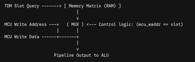

Mitigating Read-Write Hazards (Data Forwarding)
Because the MCU asynchronously writes data via the parallel bus into the same memory space that the TDM ALU cyclically reads, the system is highly susceptible to data corruption and pipeline stalls. The core_mem.v module resolves this utilizing Data Forwarding:
If the asynchronous MCU write address (mcu_waddr) matches the currently active TDM read slot (slot) during a clock cycle, the internal RAM output is bypassed. A multiplexer transparently routes the incoming MCU data directly to the pipeline output registers (core_audio, core_frq, or core_gain).
