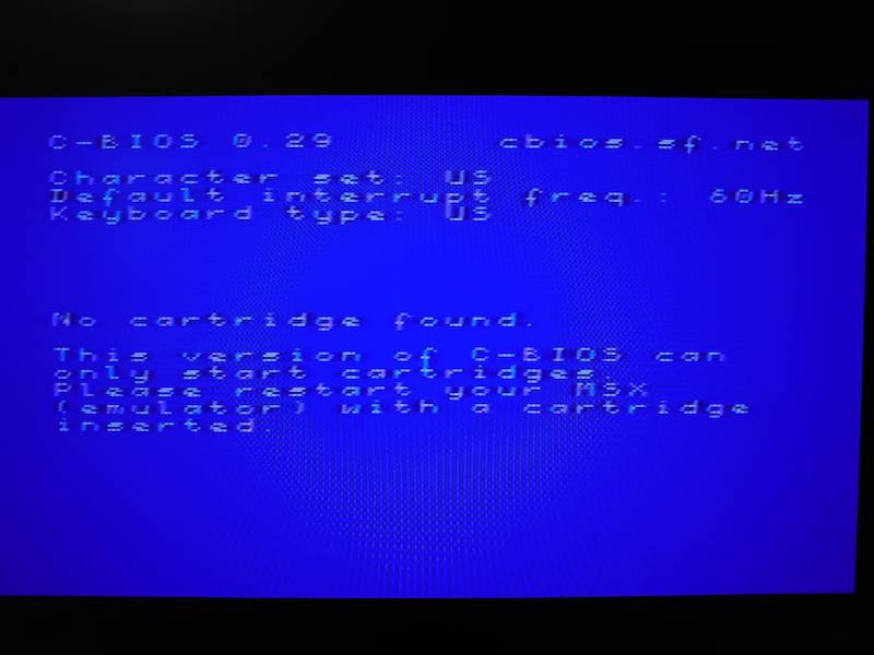

With the RAM finally coherent, the C-BIOS booted up… and generated garbage again. But now it was *stable* garbage. *Good* garbage. Not a treasure, but good garbage.
Progress!

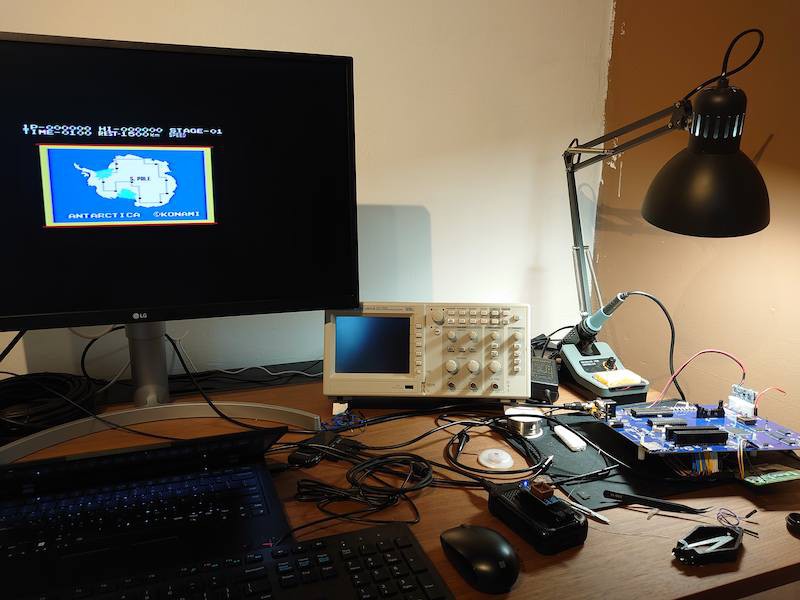

I flashed everything once again. C-BIOS banner. Reboot: C-BIOS banner. Power cycle: C-BIOS banner. Reboot: C-BIOS banner. I kept going well past the point of statistical significance, smiling the whole time. Smiles have been few and far between on this project.
No nice logo, no animation... but it's something.
So, since a stable C-BIOS banner is cool, but no one frames it and hangs it on the wall, I burned a 16kB ROM to the flash memory—exactly where slot 3-1 maps to page 1—and turned on the computer.
A penguin. Gliding across Antarctica. On a Z380 that, years ago, was just a spec sheet and a terrible idea.
