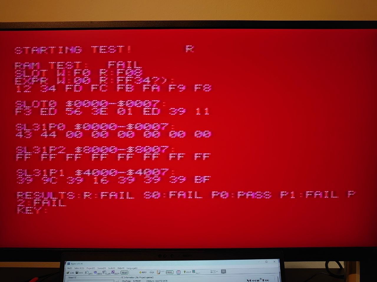

I spent weeks—several weeks—trying to figure out what was going on.
I wrote a very simple program that toggled a keyboard pin, and, of course, it wasn’t working. But it SHOULD have worked.
Using a data analyzer, I monitored the address bus, the data bus, and some control pins on the Flash. And it was really impressive to see just how much more advanced the Z380 was compared to the Z80. Of course, you already know this from reading the manual, even though the manual is pretty superficial. But it’s one thing to read about it and another to *experience* it.
Instructions executing in just a few clock cycles, the I/O bus completely separate from the memory bus, the internal (“phantom”) registers that simulate an instruction fetch cycle… it was an invigorating experience. So much so that I asked the chip’s architect for an autograph (more on that later).
During that time, I discovered two things. The first is that I had completely messed up the pinout of the Flash memory socket.
The second is that I had routed the SRAM data pins incorrectly.
<<Insert happy face here>>
This took me some time because the ROM is accessed in bytes; so to read a 16-bit value, the Z380 uses two fetch cycles. RAM, on the other hand, is accessed in 16-bit words, meaning that to read the same value, the Z380 uses only one fetch cycle.
Since the ROM can be accessed in both slot 0 and slot 3, I spent my time looking for issues in the Verilog code for the slot selector, instead of focusing on the hardware.

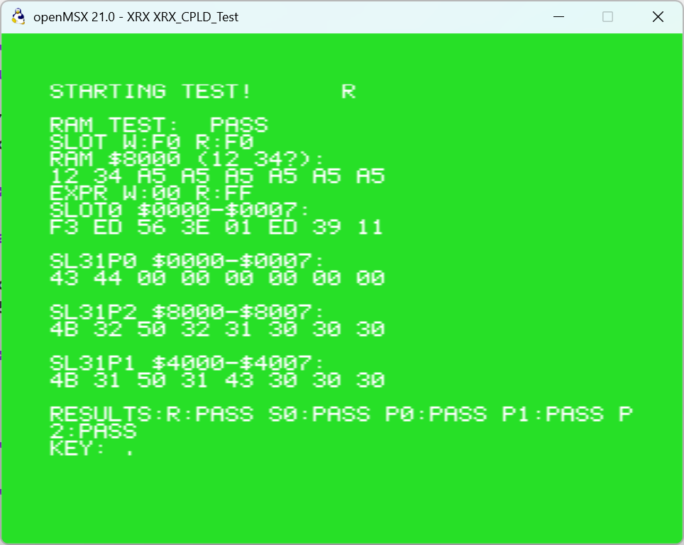

Creating an MSX machine for OpenMSX would help me a lot. I could create a more advanced test program and be sure it would work on an MSX “machine.” After finishing the program, then I would flash it and test it on real hardware.
And so it was done. I created a small program that tests the memory mapped in slot 3-0, the sub-ROM on page 0 of slot 3-1, and the kanji driver on pages 1 and 2 of slot 3-1. This would validate my entire Verilog implementation of the primary slot selector, the slot expander, and the memory mapper.
If everything went well, this should be the result on the actual hardware:

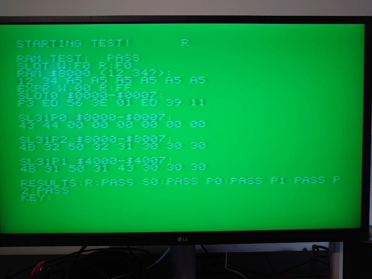

The time had come. Without giving it much thought, I reprogrammed the Flash (the *only* one I still have, since I broke a terminal on the other one), took a deep breath, and turned on the power supply. Nothing.
Oh! I also had to change the monitor’s video input… and then:
Sometimes—just sometimes—I find the MSX “slot” system a bit confusing. Slots. Sub-slots. Memory mapper. Pages. Mushrooms. Oh, wait, that’s a different Japanese system.
Well, after some work on the Verilog code, lo and behold:
A happy face at last.
