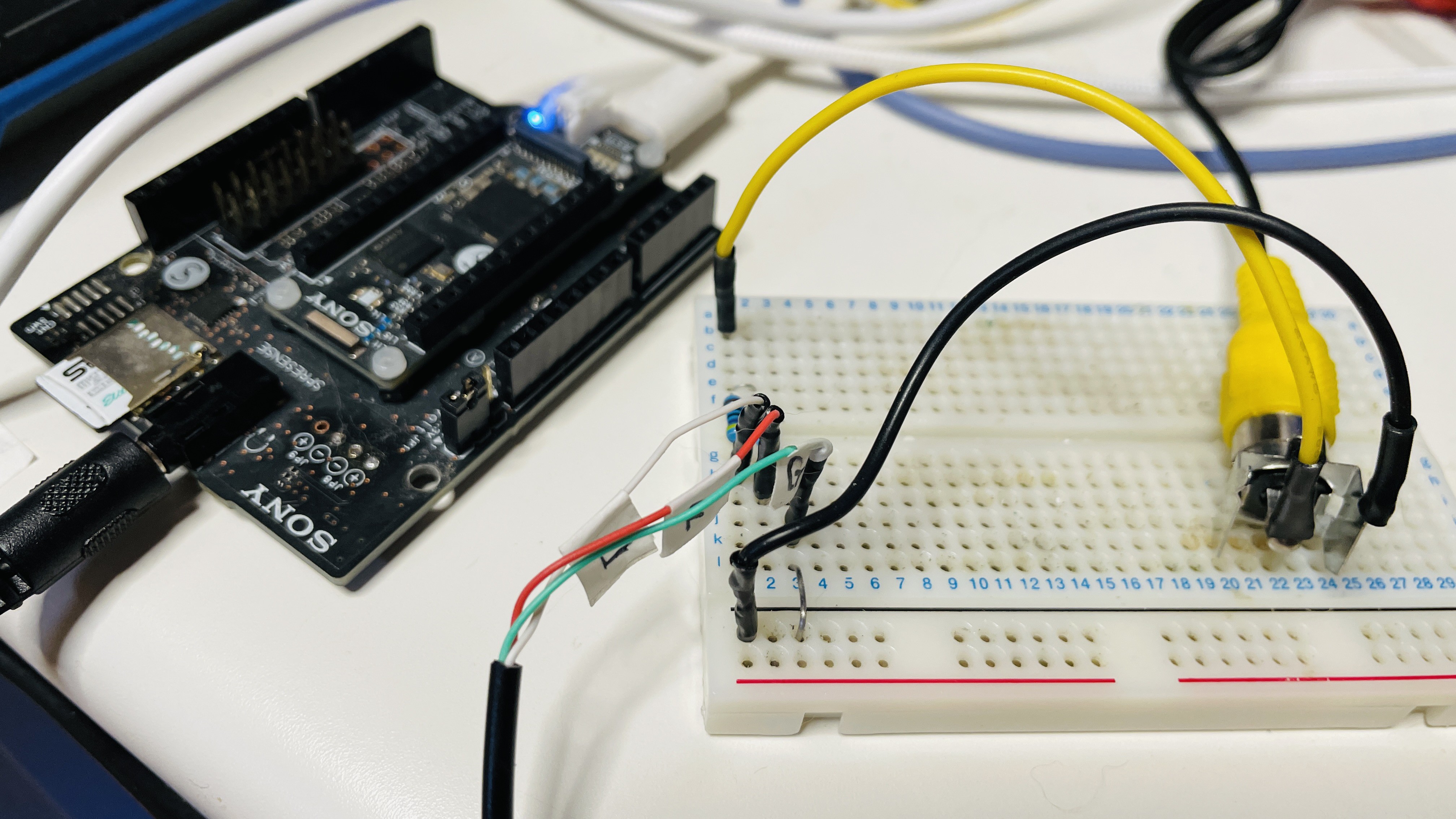

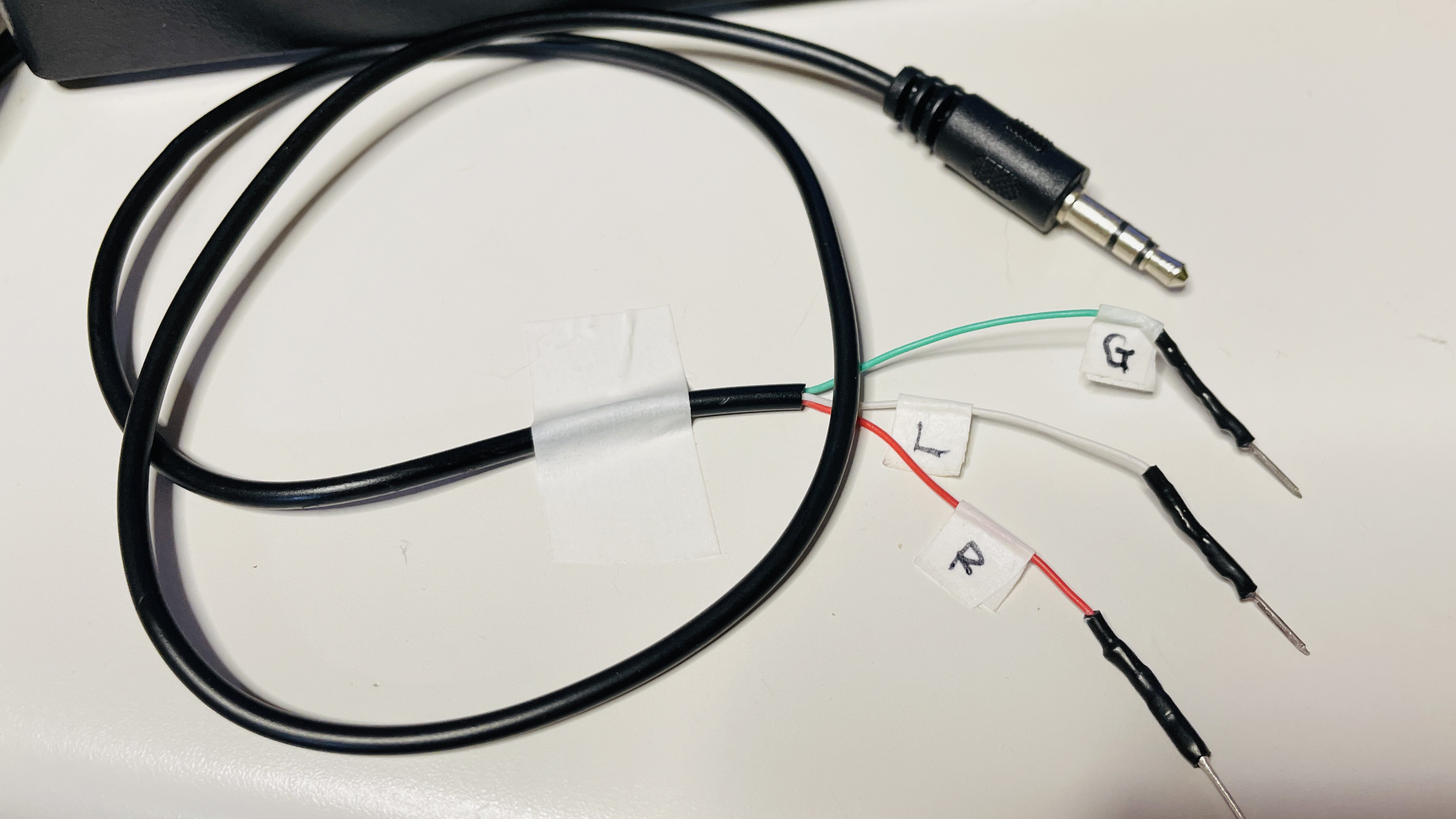

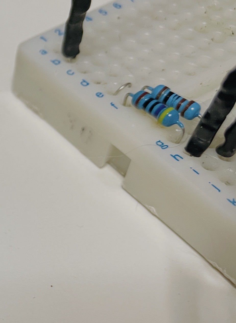

    3.3 Circuit
    Just 2 resistors.
    Headphone Jack:
    L (tip) -> 470 ohm -> RCA center pin
    R (middle) -> 1k ohm -> RCA center pin
    G (sleeve) -----------> RCA GND

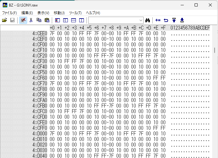

    3.4 PCM Values and NTSC Voltage Levels
    PCM_SYNC = 0x000000 # 0V = sync pulse
    PCM_BLACK = 0x100000 # 0.3V = black level
    PCM_WHITE = 0x7FFFFF # 1.0V = white level (maximum brightness)

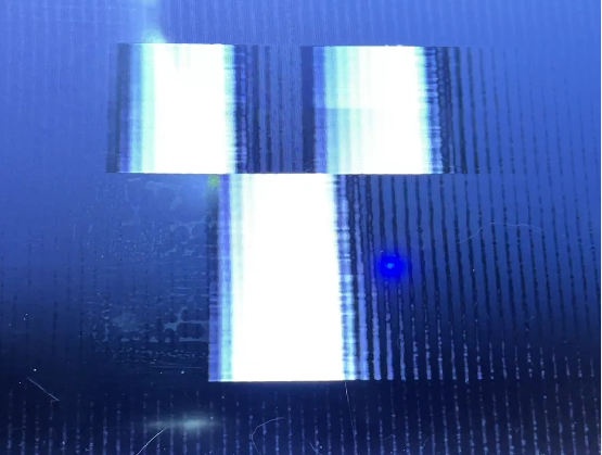

    3.5 Result
    Oscilloscope measurements:
    Horizontal frequency : 15.97kHz (spec: 15.734kHz) Period : 62.56us (spec: 63.5us) Vpp : 960mV (spec: 1Vpp)
    Video appeared on the TV.
    But "video appeared" is not the accurate description. More precisely:
    "A WAV file was played on a TV."

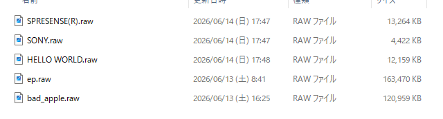

    ntsc.raw is generated by a Python script. The flow is as follows:
    Python generates PCM data at 1 line = 12 samples, writes 262 lines per frame, saves to SD card as ntsc.raw. Spresense plays it back via AudioClass at 192kHz 24bit Stereo through the CXD5247 DAC. Audio Jack outputs L ch as VIDEO through 470 ohm and R ch as SYNC through 1k ohm. These are mixed by resistors and sent via RCA to the TV.

    4.3 Writing One Sample
    24bit Stereo means 6 bytes per sample. L channel carries VIDEO data, R channel carries SYNC data, both written in 24bit little-endian format.

    ntsc.raw contains only 1 frame. When Spresense reaches the end of the file it seeks back to the beginning and continues playing. This allows continuous NTSC video output from a file of only 1.8KB.

    5.1 HELLO WORLD Text Display
    The first display experiment was the word "HELLO WORLD", one character at a time, arranged vertically.
    With only 9 pixels of horizontal resolution, each character (3 pixels wide) had to be stacked vertically. Even so, the characters are clearly recognizable.
    5.2 SONY Text Display (switching every second)
    Next, the characters S, O, N, Y were displayed switching every second.
    This confirmed that dynamic content can be expressed as ntsc.raw.
