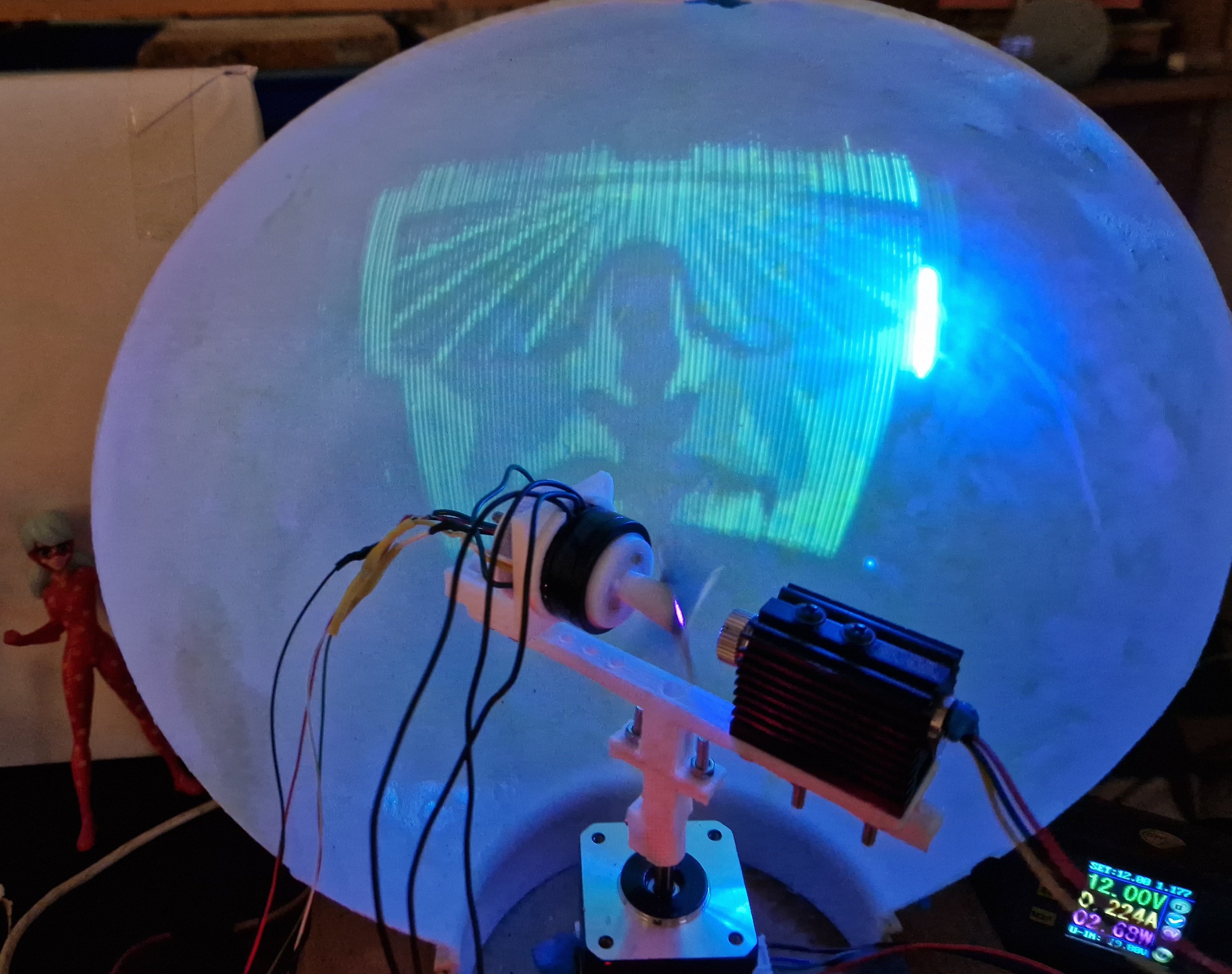

An interesting and forgiving project - even if implemented badly you can get nice results.
The stars of the show:-

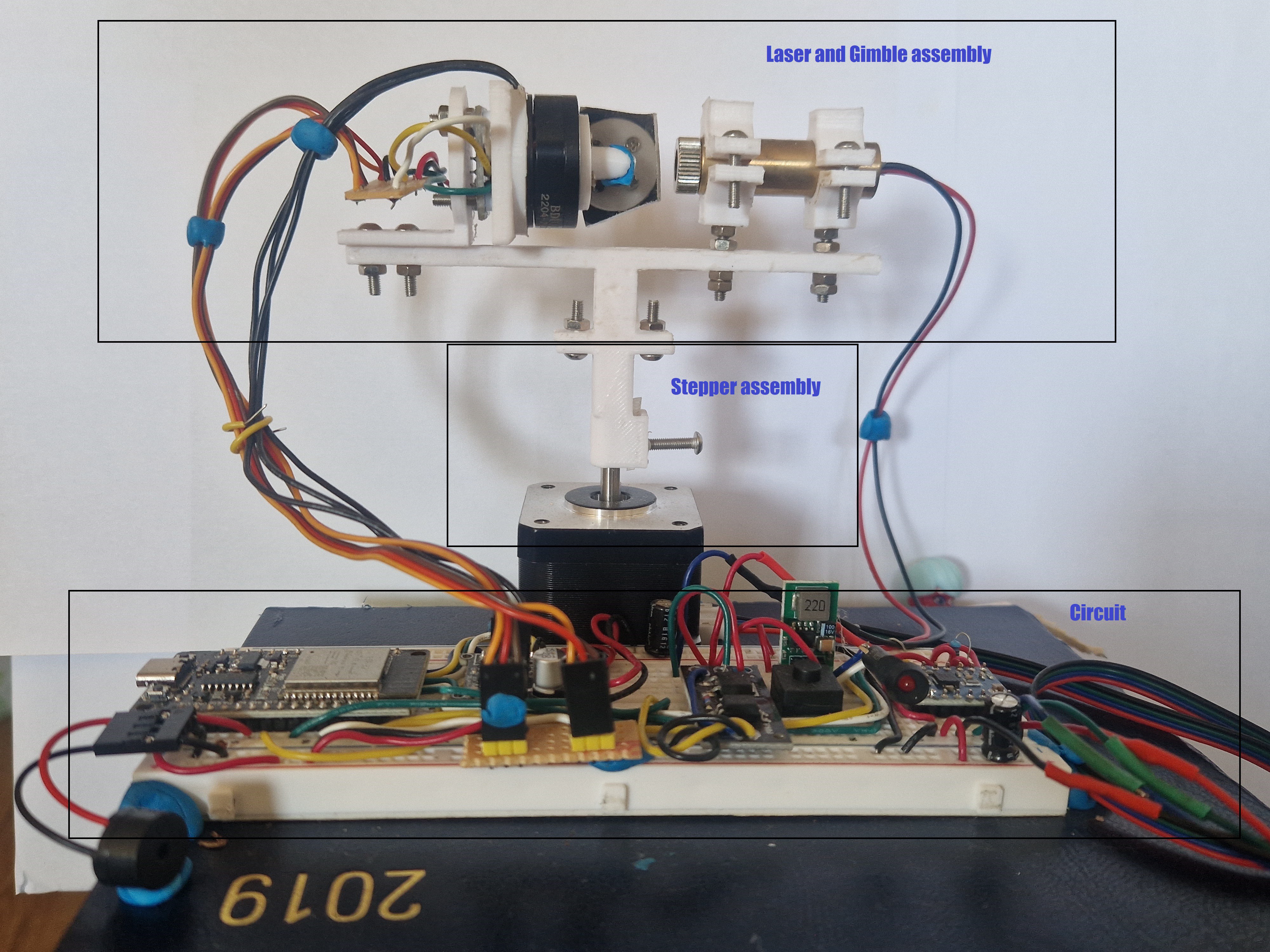

-ESP32 dual core:
A fantastic microcontroller, the second core is vital for handling the gimbal motor while the first core handels WiFi coms and other stuff.
-Nema 17 stepper motor - and a suitable stepper driver board
A highly popular stepper motor. At least a 1/16 micro step driver board should be used.
-A Gimbal Motor - and a suitable driver board (DRV8313)
Brushless motor and board, not cheap but getting cheaper. Can do lots of things using the following;

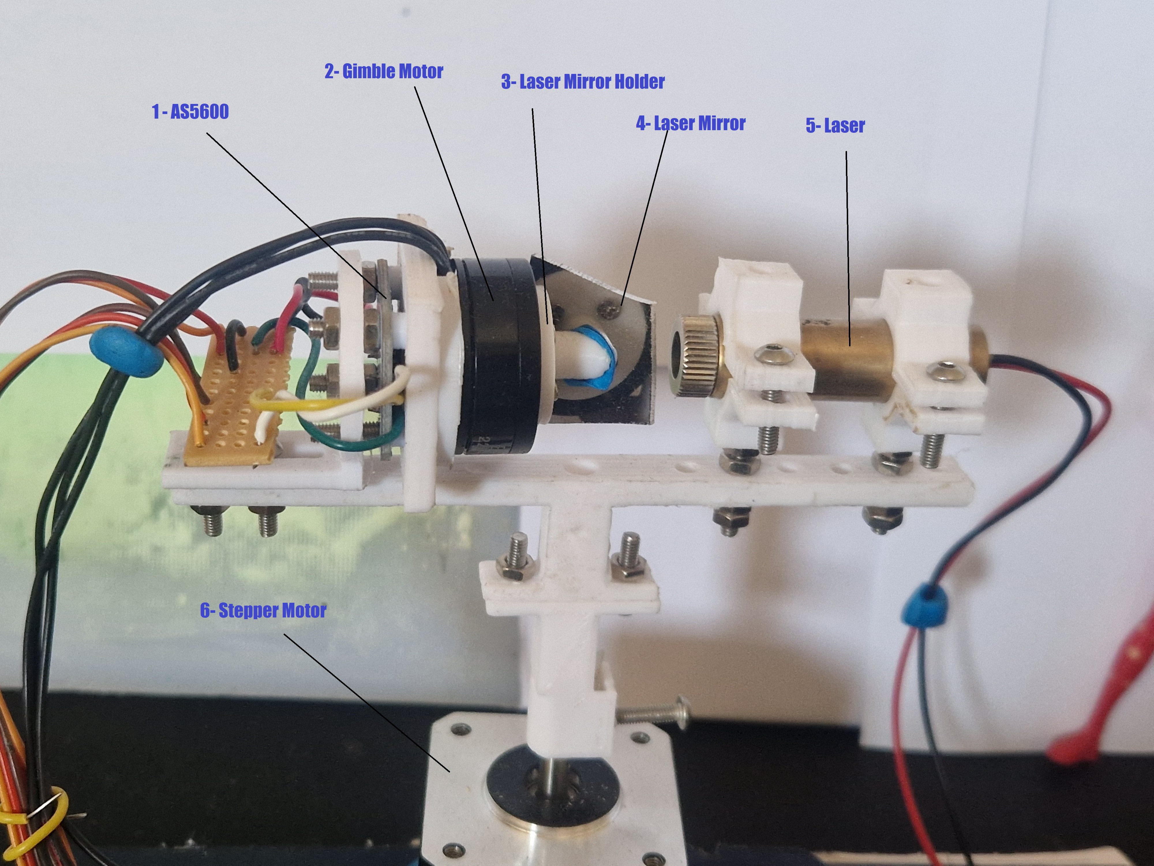

A physical overview:
In its simplest form the mechanism is a laser X - Y stage inside a full sphere.
The 45 degree mirror driven by the gimble motor can do a full 360 scan and along with the base stepper moving the whole thing (only 180 degrees of movement is needed), almost all of the sphere can be hit.
A portion of the south pole gets blocked by the supports and base stepper motor but its size is relatively small.
If you can imagine this, you will see that it can project / scan to almost any surface around it.
Scanning to a flat surface works well but needs image transform for bigger angles.
The whole assembly :
The moving bits:

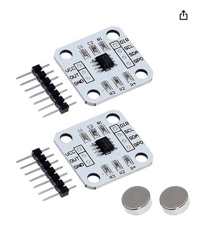

1-AS5600
12Bit Magnetic Encoder Magnetic Angle Measurement Sensor Module
Very affordable module - currently 8 Euro for two, used with the simpleFOC library and a brushless drive board to control...
