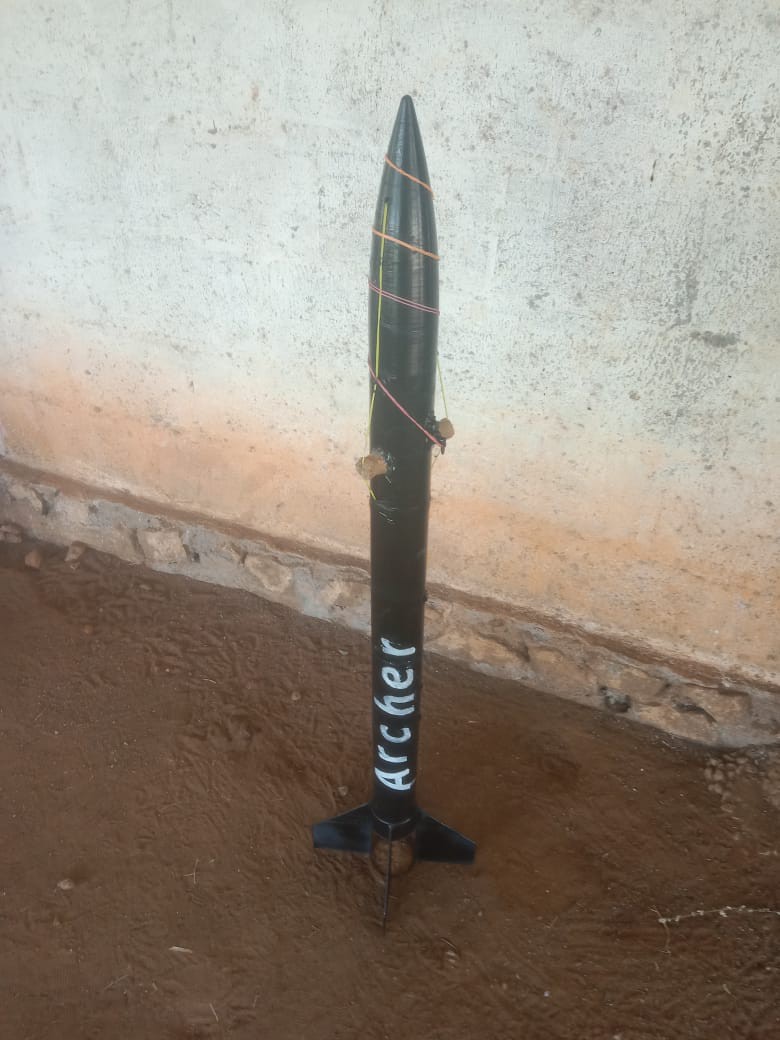

    Rocket design

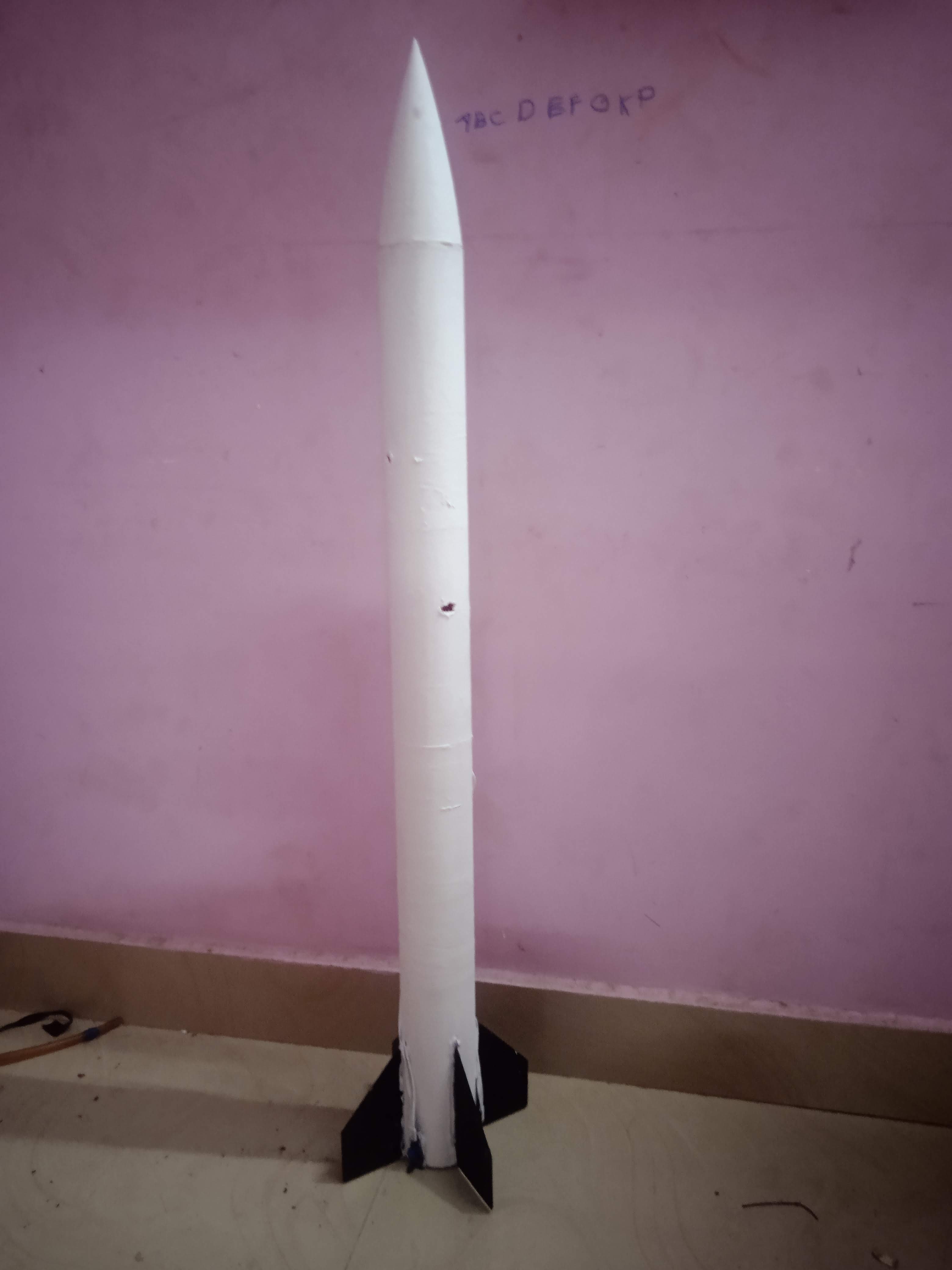

    Archer-2 is an exact copy of Archer-1; only the electronics were changed.

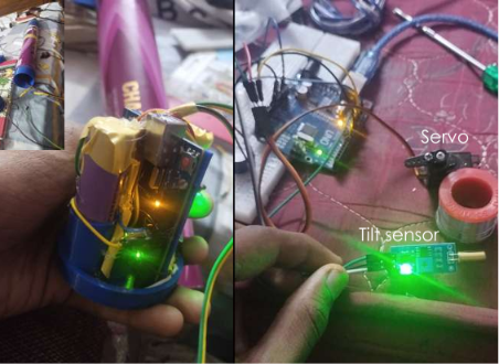

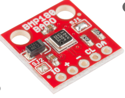

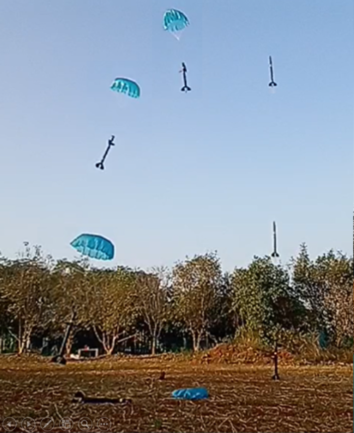

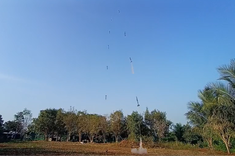

    Apogee Detection
    This time, I removed the tilt sensor and used a pressure sensor to measure atmospheric pressure. As the rocket’s altitude changes, the atmospheric pressure also changes. By tracking these pressure changes, I could estimate the altitude and detect apogee.
    Code Logic

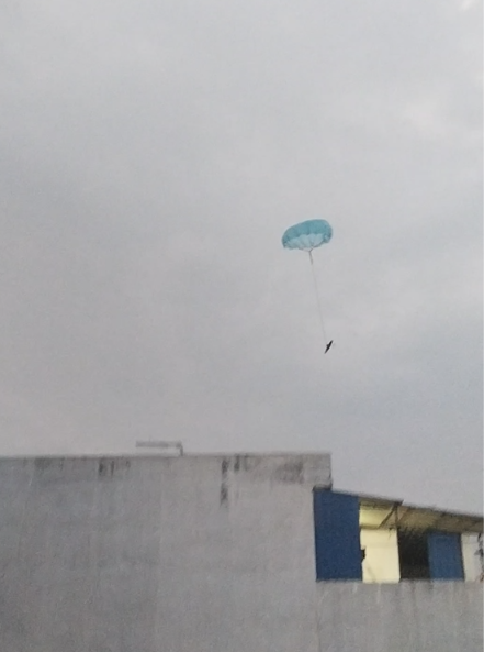

    The code uses two variables: Max Altitude, which stores the highest altitude reached, and Current Altitude, which stores the rocket’s present altitude. When the current altitude becomes lower than the maximum altitude, the rocket has passed apogee and started descending.

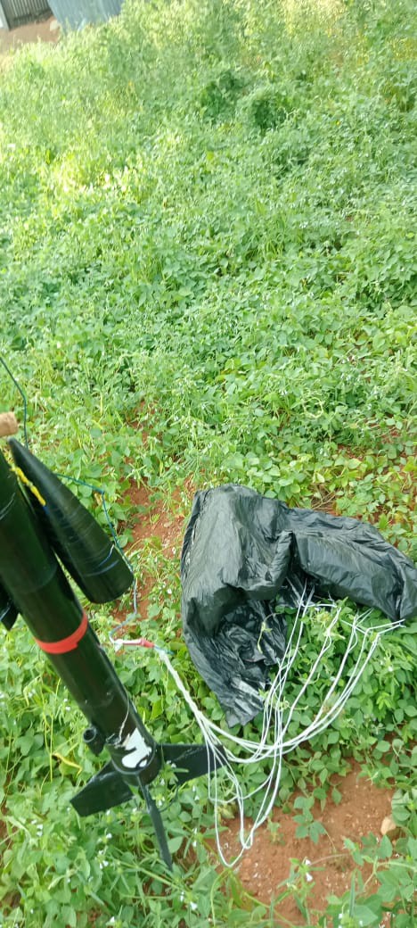

    Test Flight
    This method worked perfectly. The parachute deployed successfully, and the rocket landed safely. Finally, after many attempts and failures, the recovery system was complete.

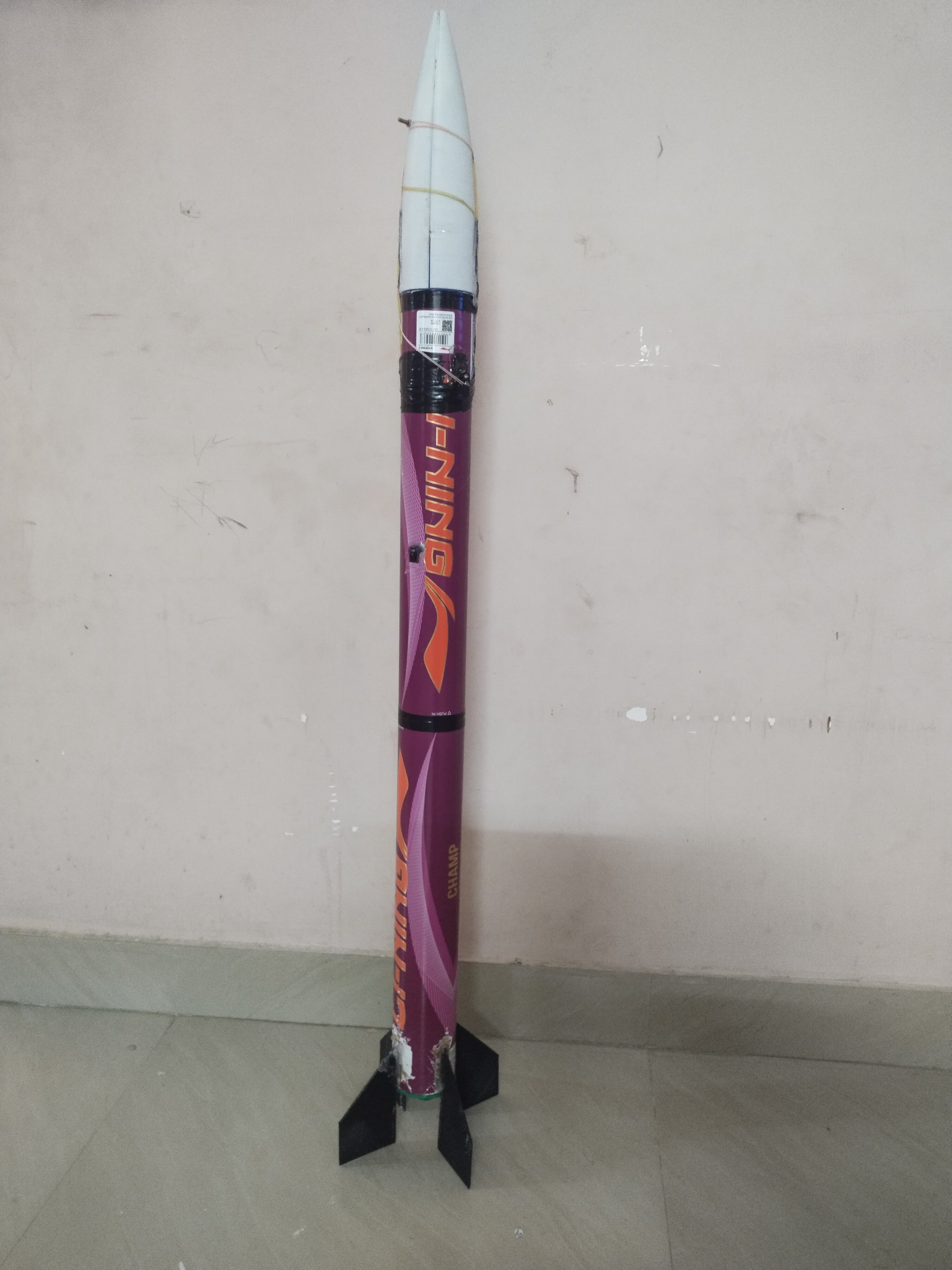

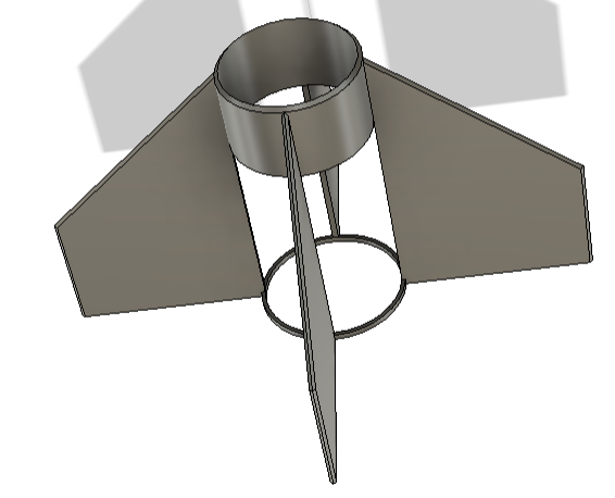

    Rocket design
    Archer-0 crashed badly and broke into many pieces, so I built a new version with larger fins and a more durable nose cone. Other than these changes, the design remained the same as Archer-0.
    Fins
    The fins were printed as a single piece. Printing and attaching them separately could cause alignment errors, which might make the rocket tilt to one side during flight.
    Flight Test-1
    I would consider this test the most successful one. The parachute deployed perfectly, and the rocket landed smoothly.

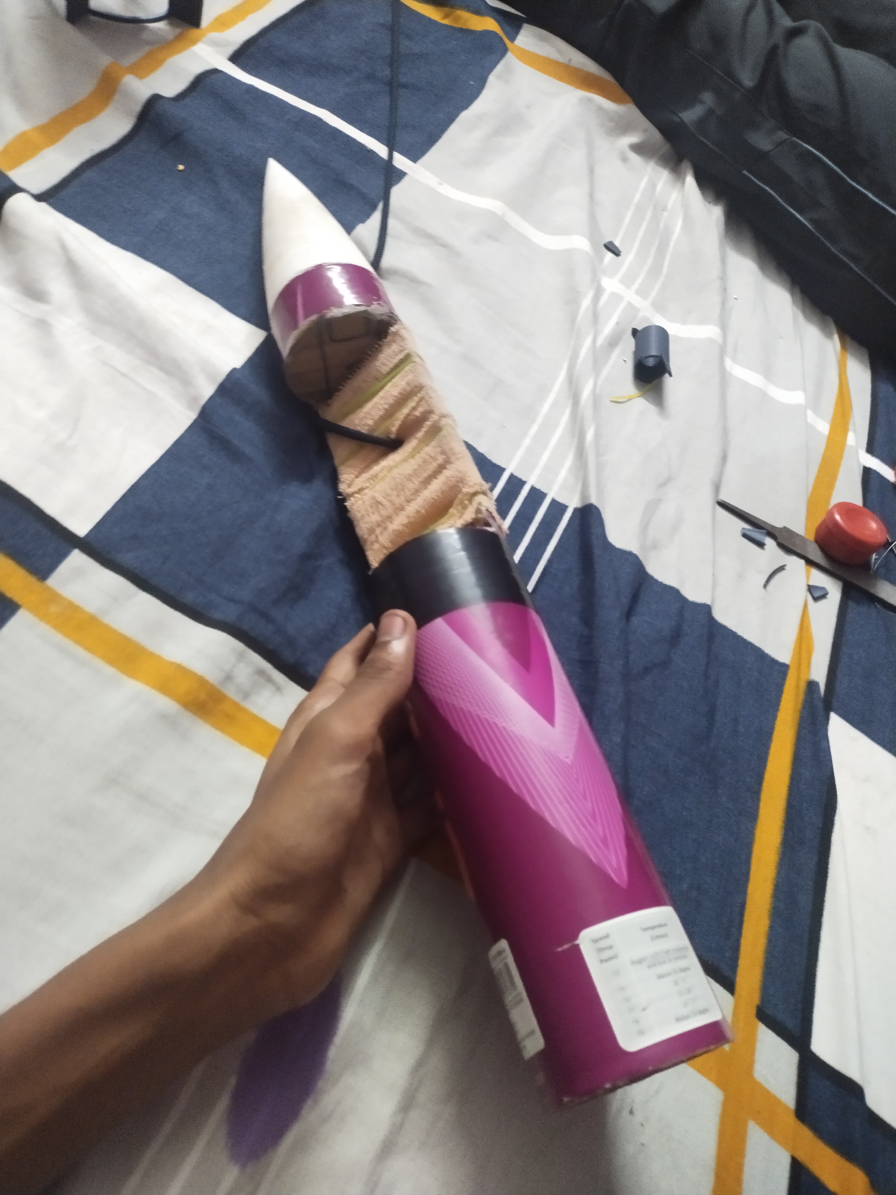

    This time, I switched to a more robust system. Instead of the homemade PVC-pipe and copper-piece tilt switch, I used an off-the-shelf tilt sensor.
    I also replaced heated wire, and match-based release methods with a servo-operated parachute deployment mechanism. The earlier methods could work once but fail during another test, so I wanted a more repeatable solution.
    An Arduino Uno was used to read the tilt sensor and control the servo. When the required tilt condition was detected, the servo released the parachute.

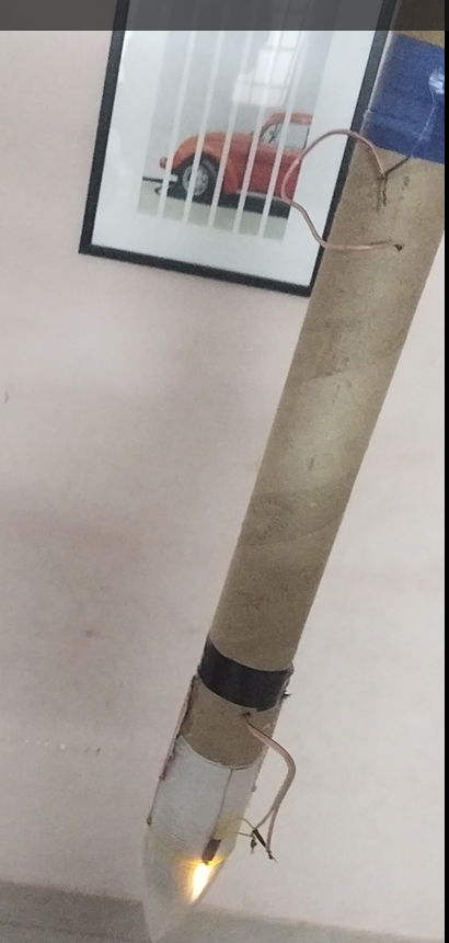

    ANA used the same general parachute-deployment idea as Raven: a rubber band held the parachute in place until the release mechanism was activated.
    However, instead of using only a heated wire to cut the rubber band, I attached a match head near the rubber band and connected it to the electrical circuit. When the deployment circuit was triggered, the match ignited and burned through the rubber band, allowing the nose cone to open and the parachute to deploy.
    This design was intended to provide a more reliable release than the previous wire-only mechanism.

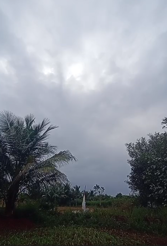

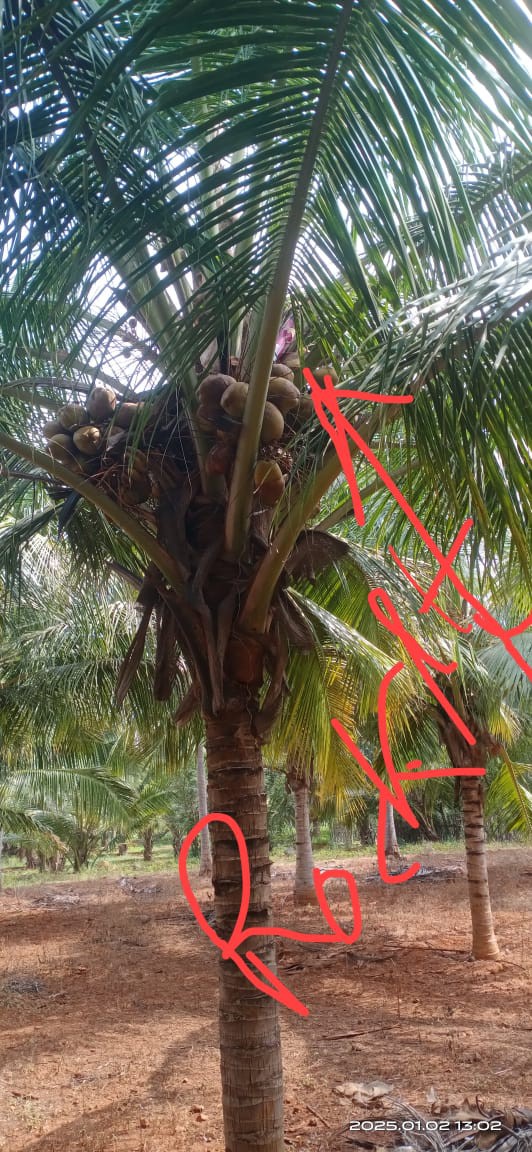

    Due to the strong wind during the rocket’s descent, the match did not burn through the rubber band. As a result, the parachute did not deploy, and I was unable to recover the rocket.

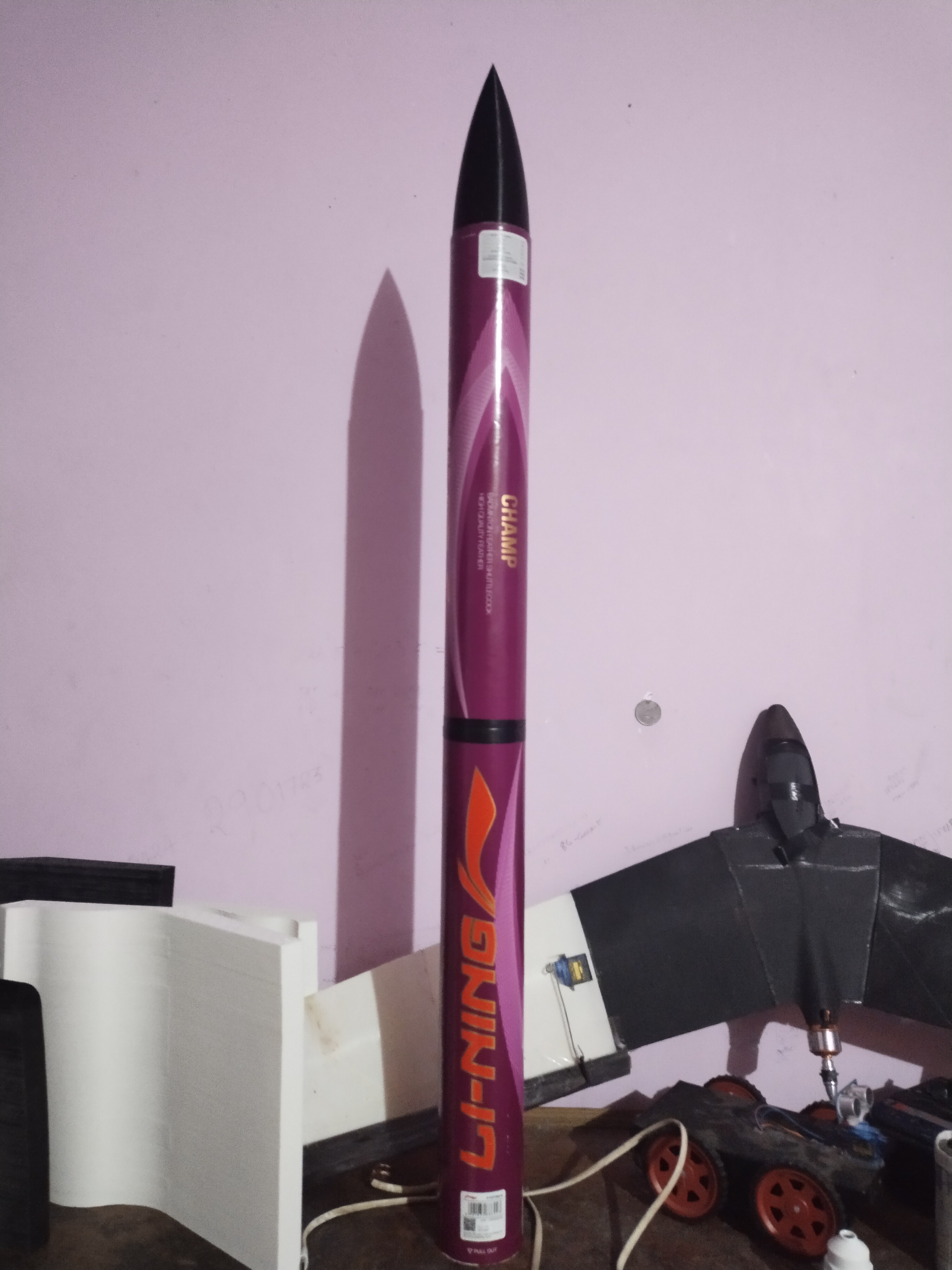

    Rocket design

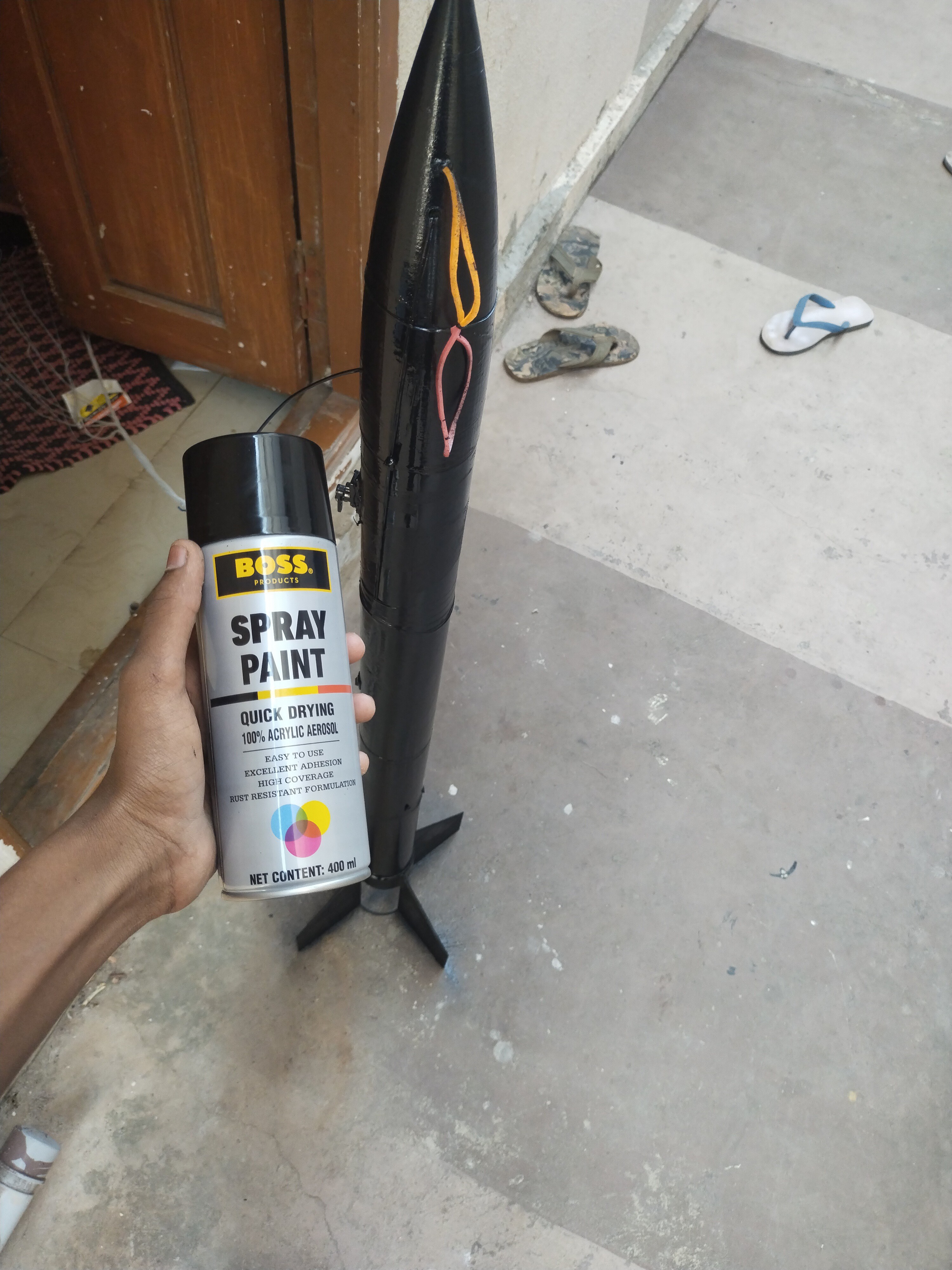

    I used the same basic design as Dragon: two body tubes joined with 3D-printed couplers, along with a 3D-printed nose cone and fins. It also used the same motor configuration as Spider.

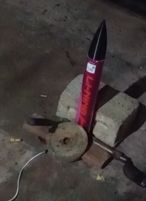

    Testing
    Result

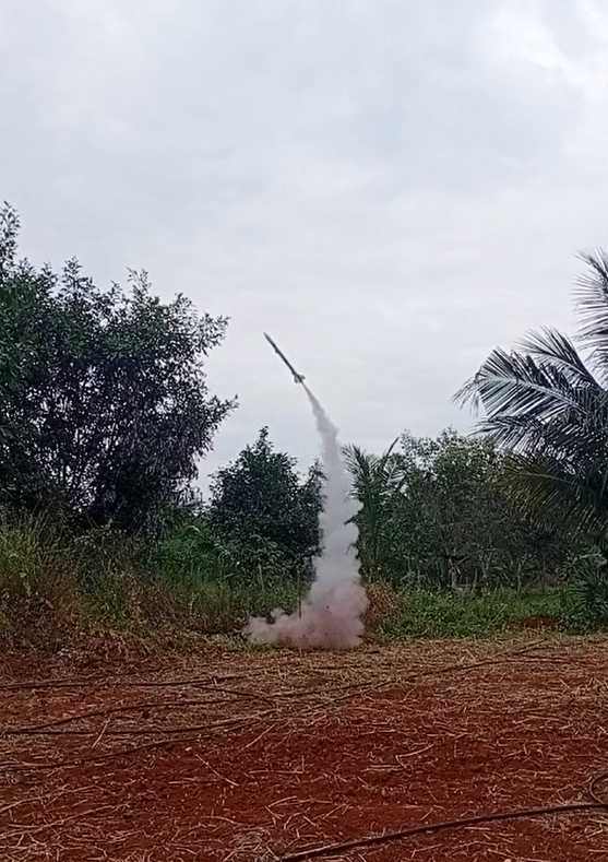

    Because the parachute was not secured properly, it deployed during mid-flight. The rocket then drifted a long distance sideways before crashing into a coconut tree.

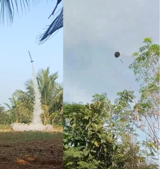

  • Spider: Development and Testing
    kruthick jothimani06/30/2026 at 05:08 0 comments
    Goal
    Spider was developed to test the new motor I made. At the same time, I was learning about rocket stability and how to design a stable rocket. Spider provided a useful platform to test what I had learned.
    Reference Video: Homemade Motor Development
    While searching YouTube for KNSU motor videos, I came across this video. It was very useful in helping me develop my own motor.
    All credit for the original video goes to its creator. This project is independent and is not affiliated with or endorsed by the channel.

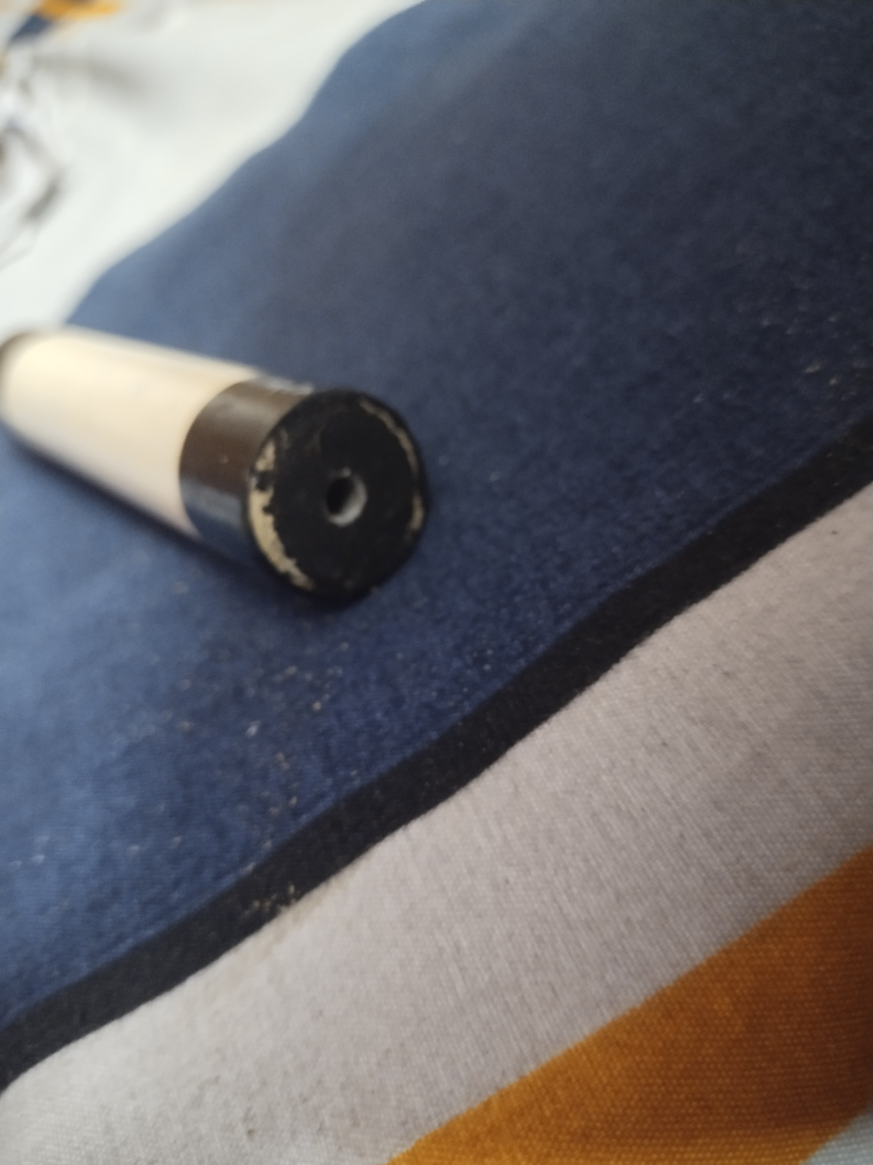

    Motor

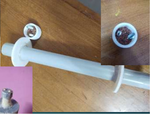

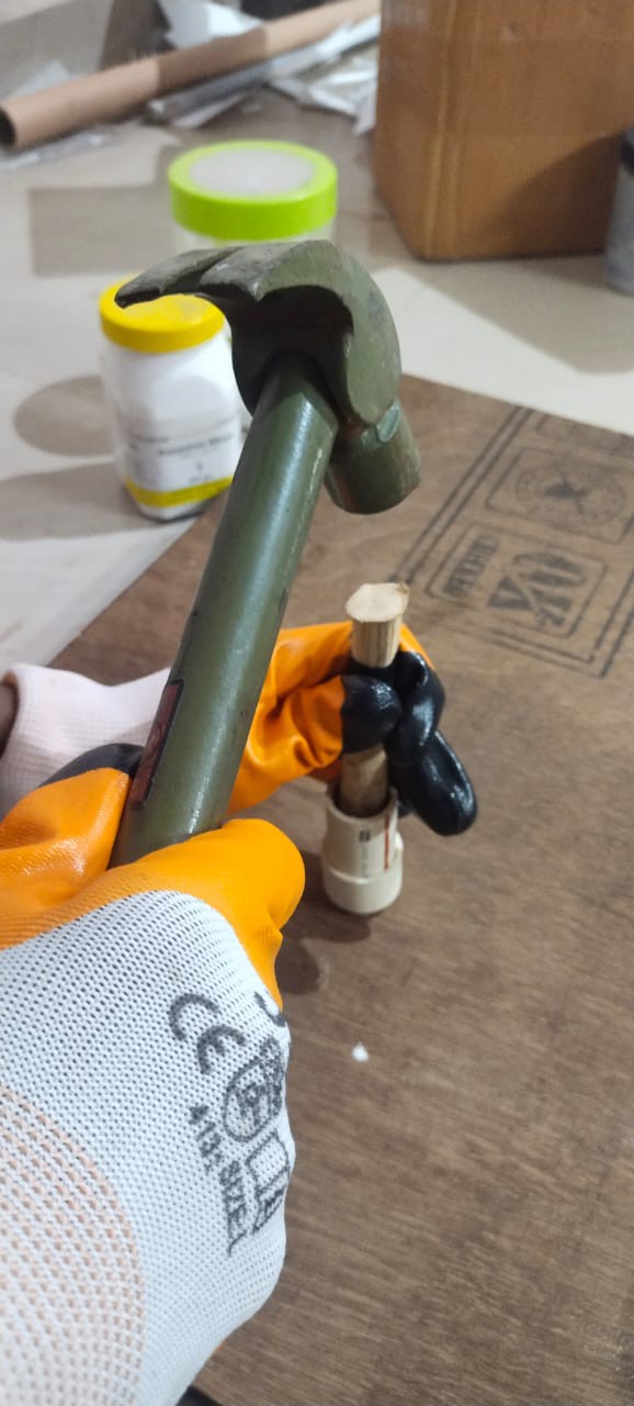

    This motor used a 1-inch CPVC pipe with two end caps. Metal washers were used as the nozzle, which was held in place with M-Seal.
    Unlike the previous motor, I used a melted KNO₃-and-sugar mixture and cast it into the pipe. This produced a denser and more uniform grain than the earlier manually compacted method.
    Rocket Design
    Spider was designed to be stable by using a slim body tube and placing the center of gravity (CG) ahead of the center of pressure (CP). I mounted the fins near the bottom of the rocket and added weight inside the nose cone to move the CG forward.

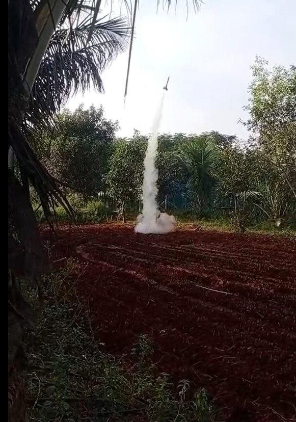

    This configuration made the rocket more resistant to unwanted rotation during flight. I also performed a string swing test to verify its stability.
    Testing
    Test Result
    Unexpectedly, the rocket flew much higher than I expected. It was a huge success, and I never thought a homemade motor would perform this well.
    Conclusion
    Melting and casting the fuel worked well, producing a denser and more uniform grain. However, it also made ignition more difficult. The Spider motor required several ignition attempts before it started successfully. Apart from the ignition issue, the test proceeded as expected.

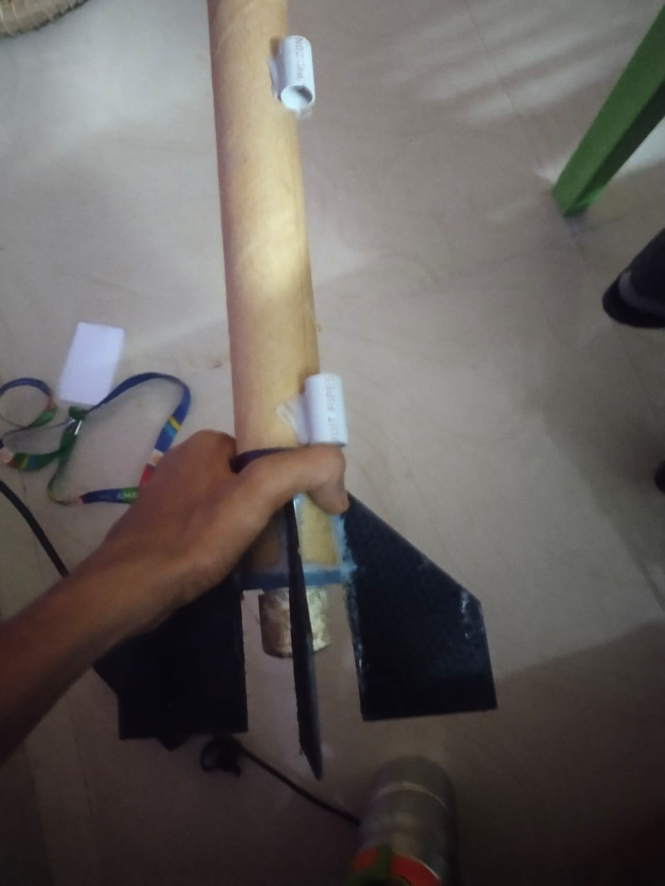

  • Yellow brothers: Development and Testing
    kruthick jothimani06/29/2026 at 17:25 0 comments
    Goal

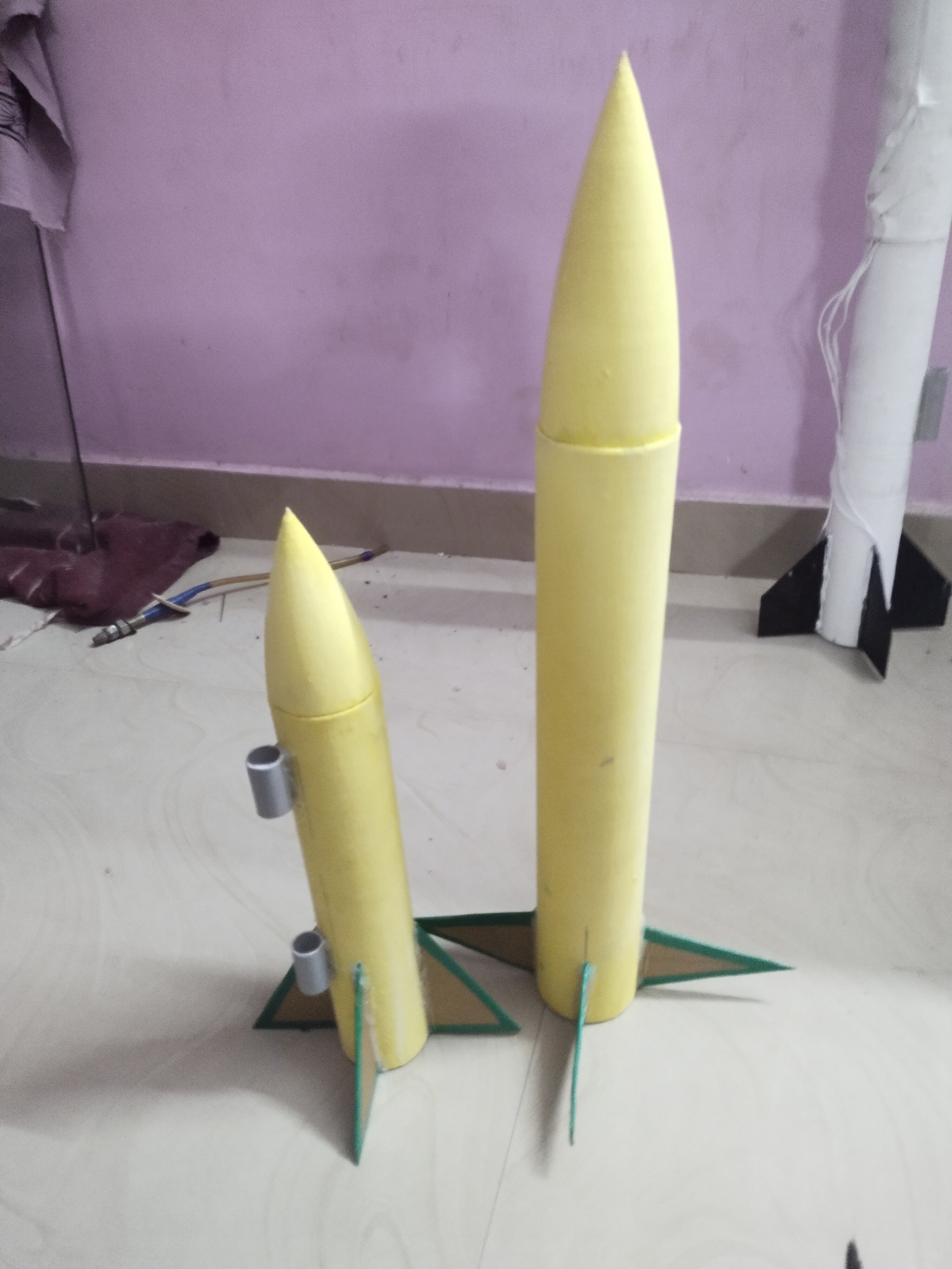

    Yellow Brothers was developed as a simpler test platform after the earlier rocket tests failed. The goal was to test a basic rocket configuration with fewer systems, understand real-flight behavior, and improve the design step by step before adding more complex recovery or electronics systems.
    Development
    The rocket was built using a simple cardboard body tube, basic fins, a nose cone, a motor mount and it uses dry fuel motor. The design was intentionally kept lightweight and simple so that I could focus on the motor performance, launch stability, and structural reliability.

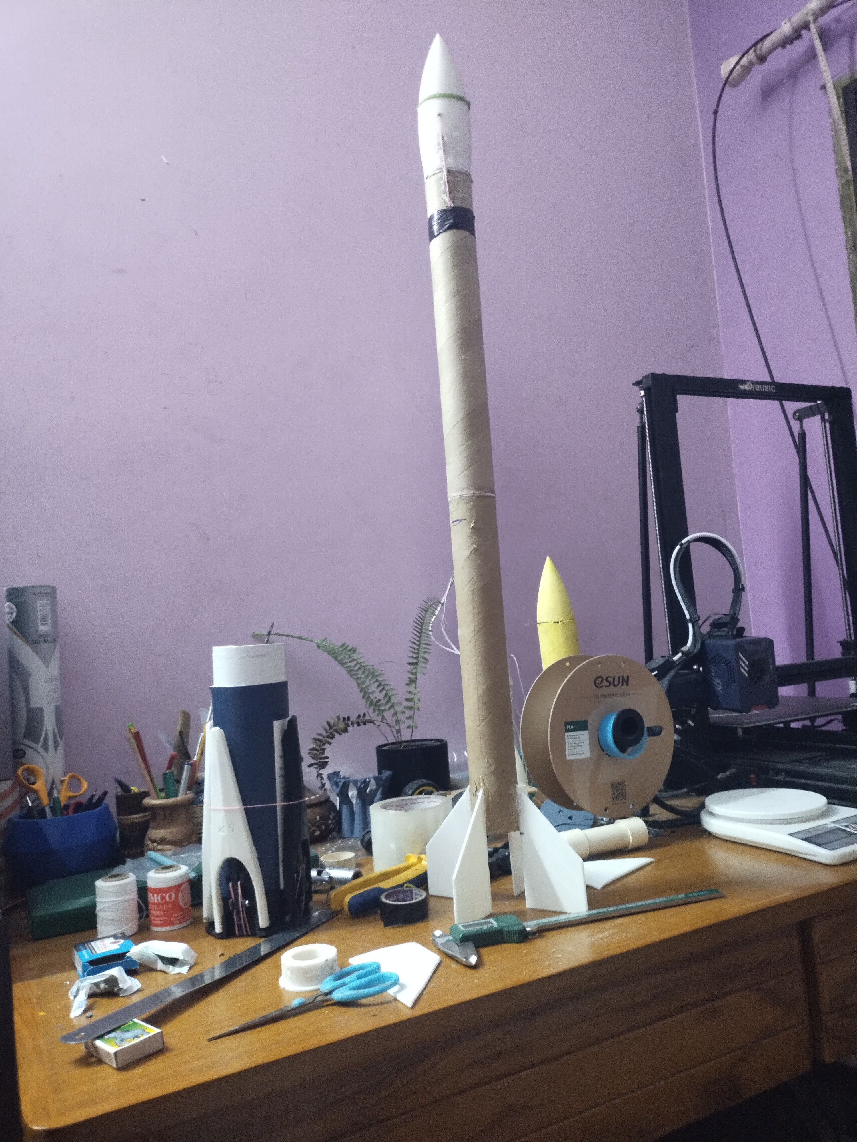

    Dragon Airframe Design and Construction
    Dragon’s body consists of two 65 mm diameter cardboard shuttle tubes joined with 3D-printed couplers. The nose cone is also 3D printed.

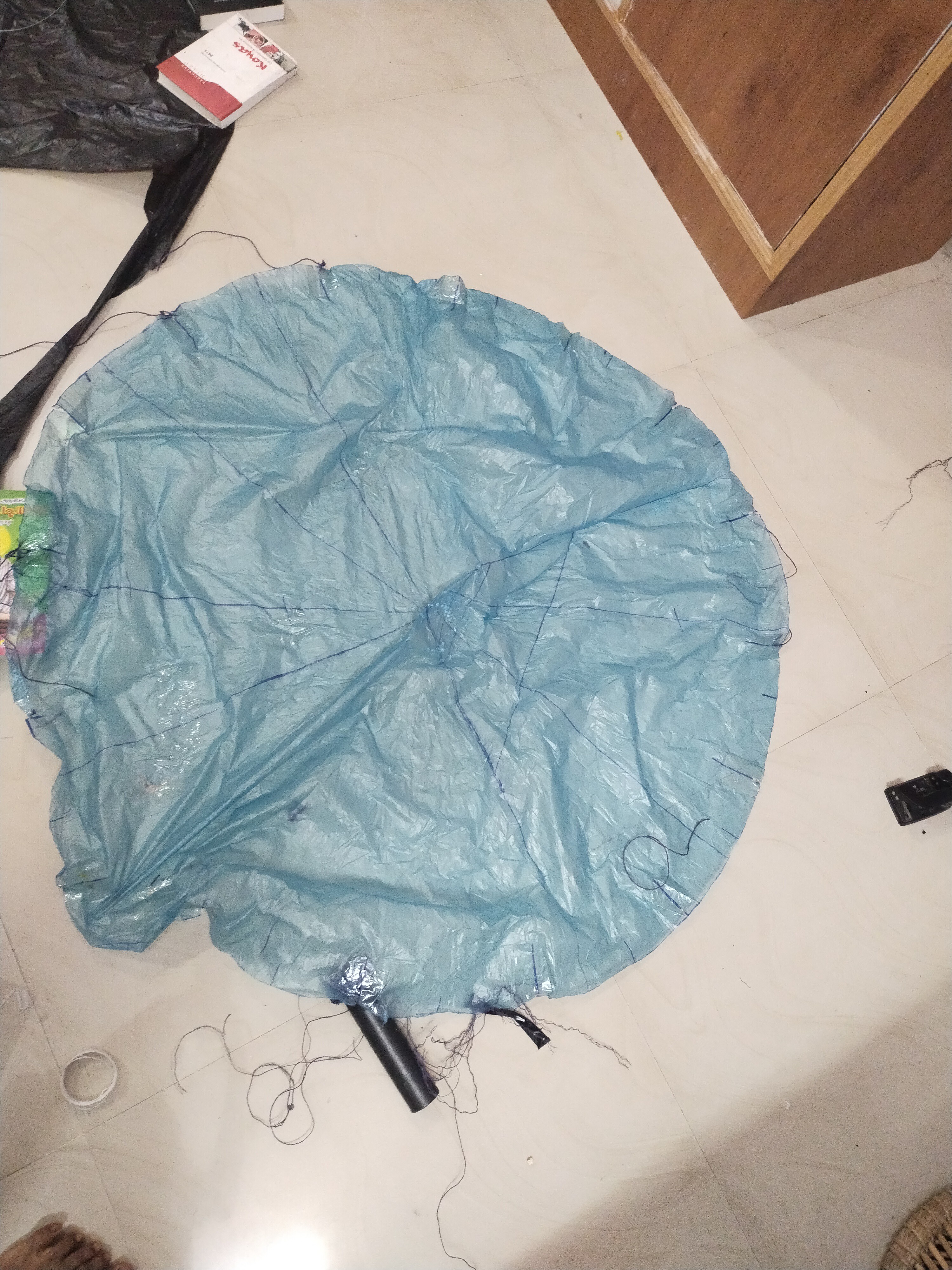

    Parachute Development
    To keep the design inexpensive and lightweight, I used plastic garbage bags as the parachute material and nylon thread as the suspension lines to maintain its shape.
     Parachute Testing
    To check the parachute’s reliability, I attached a weight equivalent to the rocket’s mass and tested it several times. The parachute deployed properly, slowed the descent effectively, and landed safely. Even after multiple tests, the low-cost plastic material held up well.

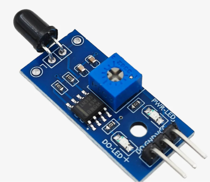

    I chose an unusual method for the parachute deployment system. I used four flame-sensor modules placed around the motor, facing the exhaust, to detect ignition. The system also included a pyrotechnic deployment charge with an electric igniter, controlled by a relay and an Arduino.
    At that time, I was unaware of the risks of using a relay in a rocket. Strong vibration or shock during flight could potentially trigger the relay unintentionally.
    The code logic was simple: when any flame sensor detected the motor exhaust, the system recognized that ignition had occurred. When none of the sensors detected flame anymore, the system identified motor burnout and triggered the deployment charge to release the parachute.

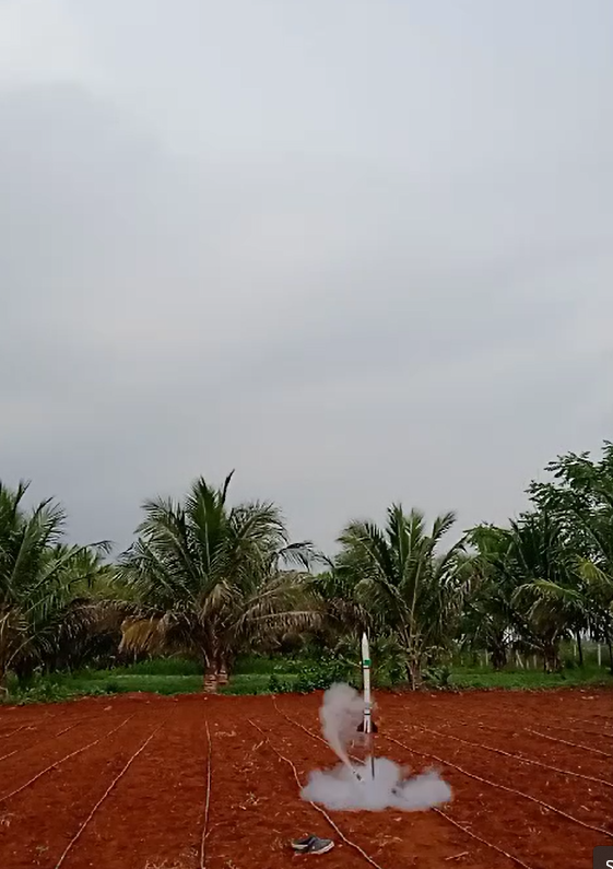

    Dragon Flight Test 1
    The rail guides were not secured properly to the rocket. During liftoff, the rocket became stuck on the launch rail, and the motor broke the motor mount and came out of the rocket.

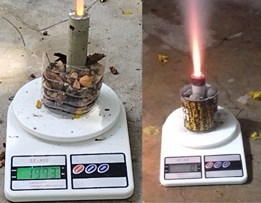

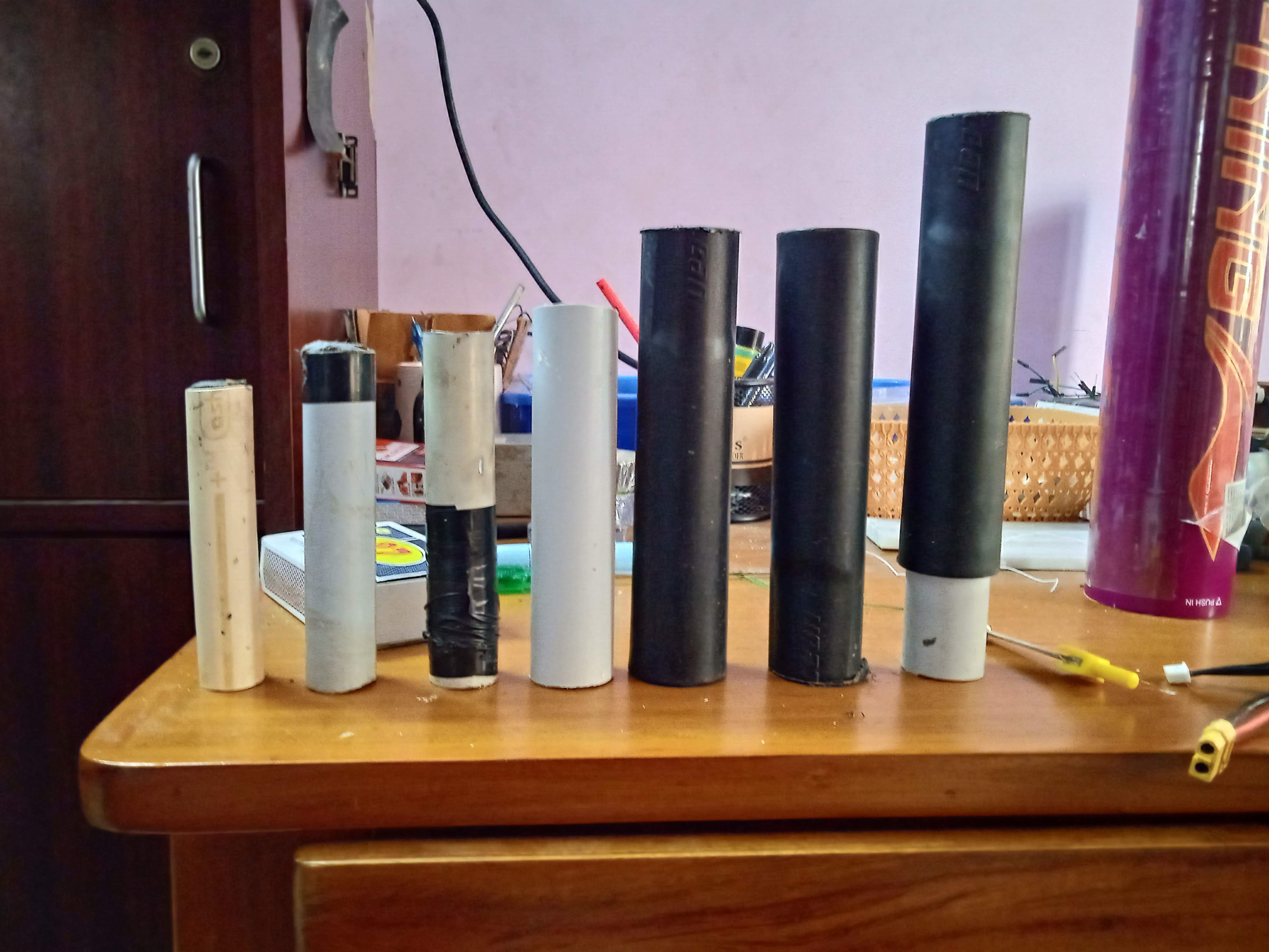

  • Testing Different Solid Rocket Motors and Measuring Thrust
    kruthick jothimani06/27/2026 at 14:21 0 comments
    Goal
    The goal of this test is to try different casing materials and, unlike the previous test, measure how much thrust the motor produces.
    Fuel casting
    The same method as before was used to cast the fuel. A 65/35 fuel mixture was used, and the fuel and oxidizer were finely ground before being tightly packed into the casing.
    Test Setup
    A weight scale was used to measure the thrust, and the readings were recorded using a phone camera. A load cell could also have been used to log the thrust more accurately, but since only an approximate thrust value was needed for this test, I chose this simpler approach.
    Results
    Materials such as uPVC could not withstand the heat and deformed after the test. CPVC performed much better, making it more suitable for this application.
    The thrust measurements showed that the motor generated approximately 30 N of peak thrust, with a burn time of about 3 seconds.

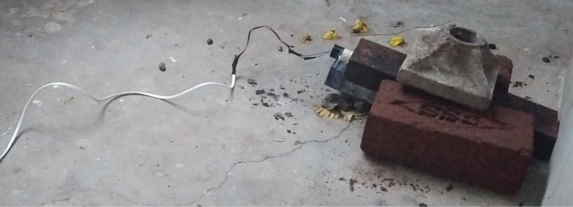

  • First Attempt at Building a Solid Rocket Motor
    kruthick jothimani06/19/2026 at 05:05 0 comments
    Goal
    To see weather a homemade solidmotor can ingnight and burn
    What I Built
    • Motor casing: 18 mm ID CPVC tube
    • Propellant: KNO₃ + sugar
    • Nozzle throat: 4 mm
    Motor
    To keep the design simple, I chose a basic grain geometry: a solid cylinder with a central bore hole. The nozzle was simply a washer with a 4 mm hole.

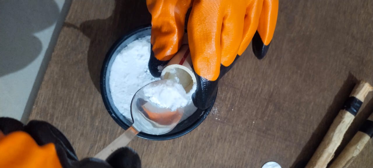

    Fuel Casting
                                                                                                                  The fuel mixture contained 65% KNO₃ (oxidizer) and 35% sugar (fuel). Both components were separately ground into fine powders, blended, and compacted into the casing to increase the packing density. Finally, the central bore hole was slowly made by hand using a drill bit.
    Test Setup
    Result
    The motor ignited successfully and produced flame with lot of sound.
    The thrust is not messured, but this test confirmed that the casing, igniter, and nozzle design worked.
