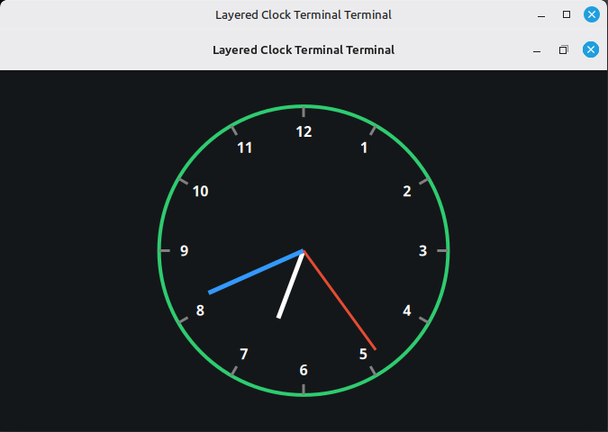

I asked Google AI for some starter code, drawing a clock. There is a program on Sun Workstations called xclock which does this.
I was pleasantly surprised that it did so, and worked almost immediately. There are some commands to set up the communications, the windows server, and the clock client, in that order.
I requested hour numbers and they went on with no problems.

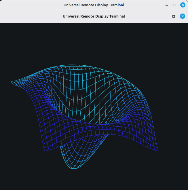

That was very quick work, so I decided to give it a bigger challenge, drawing a 3-D surface.
This took a bit more time, for various reasons.
  • The virtual serial ports have virtually zero latency time. So either side can quickly fill up the other side's communication buffers and end up waiting forever for the other side to service a crashed buffer.
    The solution to this is to have a 'ping' type function to check the other side is ready to receive. Not for every character, but for maybe a line at a time.
  • The AI was adding commands to the command handler that were not in the standard X-Windows command set. This can be used to reduce comms traffic, e.g. by sending one command to draw a quadrangle instead of four commands to draw the four lines.
    I wanted to have the server to be client-independent, just handling the common command set. I asked for this, and the program worked perfectly:
It is not very quick, but as an unexpected pleasant surprise it slowly rotates and is redrawn larger or smaller when the window is stretched.
