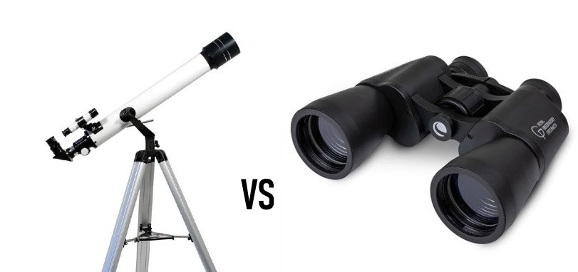

As an amateur astronomer, especially at the beginning, the most difficult part of observing the night sky was locating the desired object, regardless of whether it was a bright object (such as a star or a planet) or, even more difficult, a Messier object. I often spent a lot of time searching for an object. First of all, I want to advise anyone who wants to start this hobby not to repeat the mistake that more than 90% of people make. Most often, the first choice is a Refractor type of telescope, which is practically unusable for this purpose. Almost as a rule, such telescopes from a lower price class (which is a logical choice for a beginner) have terrible characteristics, starting from poor and unstable mounting to extremely poor-quality optics.
The best beginner's choice, I can confidently say, is an average pair of binoculars in a price class similar to a Refractor telescope. Most often, binoculars have incomparably better optics, are easy to handle, do not require a stable mount to begin with, and have a wide field of view. It's enough to point it at the Moon for the first time, and you'll probably be constantly looking forward to clear nights and exploring the incredibly interesting night sky.

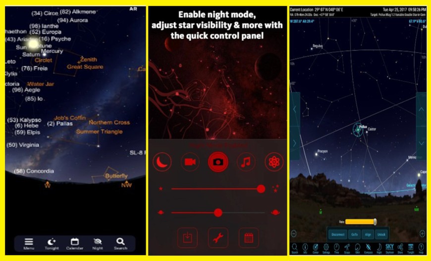

Let's go back to the initial problem: locating the desired object. Nowadays, there are many smartphone programs for this purpose, among which the most famous are Stellarium, SkySafari, SkyView, and all of them use your phone's camera, GPS, and gyroscope to map the night sky in real time. Although they are very helpful, they are not precise enough to quickly locate an object with a telescope or binoculars, considering that these optical devices have a relatively small angle of view.

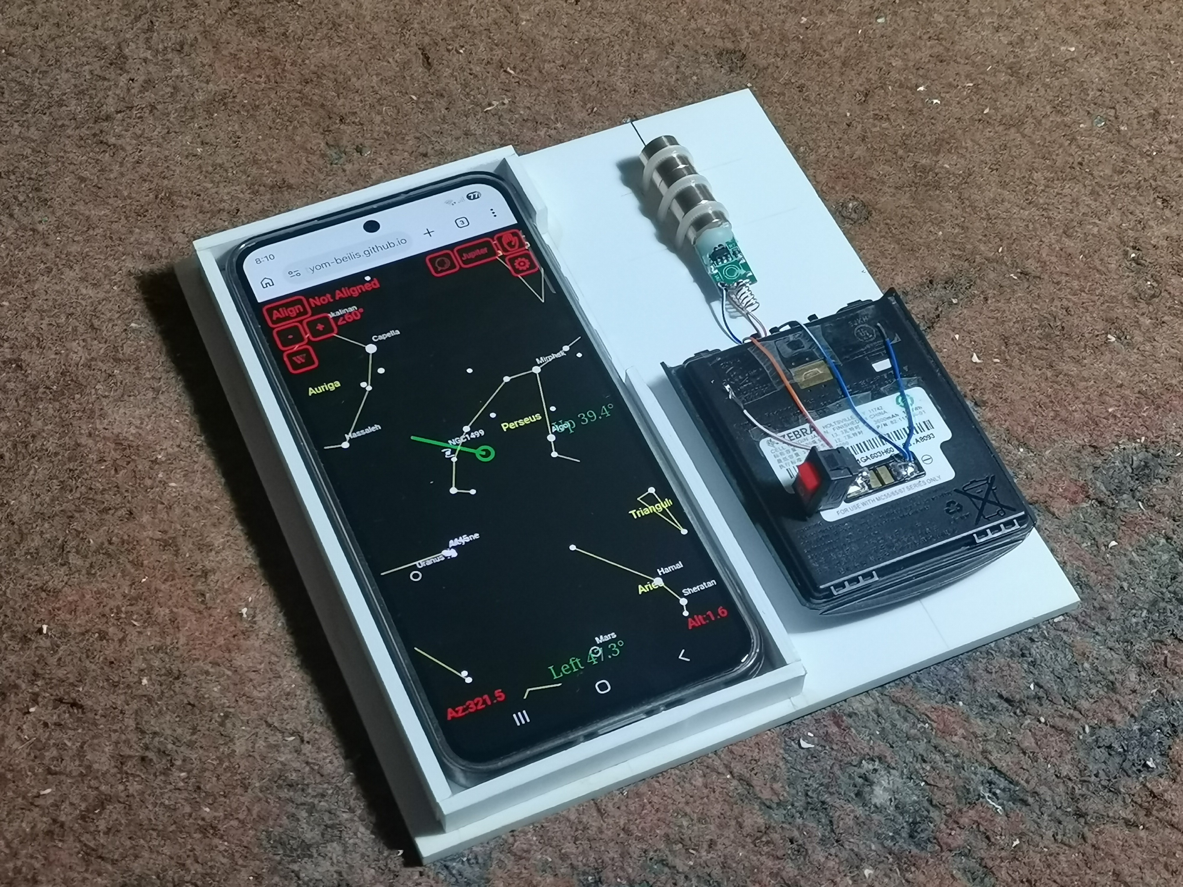

With the method I will show you below, you will be able to locate an object in the sky with such precision that you will be able to find any object in no more than 20-30 seconds. It sounds incredible, but even more incredible is the fact that the entire equipment would cost you less than ten dollars. You need a small green laser pointer, a lithium-ion battery and a suitable holder for the laser, battery and Smartphone. I made the holder from PVC material, but it can be made from any other material that you have on hand, just it should not be iron, because it affects the smartphone sensors and the pointing will not be accurate. The first condition is that the laser pointer and the smartphone are in the same horizontal plane, which is observed because they are mounted on the same flat plate, and the second condition is that they are placed parallel along the vertical axis. There may be certain minimal deviations that would later be compensated for by calibrating the option in the software. On the underside I attached a suitable shape that fits my tripod mount.

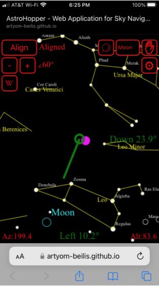

As for the software, it is "AstroHopper" which is basically a web application and does not have to be installed, but if you want you can download it for offline use. It is enough to type astrohopper in any search engine on your phone and the first search takes you to GitHub and the online application appears. It seems to be the same as similar applications, but there is one option that makes it much more useful for such purposes, and that is the Align button that serves for calibration.
