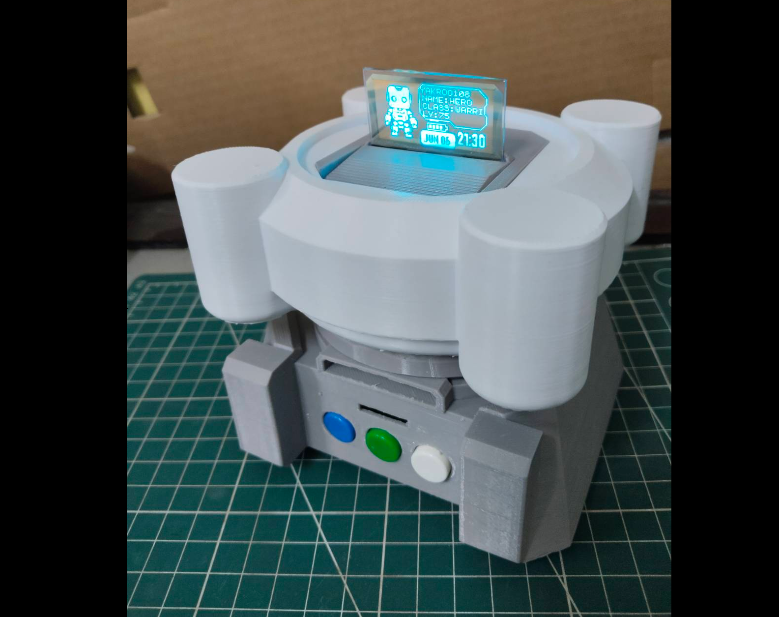

The goal of this build was to create a unique desktop clock inspired by the holographic interfaces often seen in science-fiction movies and cyberpunk video games. Instead of using a conventional display enclosed inside a box, I wanted the graphics to appear as if they were floating above a futuristic control terminal.

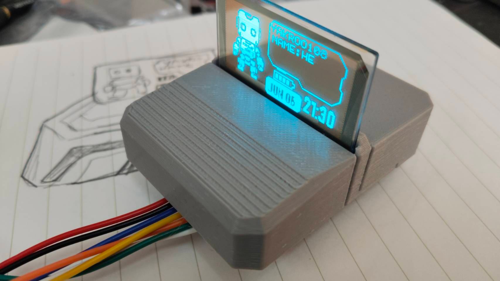

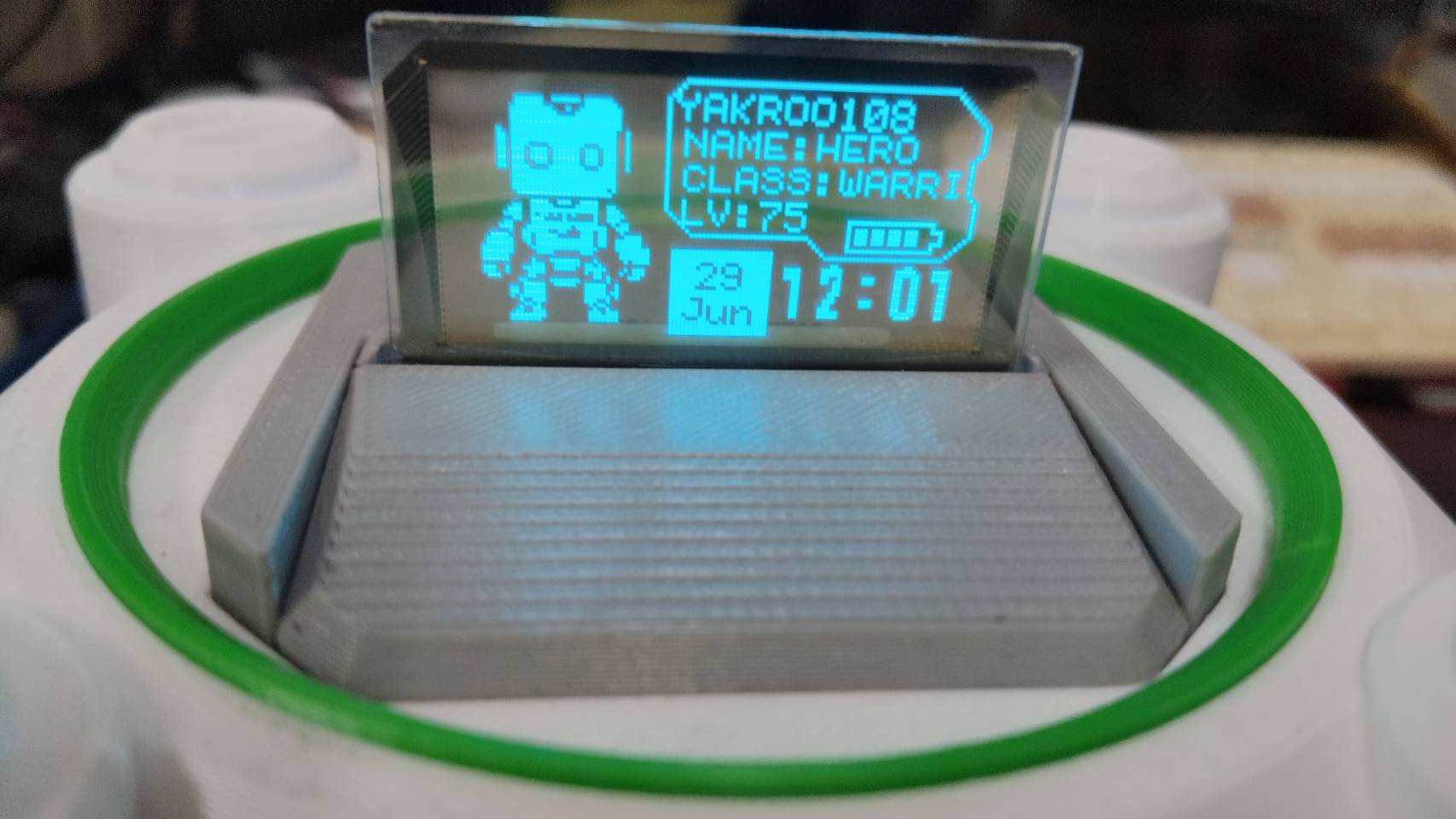

The result is a battery-powered cyberpunk holographic terminal clock built around the RP2350. The device combines a transparent display, animated robot graphics, real-time clock functionality, scrolling text messages, and a custom-designed sci-fi enclosure to create a futuristic desktop accessory.

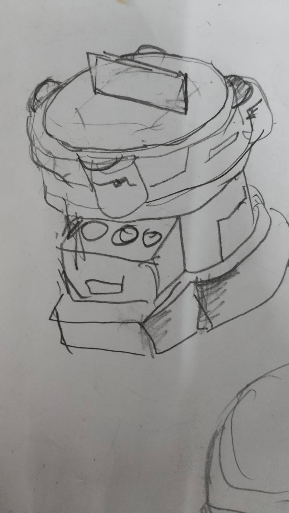

Design Inspiration
The enclosure design was inspired by futuristic AI control terminals, holographic command consoles, and cyberpunk technology often seen in science-fiction media.
Rather than building just another digital clock, the goal was to create a device that feels like a miniature command terminal sitting on a desk, continuously displaying information through a holographic-style interface.

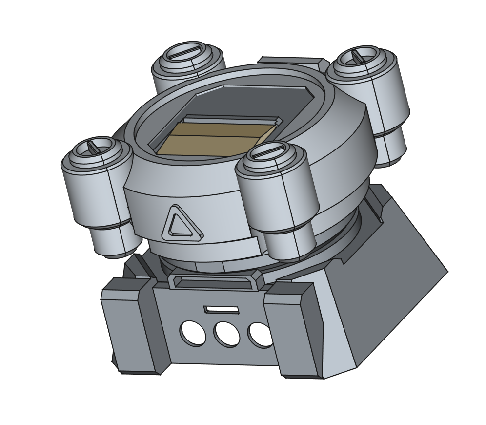

CAD & 3D Model
https://github.com/YakrooThai/Contests/tree/main/Instructables/Cyber_Holographic
https://www.printables.com/model/1775694-cyberpunk-holographic-terminal-clock

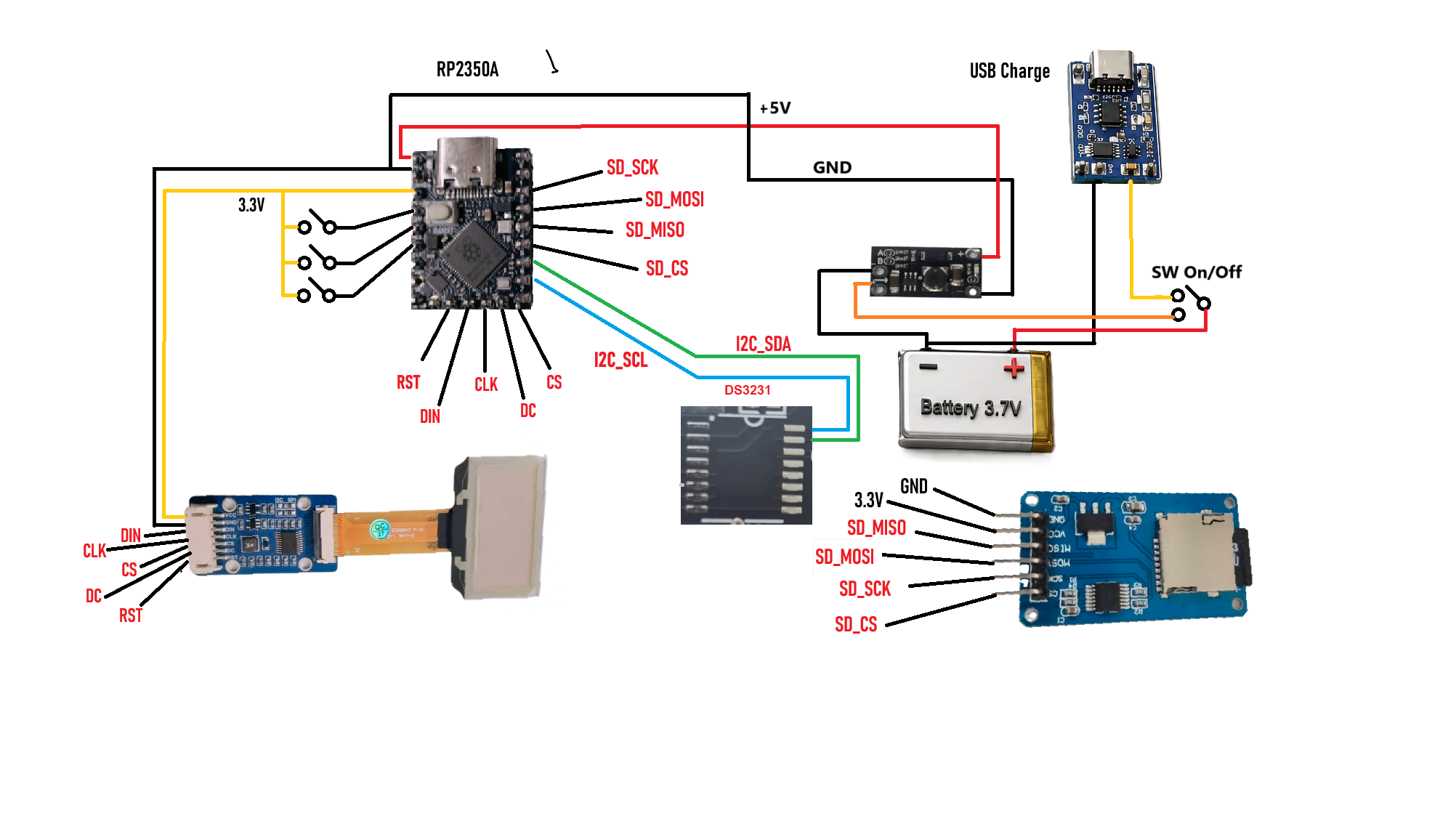

CIRCUIT:

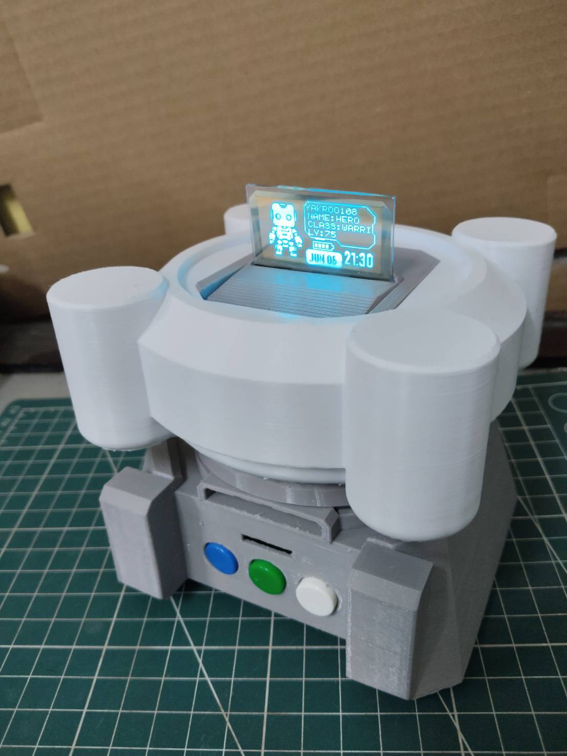

Cyberpunk GUI Interface:
