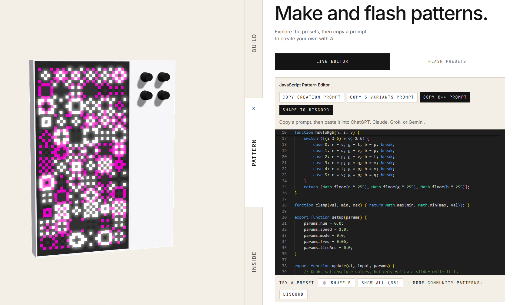

The browser-based Pattern Live Simulator runs the same four knobs the physical device has. Find something you like, and if you've got hardware on hand, flash it straight from the browser over Web Serial — no IDE, no drivers.
