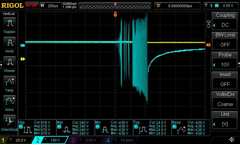

The demo: hunting a bare-coil flyback
The best way to show a tool works is to do real work with it, so I ran a live inductive-kickback experiment and let the agent drive the scope the whole way. The setup: a 24 V relay coil with the freewheel diode removed — a bare inductor. Two 10x probes straddling the disconnect, CH1 on the supply side, CH2 on the coil side. The plan: break the circuit and catch the unclamped kick on a single-shot.
What actually happened is the fun part, because it's exactly the fiddly loop a human hates:
- Characterized both channels — confirmed ~24 V DC on each, then noticed CH1's trace had "vanished." It hadn't: both channels sat at the same voltage with identical settings, so the traces overlapped pixel-for-pixel. Nudged the display offsets apart and there they both were.
- Chased down noise — ~6 Vpp of hash on the rail. An FFT showed the energy piling up at the Nyquist edge no matter how fast we sampled: the tell-tale of high-frequency switch-mode-supply ripple aliasing into a slow, fake wander. A 100 nF cap across the supply knocked it down ~5x.
- Got the disconnect right — pulling from the minus side of the bulk caps took the capacitance out of the loop, so the collapsing field had nothing to absorb it and rang free.
- Cleared the clipping — the first single-shots railed the window: the kick blew past ±130 V, then −304 V. Step the vertical coarser... 50 V/div, still clipping... 100 V/div — there it is.
The payoff: an unclamped −436 V spike with a +240 V positive overshoot — a ~676 Vpp ring off a 24 V rail, roughly 18× the supply, then an exponential bleed-back over ~1 ms. For contrast, with the freewheel diode installed, the same coil clamps to a tidy ~24.7 V. That's the whole point of the diode in one screen.
