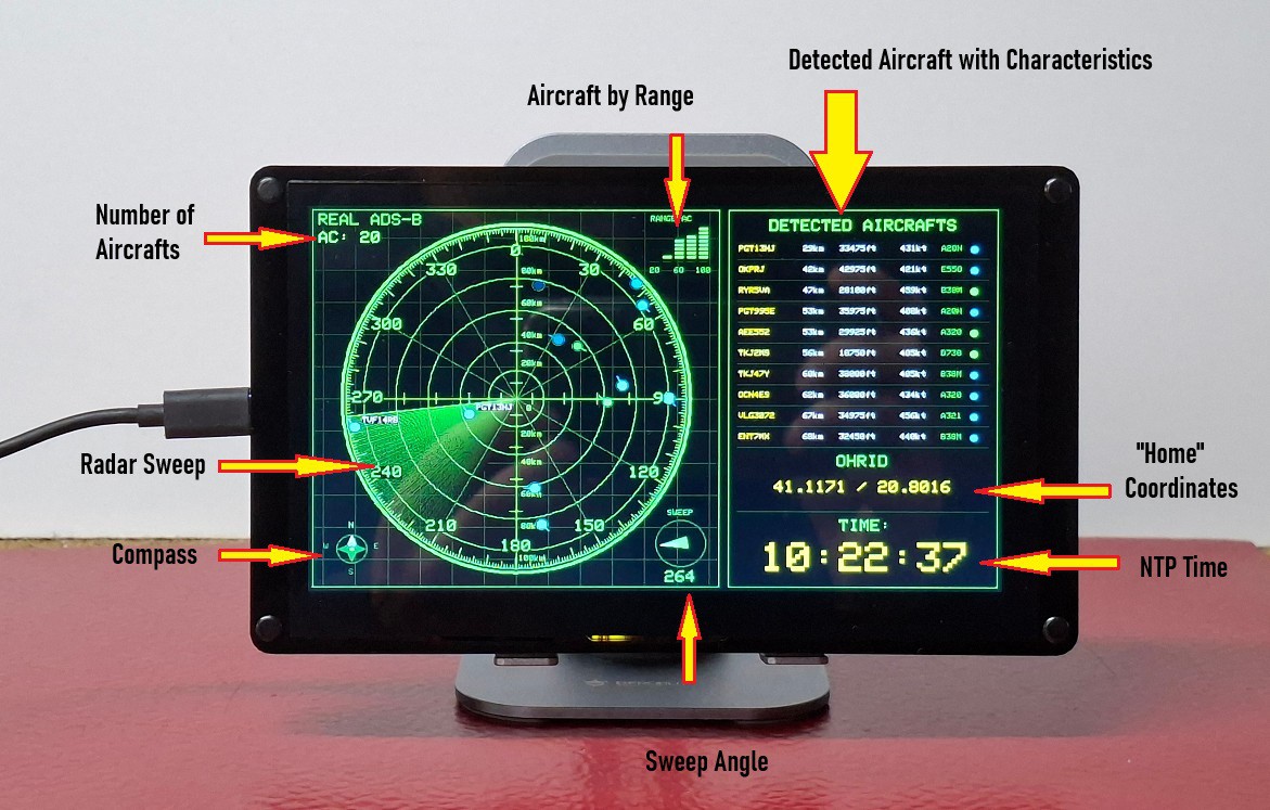

 In this project, I built a fully functional real-time aircraft tracking radar using an ESP32-based 7" HMI display. The system visualizes live air traffic data with a smooth rotating radar sweep, just like professional radar systems. ADS-B signals are collected via free online APIs and displayed on the radar in real time. So we only need WiFi connection and internet.

  Each aircraft appears on the radar only when the rotating sweep line passes over it, creating an authentic radar effect. The detected aircraft are also listed on the right panel, sorted by distance.

  As for the code, we first need to enter the Wi-Fi credentials and the coordinates of the home position (latitude and longitude). We can also change a few parameters, such as colors and shades, then sweep speed, maximum number of detected aircraft, and more.
 Now let's move on to the most interesting part, that is, to turn on the device and describe the way it works and the options. After connecting to the network, the radar display appears immediately. In the upper left corner is shown the number of currently detected aircraft at a distance of 100km from the home position. In the lower left is a small compass showing the cardinal points, in the lower right the current sweep position visually and in degrees, and in the upper right corner the number of aircraft in each ring: 20, 40, 60, 80 and 100 km.
   Centrally we have Smooth rotating radar sweep with fade effect. Each aircraft appears on the radar only when the rotating sweep line passes over it, creating an authentic radar effect. The detected aircraft are also listed on the right panel, sorted by distance.

  It can be noted that in the northwestern region, at a distance of about 100 km from the home position, we often have aircraft at very low altitudes. The reason for this is that the nearest airport (Tirana) is located exactly in that place, where planes often take off and land. The status is updated every 360 degrees, which is approximately 15 seconds, but this time can be shortened to 1 second. The update moment is indicated in the upper left corner.
 On the right side of the display we have more information. At the bottom in large numbers is shown live local time with NTP synchronization and above it the Home position with the given coordinates latitude and longitude and the name of the place. At the top is information about the ten closest detected aircraft. For each aircraft individually more information is given:
- callsign,
- distance from home position,
- moving speed,
- flying altitude,
- as well as the aircraft type.
 On the far right is a circle with the appropriate color depending on the altitude.
