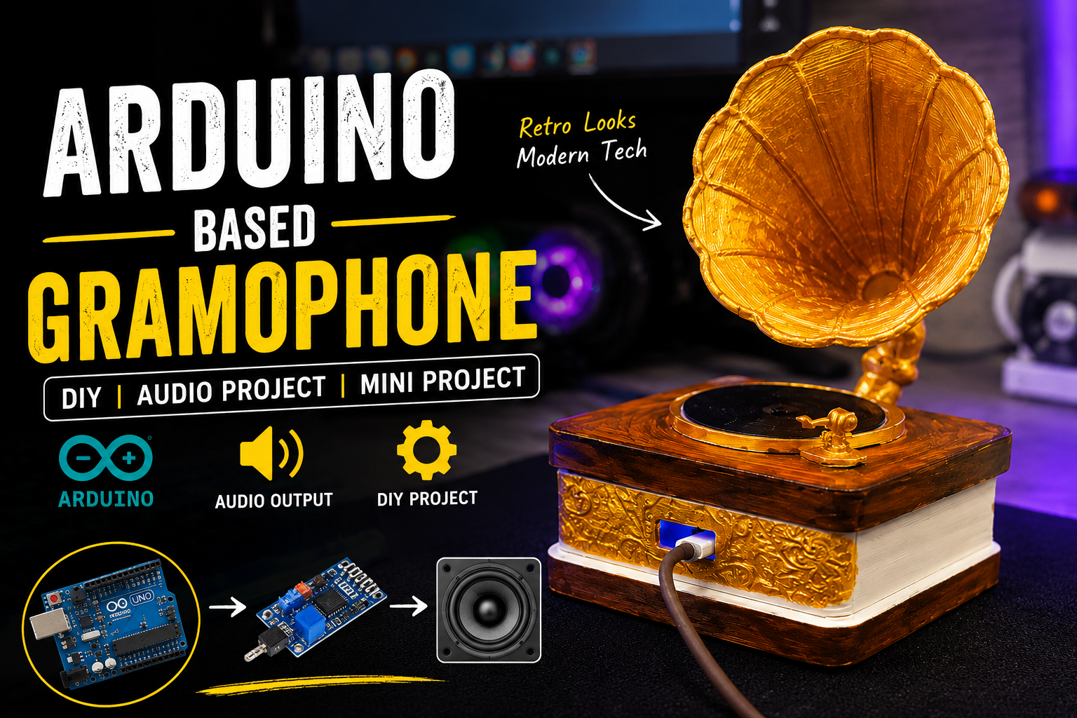

Every smart speaker on the market looks like it cam from the same design meeting: a cylinder, a mesh grille, a glowing ring. I wanted to build something you'd glance at and assume was decorative, until you noticed the faint hum of music coming from inside a hand-painted brass horn.
That's the project: a miniature gramophone, built from scratch, with a real Arduino UNO R4 WiFi and a DFRobot MP3 Player module hidden inside the base, driving a pair of cavity speakers tucked into the horn itself.

Getting clean sound out of a horn that wasn't engineered for acoustics took several iterations of speaker placement — too deep into the horn's throat and the sound choked; too shallow and most of the horn's amplifying effect was wasted. The sweet spot ended up being just past the narrowest point of the throat, angled slightly toward the bell.
Heat management was a smaller but real concern — the Arduino and module sit in a fully enclosed wooden/foam base with no ventilation by default, so I added a small hidden vent in the base trim to avoid any heat buildup during longer play sessions.
