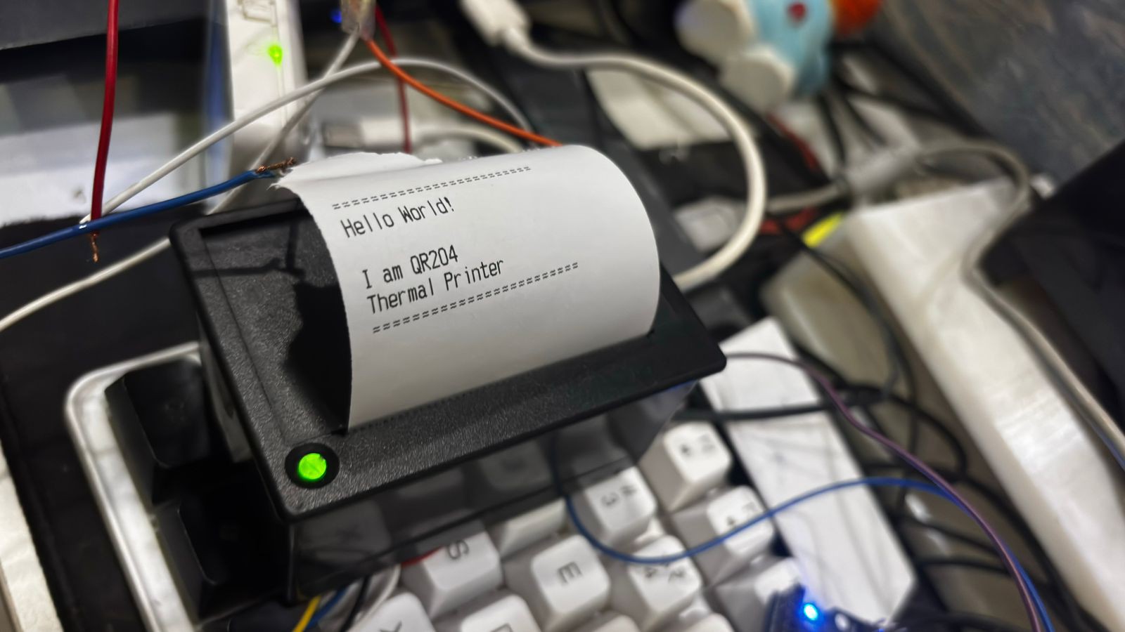

Whenever the on-screen Print button is pressed, the ESP32 sends text to the thermal printer over a UART serial connection. The printer immediately prints:
Hello World!I am QR204Thermal Printer
