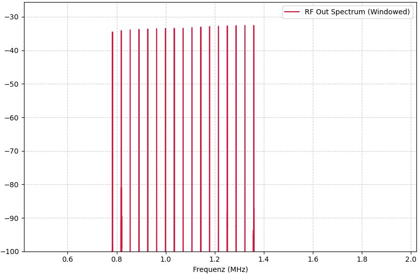

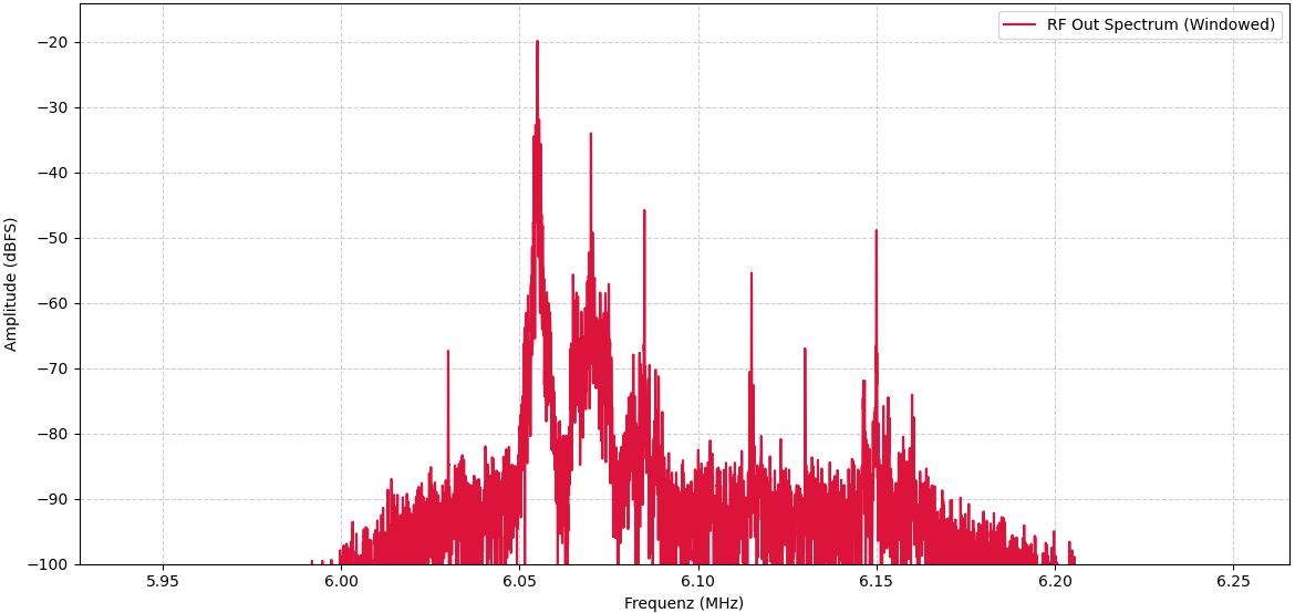

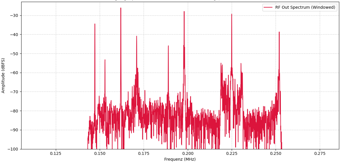

4. It's Not Just Simulated — It's Verified Against Real Broadcast Recordings
A design is only as credible as its verification story, and this is where the project distinguishes itself from a typical "here's some Verilog, trust me" repository. The gateware ships with a cycle-accurate Verilator testbench (sim_main.cpp) that:
- Programmatically emulates the in-band command host driver via
--rateand--shiftcommand-line flags, exercising the parser's state machine the same way real host software would. - Supports a passthrough mode (
--passthrough) that feeds pre-recorded binary I/Q captures (testbench_passthrough_ci16.iq) — generated from real recordings via acohi_wav_to_smi_iq.pyconversion utility or exported straight from GNU Radio — bit-for-bit into the simulated hardware pipeline. This closes the loop between "software tool produces bytes" and "hardware consumes those exact bytes correctly," which is precisely the kind of integration bug that pure unit-level RTL testing tends to miss. - Verifies the glitch-filter behavior under realistic strobe timing by tracking the clock-to-sample-rate ratio and asserting
data_enfor a fixed run of 5 continuous cycles. - Caps
.vcdwaveform dumps to the first 100,000 cycles — a small but telling piece of engineering hygiene that keeps long signal-sweep simulations from generating multi-gigabyte trace files.
The headline result of that verification effort is a set of spectral captures sourced from the Cohiradia archive of historical and live broadcast recordings, run through the DUC at all three supported input rates:
- Mediumwave (1.25 Msps): A dense synthetic 17-carrier AM broadcast band (783 kHz through 1359 kHz, spanning vintage German and dance-music and news recordings) shows sharp, symmetric carriers with no visible central LO spike — direct visual confirmation that the NCO/mixer combination achieves clean carrier suppression under a genuinely crowded multi-signal load.
- Longwave: Real captures of actual LW broadcasters — DDH47 meteo/FSK from Pinneberg, France's TDF time signal on 162 kHz, BBC Radio 4 on 198 kHz, and others
- 49 m shortwave: Genuine ionospheric shortwave signals
Using historical broadcast material rather than synthetic single-tone test signals is a smart verification choice: single tones flatter almost any DUC design, while a crowded, high-PAPR real-world band is where rounding errors, CIC droop, and LO leakage actually show up.
