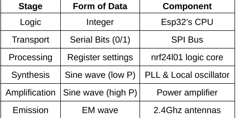

5) Data-Pipeline:
... Read more »

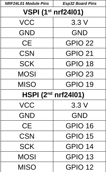

    Make Connections
    Follow the Pinouts table to make connections:
