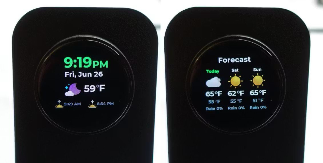

  • Clock/Weather: When the skies are empty, FlightScnr transitions into a desk dashboard showing a digital clock, live current weather, and a 3-day forecast.

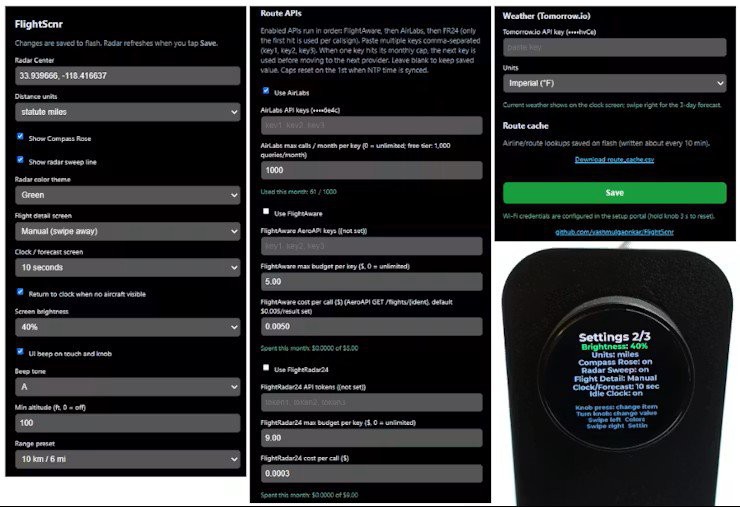

  • Customization: You can adjust settings directly on the device via the settings menu, or via the locally hosted web portal to configure your API keys, set distance units or set the color theme without ever needing to re-flash the board.

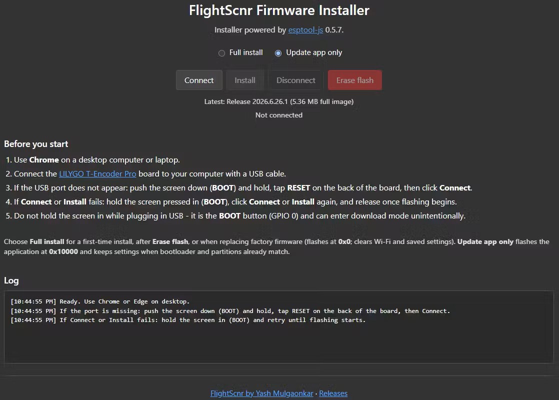

I wanted the deployment process to be as frictionless as possible. Whether you want a plug-and-play experience or want to dig into the code, you have options.
  • The Quick Way (Browserbased WebFlasher): You do not need to install an IDE or compile anything. Plug the T-Encoder Pro into your computer, open Google Chrome, and navigate to the FlightScnr WebFlasher. Hit "Connect, " select your device, and click "Install." The pre-compiled binary will load directly onto your board.Be sure to select "Full Install" if you are installing the software for the first time.
  • Building from Source(PlatformIO): For those who want to tweak the source code, clone the repository and hack away! The firmware is smart enough to auto-detect whether you have the older DXQ120 or the newer TFD12 display panel on boot, meaning one binary handles both hardware variants.
Once the board reboots, use your phone or laptop to connect to the FlightScnr-AP captive portal to input your home Wi-Fi credentials. Finally, load up the local web interface to drop in your free API keys (for weather data, routes, and airline logos) so the device can pull in all that rich information. Available options include AirLabs, FlightRadar24, FlightAware's Aero API and Tomorrow.io.
