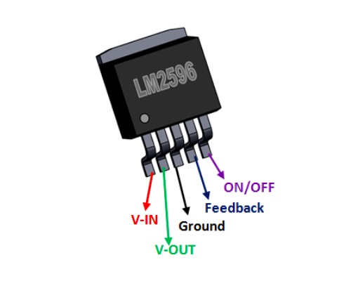

LM2596 Pinout
The LM2596 IC consists of five primary pins:
VIN – Input Voltage
OUTPUT – Switching Output
GND – Ground
Feedback (FB) – Voltage Regulation
ON/OFF – Enable or Disable the Regulator
On ready-made modules, the terminals are typically labeled:
IN+
IN-
OUT+
OUT-

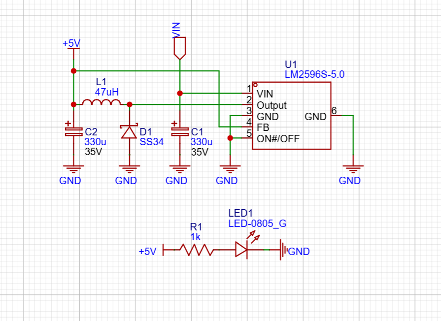

Circuit Diagram
The circuit shown is a 5V fixed-output buck converter based on the LM2596S-5.0 switching voltage regulator, designed to efficiently convert a higher DC input voltage (typically 7V to 40V) into a stable 5V DC output. The input voltage is applied to the VIN terminal, where the 330 µF input capacitor (C1) filters noise and voltage fluctuations before supplying power to the LM2596 IC. Inside the regulator, an internal high-speed switching transistor operates at approximately 150 kHz, rapidly switching the input voltage on and off. The 47 µH inductor (L1) stores energy during the ON cycle and releases it during the OFF cycle, while the SS34 Schottky diode (D1) provides a current path when the internal switch is off, ensuring continuous current flow and improving overall efficiency.
The output stage consists of a 330 µF capacitor (C2) that smooths the switching pulses into a clean and stable 5V output with minimal ripple, making it suitable for powering microcontrollers, sensors, and other electronic devices. The ON/OFF pin of the LM2596 is connected to ground, keeping the regulator permanently enabled. Additionally,...
